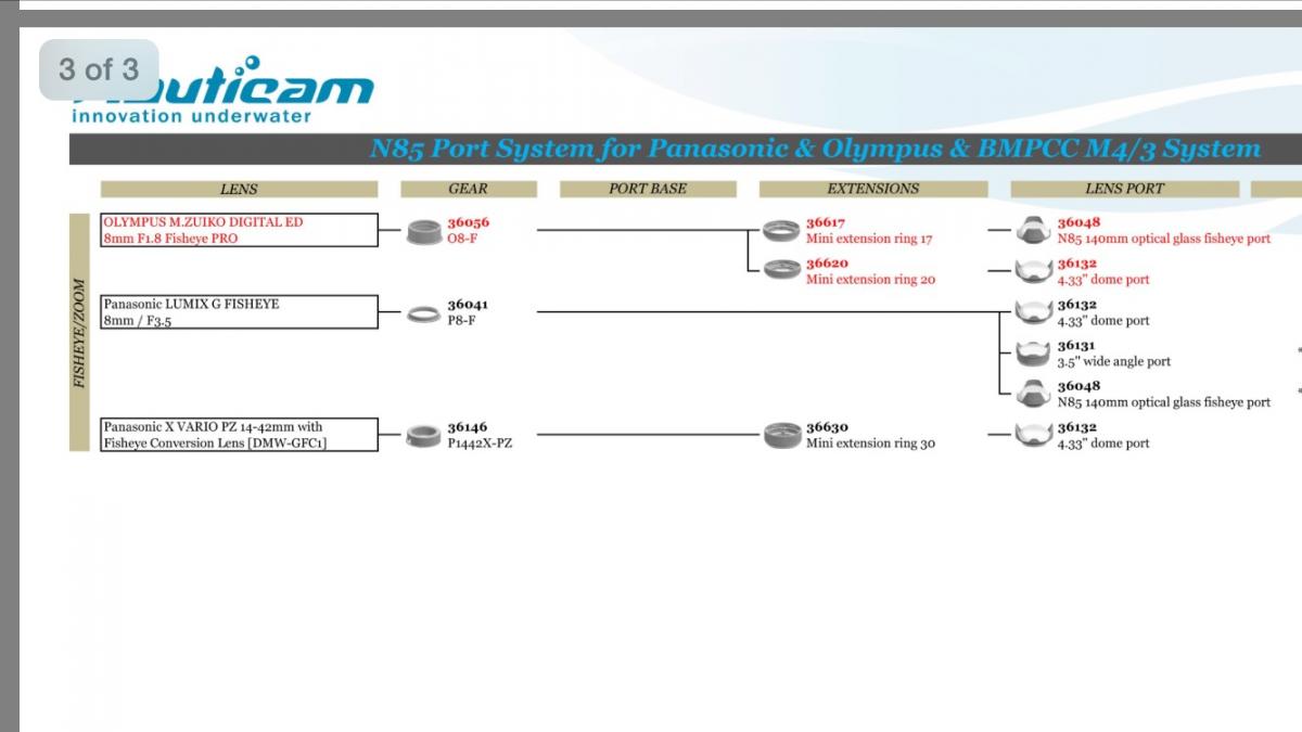

  5. so it is not possible, to use the Oly 7-14mm and the Oly fisheye in with the same port?
  6. Nope. The same deal as for the Pana 7-14 and 8 mm fisheye.

  17. I've published a Port Configuration Guide on our blog that has all of the various possible combinations for Nauticam and Olympus housings with Zen, Nauticam and Olympus ports, extensions and gears.
    There's a lot of different configurations. Right now, there's not a one size-fits-all like with DSLRs. The optics on m4/3rds lenses and the large physical size of the Olys make it hard. But I think given some time the manufacturers will do the best they can to work towards that goal.
    Having shot the 8mm with the small Oly dome, I'd really like to try in with a larger 170mm dome and see how much less edge distortion it has.
