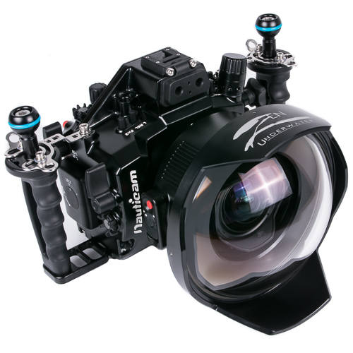

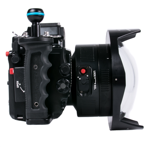

  7. Zen Underwater has confirmed the recommendation for the Olympus 7-14mm:
    Nauticam N85 to N120 60mm Port Adaptor, p/n 36204
    Nauticam Extension Ring 20 with Lock, p/n 21120
    Zen Underwater DP-170-N120
    Due to the large diameter of the lens, it's designed so that the 60mm port adaptor is attached to the housing first, then the lens, then the DP-170-N120 with the 20mm extension. I've attached some photos of this setup.

  9. Zen Underwater has confirmed the recommendation for the Olympus 7-14mm:
    Has anyone had this setup in the water yet? Is there an existing zoom gear for this setup now or is a new gear required? I am getting a bad case of GAS.
