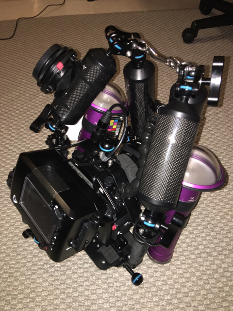

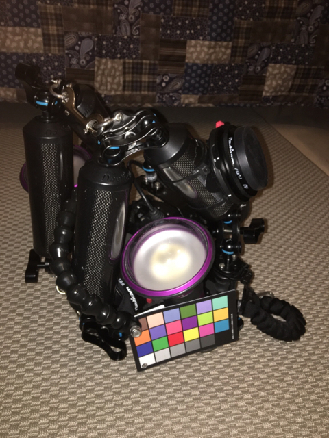

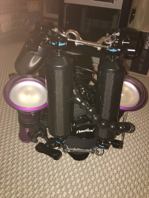

  1. I have two of the 200mmx90mm Nauticam carbon fiber arms to balance out my rig, which is a NA-EM10, 12-50mm lens and macro port, CMC-1 on a flip mount, two YS-D1s, a couple of focus/video lights, and tray/arms/clamps. I switched to the extra-long clamps between the float arms and the outer arms (also 200mm) so that they could collapse better for carrying. I use the shackle-clamps between the float arms and the tray balls, with a homemade braided paracord strap (with a clear plastic bit of PVC tubing over it) between the shackles for carrying. The damn thing is heavy out of the water!
  2. I have two of the 200mmx90mm Nauticam carbon fiber arms to balance out my rig, which is a NA-EM10, 12-50mm lens and macro port, CMC-1 on a flip mount, two YS-D1s, a couple of focus/video lights, and tray/arms/clamps. I switched to the extra-long clamps between the float arms and the outer arms (also 200mm) so that they could collapse better for carrying. I use the shackle-clamps between the float arms and the tray balls, with a homemade braided paracord strap (with a clear plastic bit of PVC tubing over it) between the shackles for carrying. The damn thing is heavy out of the water!
    Do you have a picture of the rig?
  3.
    Can you post a photo of the shackle clamps and 120mm bolt, and perhaps a link to where I can get them?
    Here you go.
