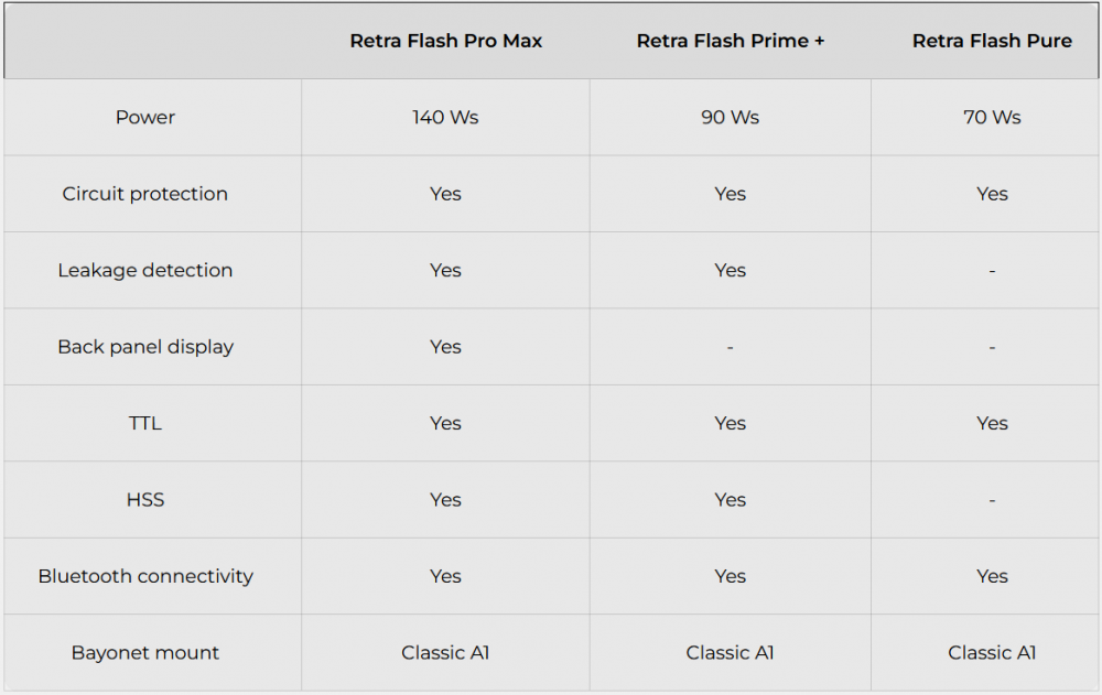

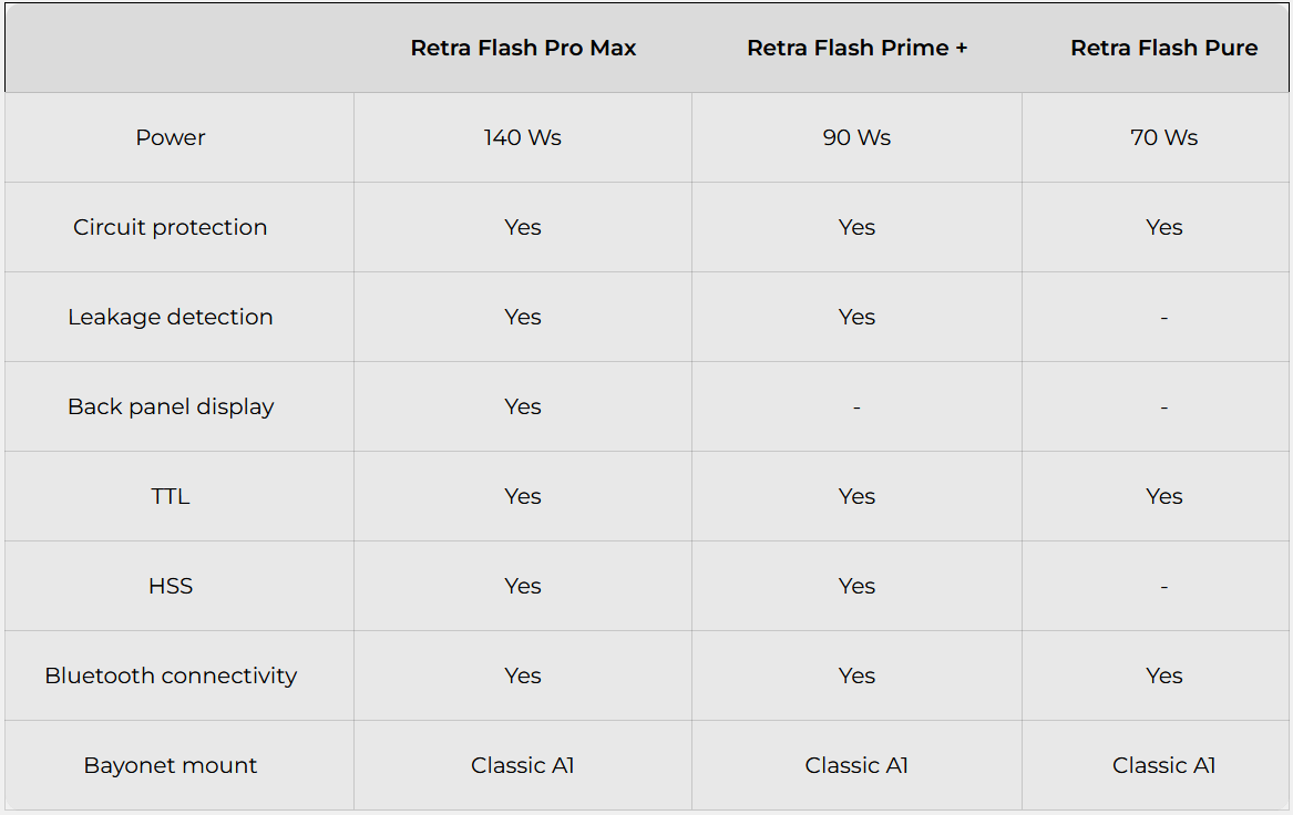

  8. Looks like the Retra Flash lineup is getting refreshed again, with three new models - Retra Flash Pro Max, Retra Flash Prime Plus, and a new, entry-level model, Retra Flash Pure.
    The Pro X and Prime X are now listed as out of stock.
    Odd that the new models are slightly weaker than their predecessors, although in practice I don't think the 10W/s difference is going to be noticeable. No pricing available yet, but maybe the Pure model will be roughly in line with Inon Z-330 replacement, whenever that comes out?
  9. My understanding is that the new Pro and Prime flashes have more efficient tubes and have been tuned to match the current ones, so that they can be used together seamlessly. Their efficiency means that they have a slightly lower Ws output for the same light.

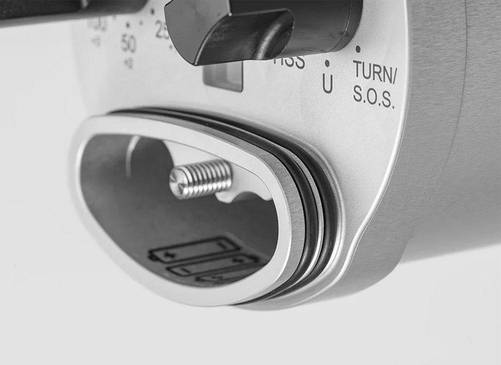

    It would be good to see what the battery compartment looks like open with and without 4 batteries. How easy is it to pull out batteries minding the need to keep water out?
  15. Hi Tom, thank you for your questions, I will answer below.
    The OLED display is a lot easier to read, especially in very bright sunny conditions when the LED is overpowered and on night dives when the power level dial is not illuminated. Battery status, mode, power level, recycle indicator are all clearly displayed (not at once) without the need to know which color represents what. The buzzer is still available as an alternative and can still be turned off.
    The battery compartment now has o-rings on the outside which means there is much less chance of getting water inside the compartment during battery exchanges compared to the previous design. Battery exchanges with 4xAA require the same procedure while the 8xAA configuration is now much easier to exchange since the batteries are stacked in one compartment instead of two separate ones.
  16. You case any of you haven’t looked, you can see how the the new redesign for the battery compart on both the new Pro Max + and Prime + is done here - https://www.retra-uwt.com/en-us/products/retra-flash-pro-max-power-pack-bundle
    I really like this approach for not only for both flash units can now utilize 8 AA in cleaner way, but also the battery compartment features a raise lip with the O-rings on the outside will make it less prone for water droplets to get down inside when the battery door is removed.
  17. Thanks Walt I missed that on the Retra site which looks like it was designed by entropy. I still have not found any delivery date info.
    The external o-ring design reminds me of S6 bulkheads. As well the new fixture bulges out slightly on the formerly straight side - this should provide some tension on the o-ring not present before.
