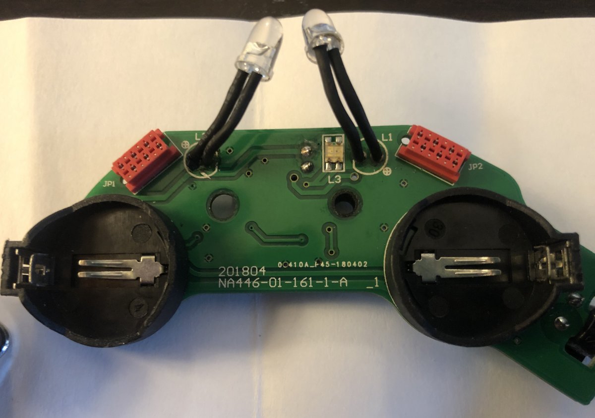

  15. I'd like to start using the High Speed Sync mode of the Retra Flash guns and I wanted to know if the strobe flash trigger in my Nauticam NA-D850 housing, pictured below, is compatible with HSS.  This version was standard when I purchased the housing in mid 2018.
    In any event, I plan to place the flash guns in HSS mode and increase shutter speed and see what happens.
    Any suggestions or advice would be appreciated.
  16. Others with more detailed knowledge will, I'm sure chip-in - but 2018 was pretty early days for HSS on the Retras. I'm not sure the strobes at that stage had HSS so the likelihood is that the trigger didn't either.
    That said, you can't go far wrong just by trying it.
    I've got a UWT board in my Subal housing that let's me use HSS on Retra ProX. It's a really great feature especially for those heavily backlight or sunball shots.
