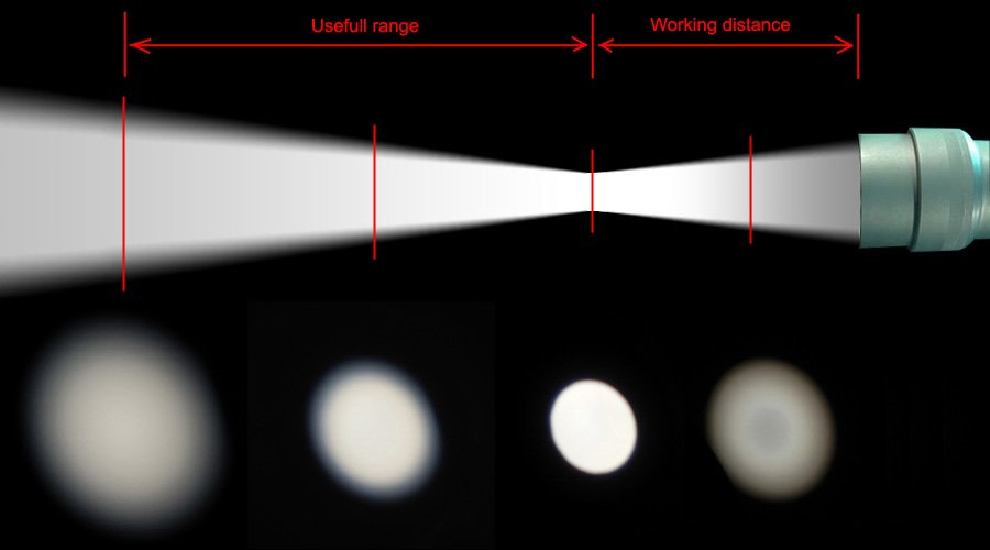

  10. On 7/28/2020 at 3:08 AM, Oskar@RetraUWT said:
    Roughly speaking somewhere around 6-25% power should be used for those settings depending on the mask you are using, actual distance from the subject, subject color, etc. The LSD Ultimate snoot has a focus distance of about 175mm in water. Moving the snoot farther will give a softer edge with even light distribution but when the snoot is positioned too close it will reduce the light output and a dark spot will form in the center. See image below. The square mask is great for finding the focus distance because the corners can be clearly seen as sharp when the LSD is in focus.
    Please note that smaller apertures on the mask also reduce the light output.
    The LSD Ultimate snoot for the Original Retra Flash has the same style bayonet mount and it can be mounted to the new Retra Flash PRO/Prime but optically it is not compatible and makes the effect above even worse. The difference is in the length and the diffuser: the Mounting module for the new Retra Flash is about 43mm long, for the Original Retra Flash it was about 33mm.
    Hi Oskar,
    I am new at using this snoot for macro (I used others that are simpler), did one dive with it and just about to go for 2 more this weekend. Based on this illustration you presented, is it the Useful Range that we should aim for? I certainly won't want to be at the focus distance as the edges are harsh. I was hoping it was the Working Distance range we want as it seems to have stronger light, only that I see now the mentioning of the dark spot in the middle. Thank you for support through this forum!
    Silvana
  11. That’s correct, from focus distance and farther away is the useful range that produces a uniform light spread. The working distance can produce a dark spot in the center and reduce the light output, especially with masks with smaller diameters.
