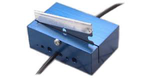

    both for underwater and lab use. We had a fancy one from Thorlabs that cost like $1200 but this one works fine.

  4. 4 hours ago, bvanant said:
    Bill
    I just tap a razor with a light hammer to make the cut against a block of wood.
  5. If I tried that often I suspect it would lead to significant blood (mine).
    Bill
