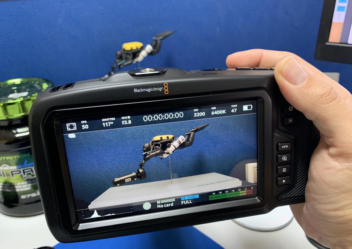

  1. Initial observations using the camera body at my desk:
    Overall, its a massive step back from all the goodies from the GH series, its quite a different beast - but the more I play with it, the more you can see why these are classed as cinematic cameras, not just in terms of color and picture quality, but also in functionality. Below are my general comments, in no particular order.
    1. Buttons
    + Nice feel
    - Only one jog wheel
    + dedicated ISO, Shutter and WB buttons
    + Auto IRIS button (a bit like one-touch AE)
    - Limited function access using purely hardware buttons and single wheel.
    2. Screen
    + very sharp and clear
    + Lovely clean layout, unlike the cluttered GH5
    - Not bright (500nits I believe)
    + Touchscreen responsive
    + Focus Assist very response and clean
    + Ability to output different things to HDMI than the builtin screen (very handy)
    3. Functions / Features
    + Single press AF, is fast enough and seems reliable
    - Auto AE it seems to be using centre weighted.
    - Unable to set WB Tint using jog dial
    - No Waveform Monitor - only Histrogram
    - Live Crop-in - only seems to do 2x
    - Takes a few seconds to boot up
    - Runs warm
    + Customisable F1,F2,F3 buttons - lots of options
    + Ability to set a Manual WB, but holding down the WB button - takes a reading from a central window.
