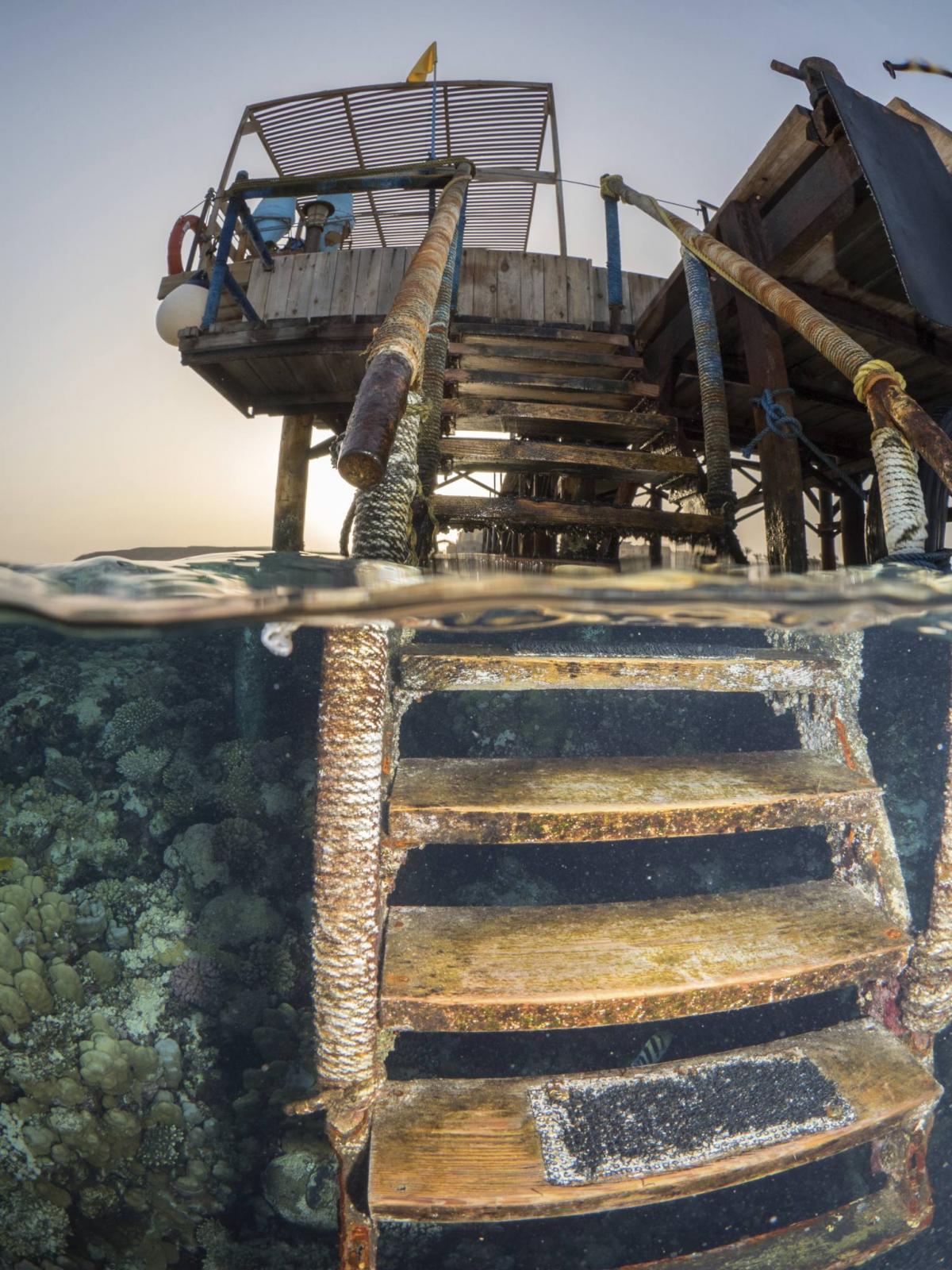

  2. I have taken the following with the 7-14mm in the 6" dome port I take all my splits with a rectilinear lens
    Edited by Interceptor121

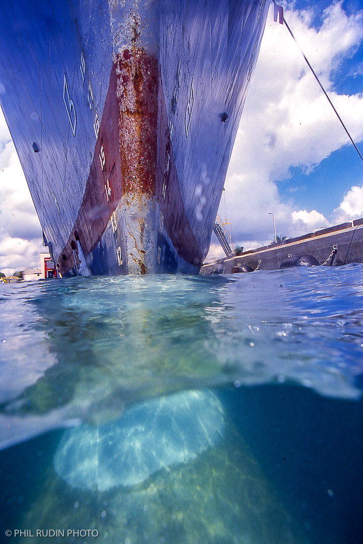

    The attached was taken with a Nikonos RS a 35mm (so called full frame) film camera and an 18mm lens with eight inch dome.
