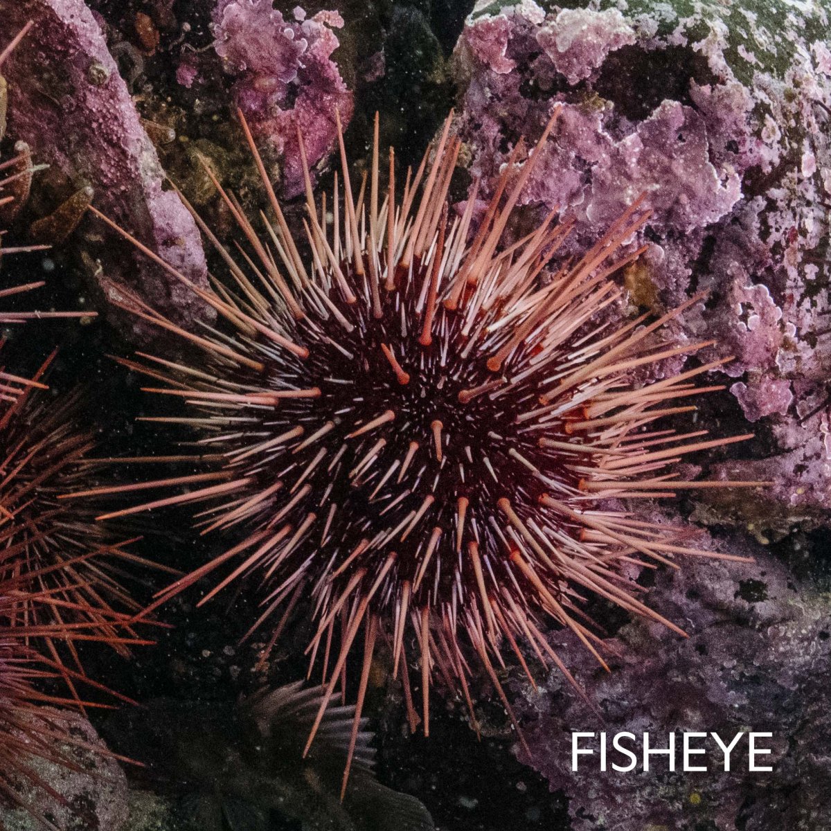

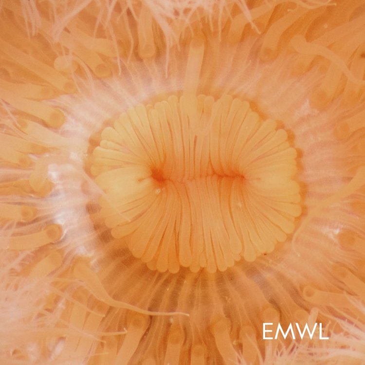

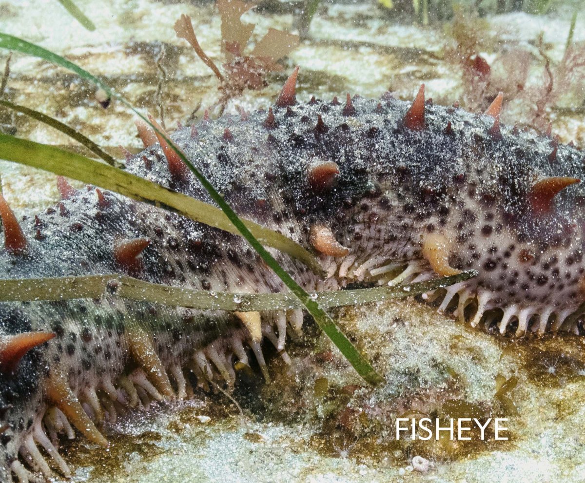

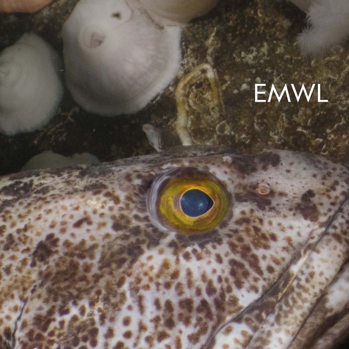

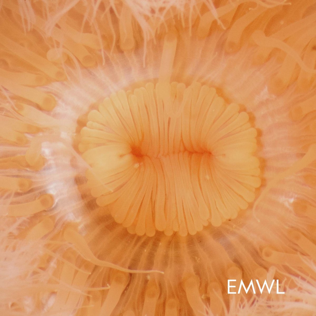

    I've been working with my new EMWL and I love it generally. I’ve been having sharpness issues with the EMWL, though, even when I am shooting with just strobe light, 1/200 at f20 and the 100 degree objective. I haven’t been able to figure out what the cause is. It seems to happen even in good viz (40'+), so I don’t think it’s a problem with muck in between the wet lenses- but i've been diving it in viz from 40' to 15' so it varies.
    One thing that might  be important is that I am using a Saga port adapter specifically for the Nauticam EMWL on my Aquatica housing (yes yes I know). Saga has been producing a number of these and they haven't had any complaints, so probably not the issue. It focuses just fine with this combination so it seems like this shouldn’t be the problem?
    It's possible it's a focusing problem in general, although even when I can't see focus is spot-on, the critical sharpness just isn't there.
    I'm including 2 EMWL images, shot at 1/100, f16 and 2 Fisheye images shot at f/5.6. The fisheye is even on a 1.5x teleconverter!
    Anyone have any ideas? Cheers, Kiliii

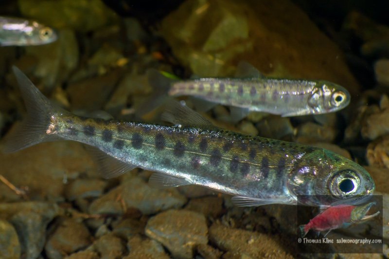

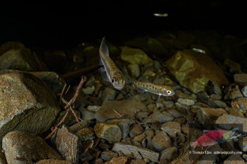

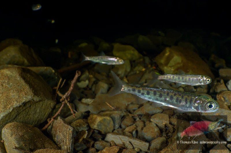

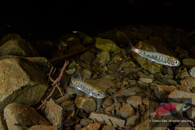

    I have been using mine with the 105VR Nikkor with decent results shooting a Nikon D4S camera using automatic AF point selection in AF-C mode. I am shooting using a remote control plus intervalometer with a pole cam rig. I am about 2 meters away from the subject on more or less dry ground so only have a marginal view of what I am shooting. As well I am using a SAGA port with 67mm threads like the OP and like Isaac I am shooting without the middle section so just the 100 degree objective and focusing unit.
    The pix that are attached are from one of my more successful shoots all done at f/20. Even at f/20 the DOF is very very shallow. These fish are Sockeye Salmon fry about 3 to 4 cm long. In particular the last shot with the salmon at the right edge of the frame - the middle of the fish is in focus but both the head and tail are slightly OOF. The camera was on the streambed so the framing remains constant.
    Edited by Tom_Kline — fixed senior moment error

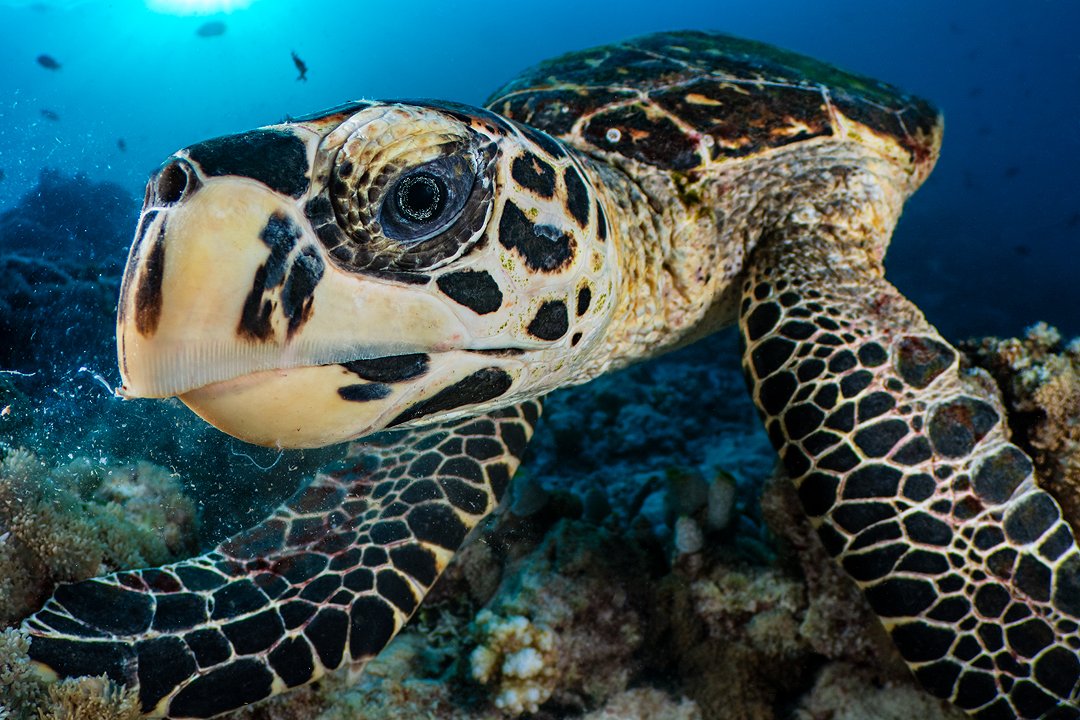

  8. Note quite satisfied with what I just posted I jumped back into LR and did this blow-up of the fish mentioned at the end. Not too bad since the fin rays can be seen and even counted though a bit challenging with this background (the anal fin ray count is an important diagnostic characteristic for identifying salmonids).
