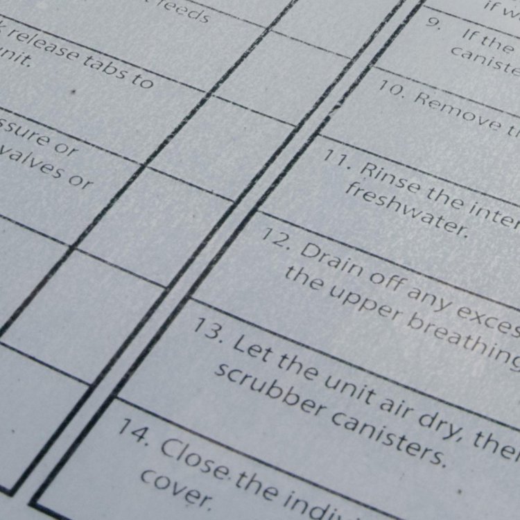

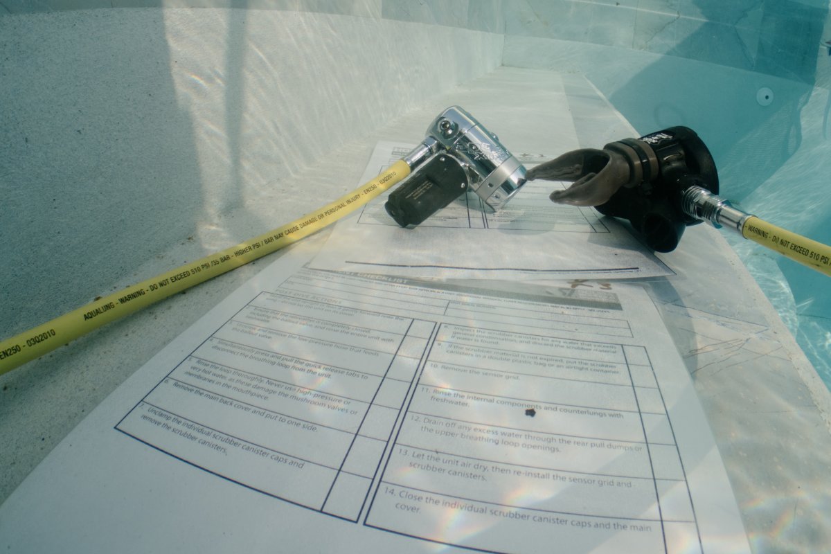

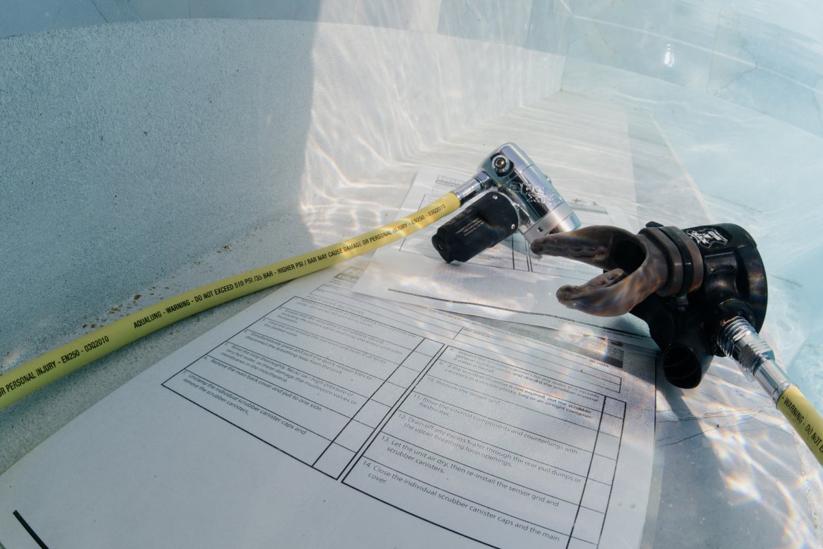

  1. Yes of course, a proper test is in order. I had a moment to do a pool test under controlled conditions. It's my fisheye at 130 compared to the EMWL with 130 lens. Same subject, almost the same exposure (f/11 vs f/16), 1/200 second, chose the sharpest of a set of 12).
    Focus point is on the number 12 on the checklist, more or less the center of the printed checklist page. You can see that focus is correct on both, and there is text both in front and behind the focus point. There's also writing on the reg hose to compare.
    Fullsize 48mpx images, uncropped, unedited, no sharpening applied.
    Any ideas?

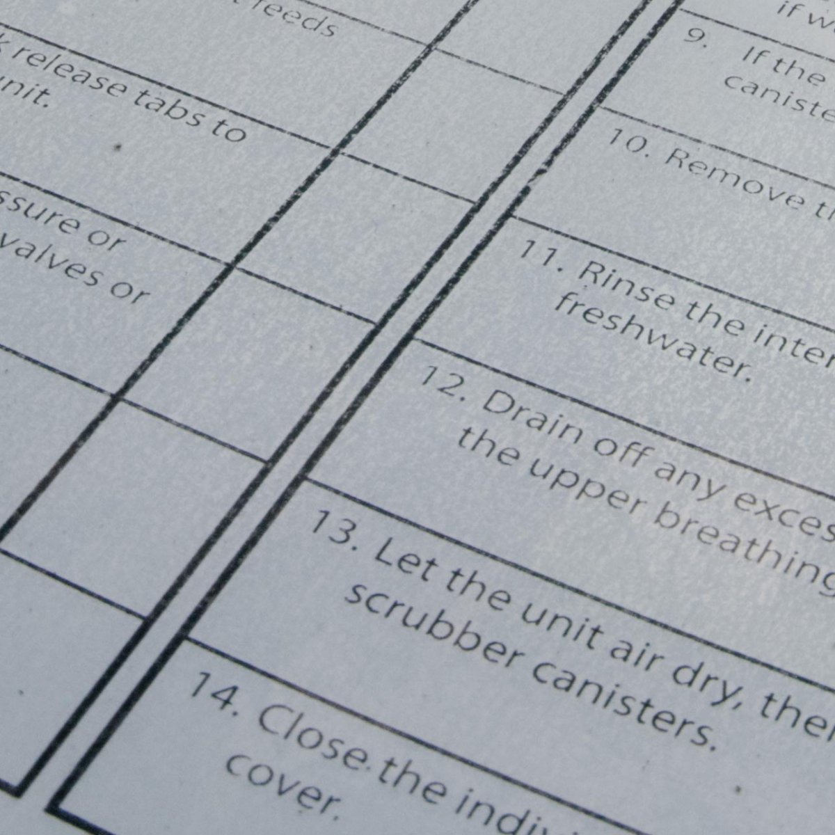

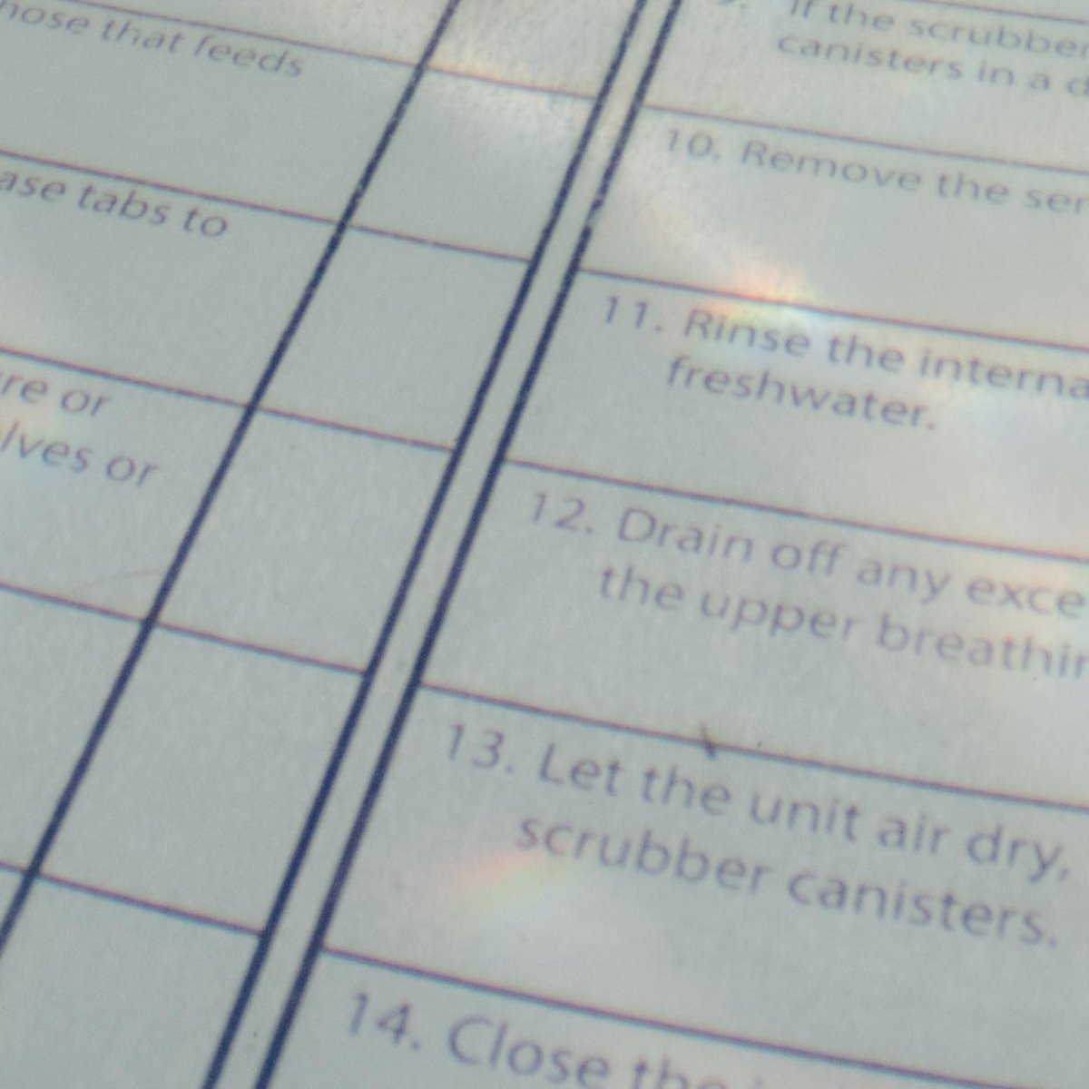

  2. One more post for those who can't download the full-size jpegs above- two 100% crops, fisheye and EMWL.

  4. Thanks @kiliii. From the full resolution shots it is clear that the EMWL shot has backfocus error. The image is sharpest around/behind the regulator. I'll also note that while shooting at f/16 will increase depth of field, it will decrease the sharpness of fine details a little bit compared to shooting around f/8-f/11.
    It would seem that the EMWL causes a backfocus error with your camera just like it does with my A7R II. The problem is that the image quality with the EMWL at f/2.8 is so poor that the camera's autofocus system fails to determine the correct plane of focus. The solution is to focus with the aperture stopped down some so the image quality improves enough for the autofocus system to work properly. The lenses I have tested needed to be stopped down to around f/5.6-f/6.3 to focus accurately.
    So your next step is to try all the different autofocus modes/settings on your camera and see if there are any that will perform the autofocus operation with the aperture stopped down. It can be helpful to watch the aperture through the front of the lens with a headlamp while you try out different focus modes. I would recommend doing this with both the native and adapted lenses since they may behave differently. With my Sony I discovered that in AF-C mode after the initial focus acquisition it will stop down the aperture and continue to refine focus with the the aperture stopped down, providing me with a way to get accurate focus with the EMWL. I don't have much experience with Nikon mirrorless cameras and have no idea if there's a mode/setting that will accomplish this.
    If you cannot find a way to autofocus with the aperture stopped down but still want to use the EMWL, then you could try focusing in front of subjects. With some practice you might be able to get a feel for how much in front of subjects to focus, but obviously this will never be an ideal solution.
