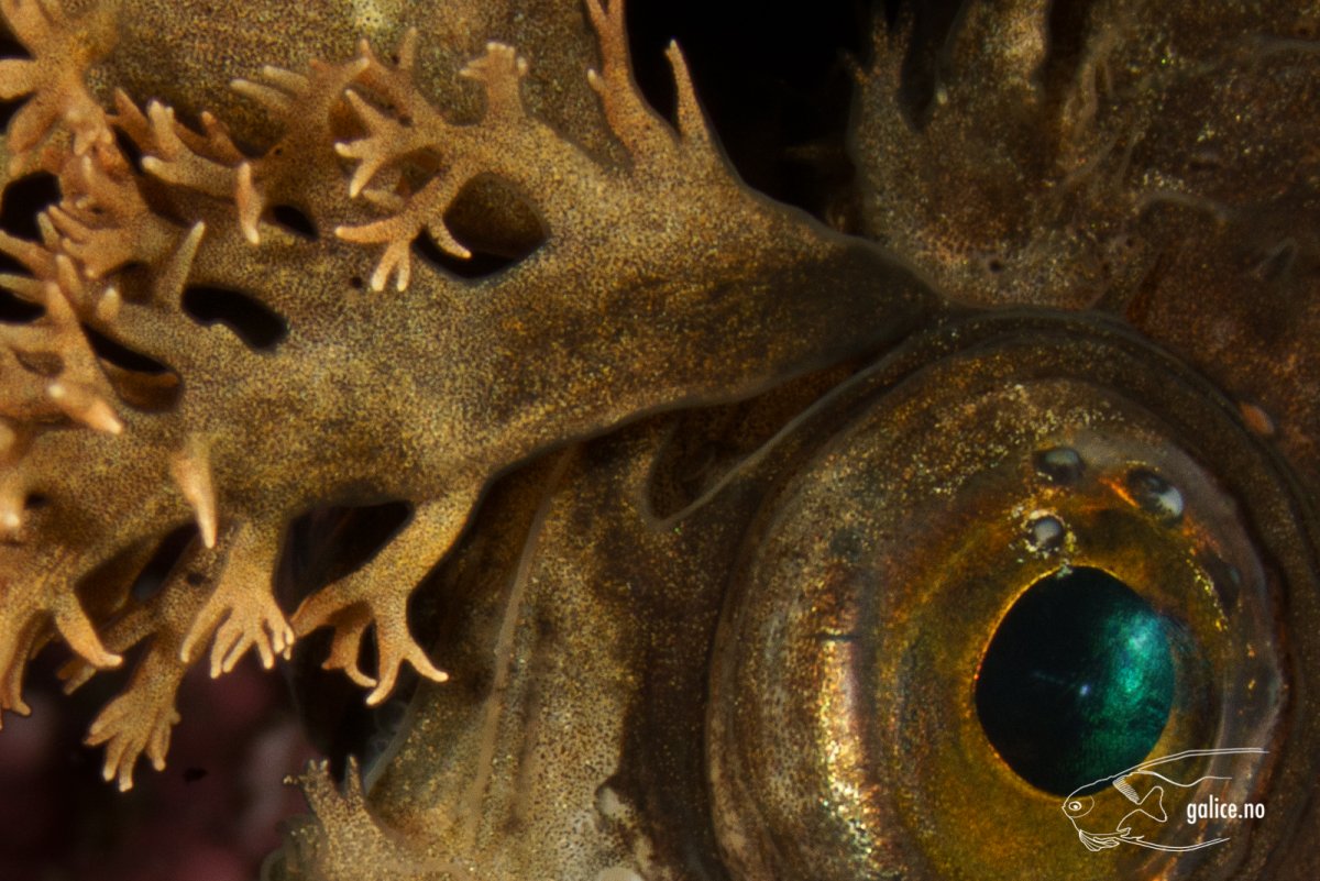

  1. @Alex_Mustard Thanks for your thoughts! I’m largely in agreement, except I’m not sure you’re fully grasping the severity of the focus shift issue. You’re lucky that the Nikon 105mm seemingly does not suffer from it, but with other lenses accurate focus is difficult or impossible with the EMWL no matter how careful one is with technique. With my setup (Sony 90mm) all photos are significantly backfocused with normal shooting techniques in which the camera focuses at f/2.8 rather than the shooting aperture (example below). Thankfully I did figure out a partial workaround by using AF-C and focusing for several extra seconds before taking the shot (with Sony this forces the camera to focus stopped down to the shooting aperture instead of at f/2.8). But I miss many shots by having to wait those extra seconds. And it only works up to f/8, so I don't have the option to stop down for more depth of field. And since the focusing is happening with the lens stopped down to f/8, it doesn't work in low light. But at least there is a way to get some functionality with my Sony setup. For other setups that suffer from this issue there might not be any workaround. So while I was a little disappointed to discover that the EMWL image quality is not as good as it was hyped up to be (according to Nauticam the 130 “image quality rivals the best wide angle lenses”), I’m OK with that considering the unique things it can do. My only real complaint is that it lacks basic functionality with some setups.

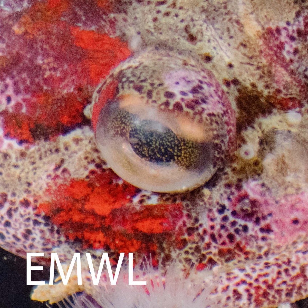

  2. I want to make clear that when I’m able to get the EMWL to focus properly, I’m pretty satisfied with it. In this case it allowed me to get a wide angle shot of a species (Warmouth) that is normally too skittish for wide angle. So it definitely has its uses even though it's not as sharp as my other wide angle lenses. Some of my shots of this fish were backfocused, but since it was staying still I was able to give the camera numerous attempts to focus using the AF-C trick.
    100% crop:

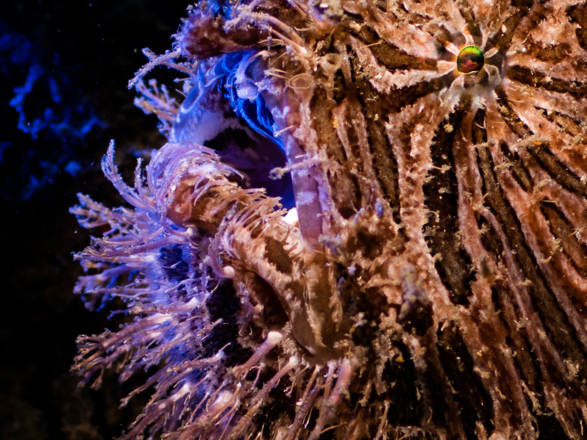

  4. Hi everyone,
    I am very surprised to read about these sharpness issues with the EMWL, as they are so far from the experience I’ve had with the 100 degree lens.
    I suppose I am lucky that my configuration was one that had received more testing during the design, but I thought I’ll share my experience there.
    I shoot the 100 degrees lens (haven’t got the other ones) with a Nikon D810 and Nikon 105mm AF-S VR lens.
    To be honest I was a bit unsure about this configuration, with the thought that the extra layers of optics were going to make my D810 struggle more with focus - because I was finding my D810’s autofocus not reactive enough, when shooting the 105mm lens ‘naked’ (would need a focus light to work fast), certainly slower than my D500’s AF.
    And indeed the scene looks darker with the EMWL, when looking through the viewfinder.
    Anyways, to my pleasant surprise, I made the following observations:
    1/ my D810 has become… very fast at grabbing focus with the EMWL on! And most of my shooting took place in Sydney’s harbour, think 3-7 meters viz. I suppose this has to do with the optics of the EMWL making the image more contrasted.
    2/ my ‘success rate’ (getting critical sharpness where i wanted) is very high, probably above 80%, and I can’t count the many times i am looking at the LCD screen, thinking the focus is average, but when lightroom finishes zooming into my raw file, BIM! A sharp image shows up.
    3/ Like @Alex_Mustard mentions, a strong yellow cast is on all photos, but that is easily fixed with a WB adjustment.
    In terms of my settings:
    => I am always using continuous AF (Nikon AF-C, tracking enabled on all AF points).
    => with aperture, I’ve been happy with photos as open as F13-F14, but that doing some pixel peeping I can tell the depth of field remains relatively shallow, but outside of it the general feeling of sharpness remains excellent. If I am getting pretty close to the subject, F18 is my go-to setting, and I’ll go to F20-F25 if I need more depth of field.

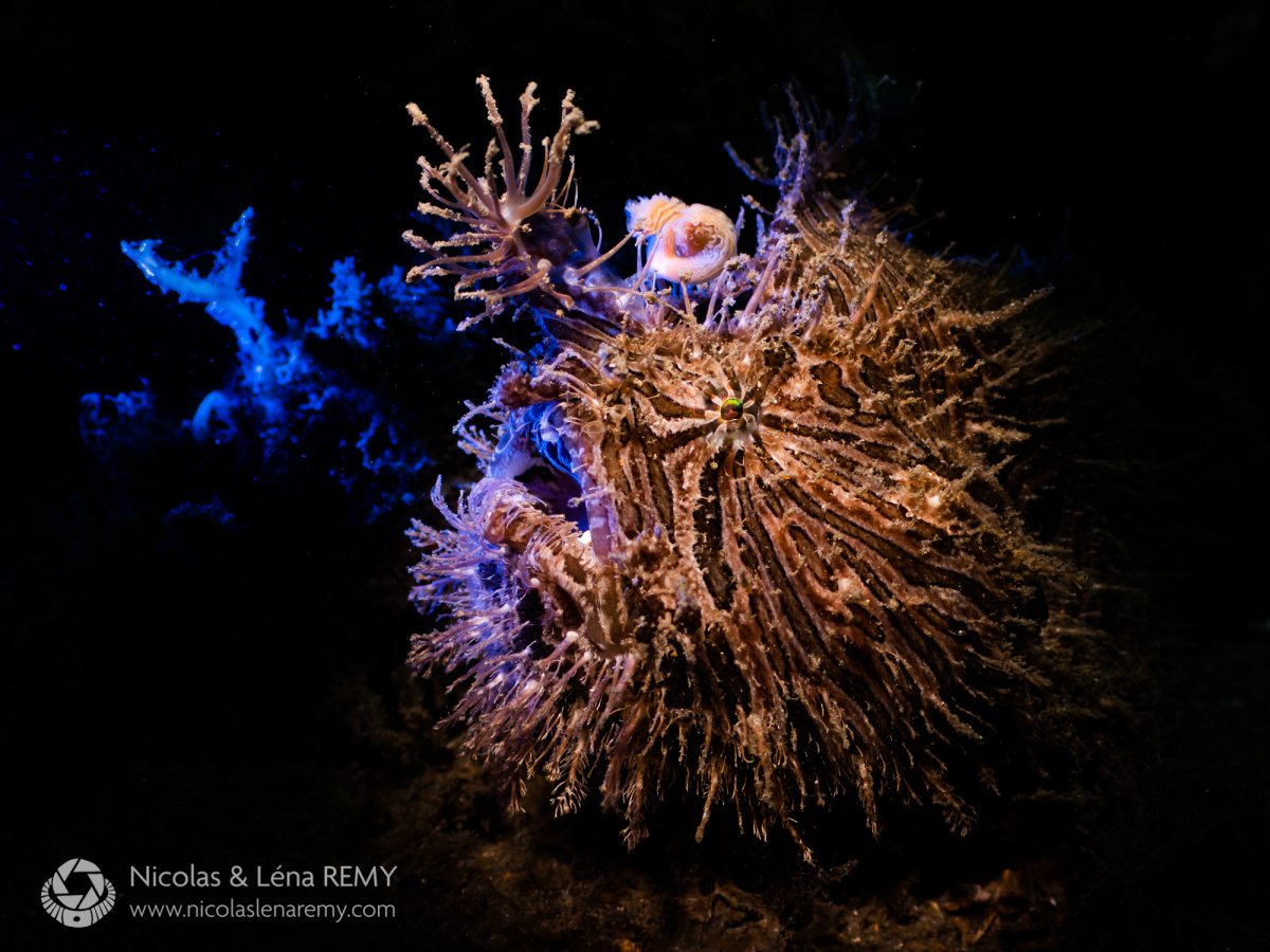

    2 examples I have attached:

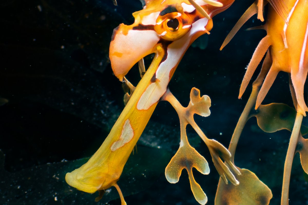

    -the frogfish is at F13, 1.250e, ISO 100
    -the seadragon is F14, 0.5 seconds, ISO 64
    I suppose anyone shooting a full frame Nikon DSLR with the same lens as I do (Nikon 105mm AF-S VR) can expect the same performance @Edward Lai ?

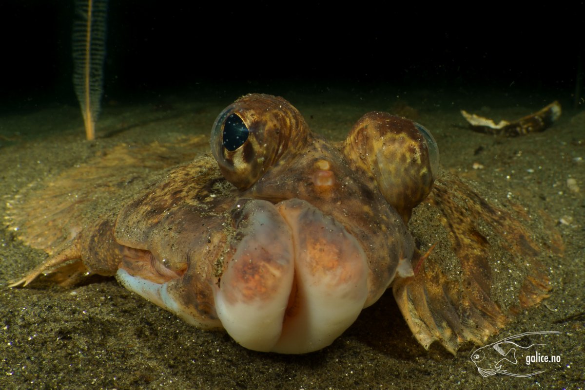

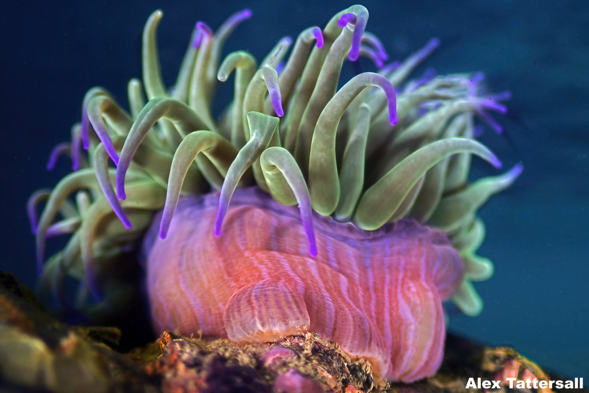

  6. Hi all, Another vote for the sharpness of the Nikon 105VR this time on the D850. Very fast and accurate focusing using AF-C 3D much of the time on the rear button. I generally found that I needed to be around F11 and smaller simply because the Retra Pro X I was using would over-light the subjects on minimum power. The Retra Pro X does have an option of low power which drops the power of the flash which I will use in future with wider apertures.
    These links are photos all taken with the 100 degree optic where EXIF data is available so you can see the apertures I used.
    and some in the UK

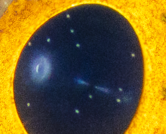

  11. Finally had a chance to process a second EMWL-1 photo from my recent Maldives trip. This is taken with Nikon D5 and Nikon 105mm VR (plus EMWL, of course).
    Again, with my setup, the sharpness is excellent.
    Attached are the full image of a small yellow margin moray. And a crop of the eye. I processed this picture at Super-resolution (just so nobody says it looks sharp because my D5 is only 21MP!). So the eye crop is 100% on an 83MP uprezzed version of the original file. (I don’t usually Super-Res my D5 shots - just did here for the reason stated). I’ve not done any sharpening or local contrast adjustments on the eye. For me the pupil is very clearly defined and even the pinpricks of reflection in the eye render well.
    Settings: f/18, 1/100th, ISO 640.
    Alex
    Edited by Alex_Mustard
  12. Beautiful shot @Alex_Mustard! Which objective? I think it has already been well-established that the Nikon F 105mm works properly with the EMWL. What would be helpful at this point is more information from Nauticam on which of the other supported lenses work properly and which suffer the most from the focus shift issue. I would certainly consider switching to a different lens if it meant I would get proper functionality with the EMWL.
    As for the 100% eye crop, obviously everyone has different standards, but to me that sharpness isn’t very good (certainly not rivaling the best wide angle lenses as Nauticam claims). That said, when you factor in the unique abilities of the lens, I suppose it’s acceptable. And of course it would also look better without the upscaling.
    Edited by Isaac Szabo

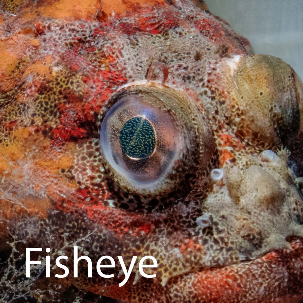

    I've attached 3 images at 100% crop. A stands for Aquatica housing, N for Nauticam (friend's housing), and FISH is fisheye lens vs the EMWL/Nikon F105 macro.
    I think you should see there's a tremendous loss in contrast and sharpness on the EMWL. It seems to me that there's a lot of what is apparent fringing, as if a diffusion or mist filter was attached to the front of my lens.
    Cheers everyone! Happy diving.
