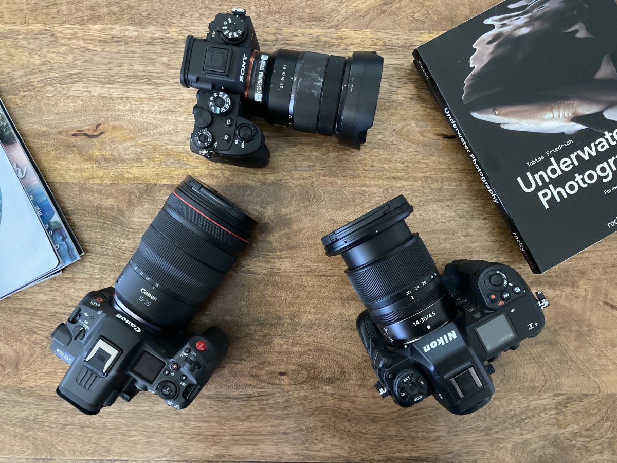

  1. I'm upgrading from a GH5 camera to full frame. I shoot both video and stills, so I'm looking for a true hybrid camera option. 8k (and preferably at 60fps) is important to me for future-proofing stock footage.
    Through a series of incidents, I ended up in the possession of a Sony A1 (with EF 16-35F4 image-stabilized lens), Canon R5 C (with RF14-35F4 and RF15-35F2.8 image stabilized lenses) and Nikon Z9 (with Nikkor Z 14-30F4 lens), not image stabilized. I No underwater housings yet, but I figure I can put them through a series of top-side tests to figure out which is the most capable solution for an underwater shooter looking for a true hybrid camera. And since I'm doing the tests, why not share my results in a series of posts and invite you guys to suggest other tests as well. So let's begin!

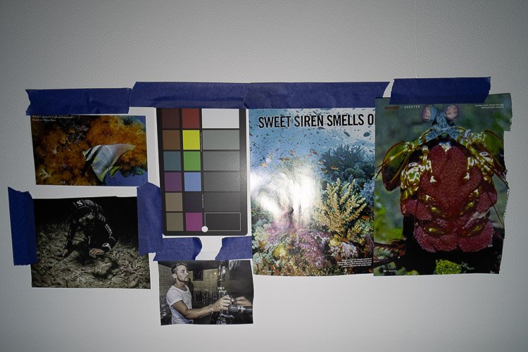

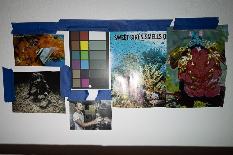

  11. Can you Edit The Video Codecs?
    First, I tested this on my 2018 15" Macbook pro ( 2.2 GHz 6-Core Intel Core i7, 16gb ram, Radeon Pro 555X 4 GB). I have a 2022 M1 Max Macbook Pro on order, so I'll repeat the tests with the more powerful system later.

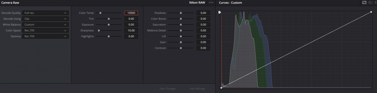

    Nikon Z9
    • 8k N-RAW would play back at no more than 16-17 fps in Davinci Resolve, whether decoded in full, half, or quarter resolution
    • 8k h.265 8k30p 422 10-bit plays back at almost but not quite real time (30fps)
    • 4k h.265 4k60 422 10-bit plays back in real time most of the time (60fps) but stutters once in a while
    • Raw files allow for white balance to be pushed up to 50000k and +150 tint
    • Raw files with Custom White Balance set in camera start out at no more than 10000k, suggesting in-camera custom white balance maxes out at 10000k.

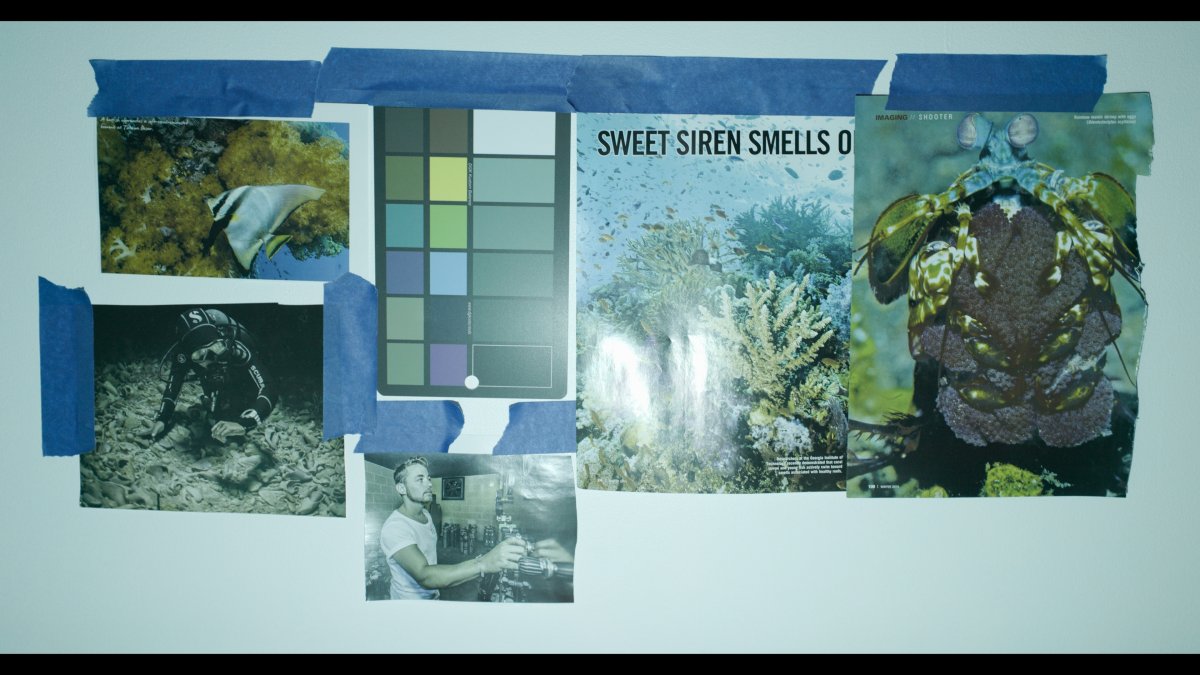

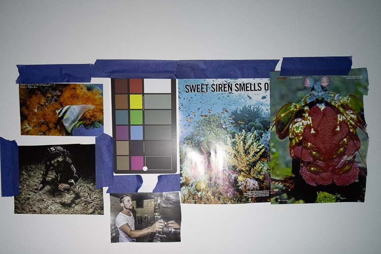

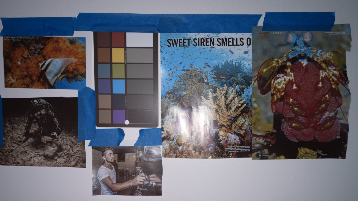

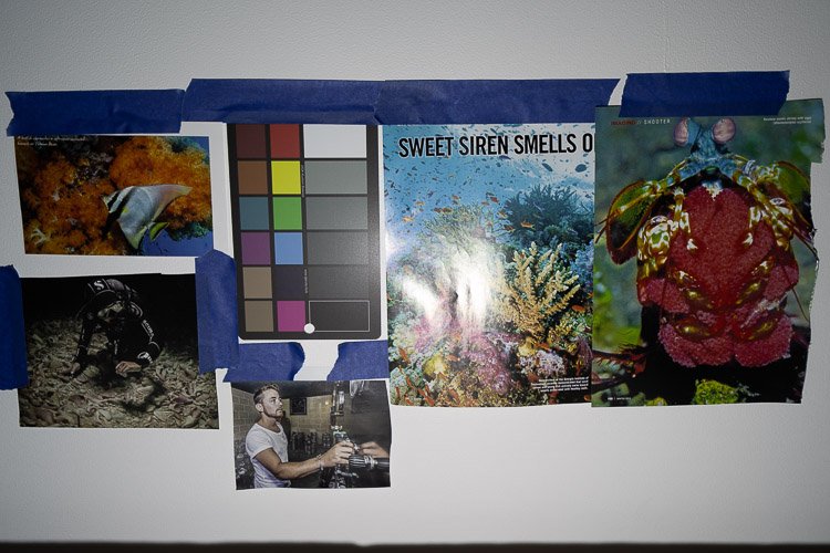

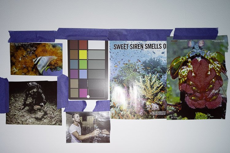

    Same white wall lit up with a 5000k video light through a Lee 353 Lighter Blue gel, First, with CWB done in camera. Second with WB deliberately set wrong at 3000k in camera and adjusted to 10000k to match the in-camera CWB during raw decode.  No matter how I adjusted the color temperature and tint, despite the wider range than what's available on the Canon RAW files, I could not neutralize the Lee 353 gel in post. Whereas both the Canon and Nikon were able to neutralize the gel almost perfectly when setting CWB in camera.

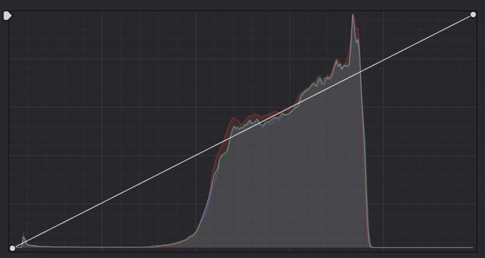

    1736990795_ScreenShot2022-07-07at9_04_09PM.thumb.png.fea6d7d68d5e4c1383417ce4668fd55b.png
    1082167352_ScreenShot2022-07-07at9_05_17PM.thumb.png.7a33cae980700738cb773f057e4dc201.png

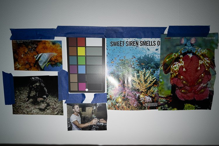

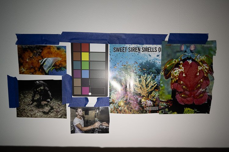

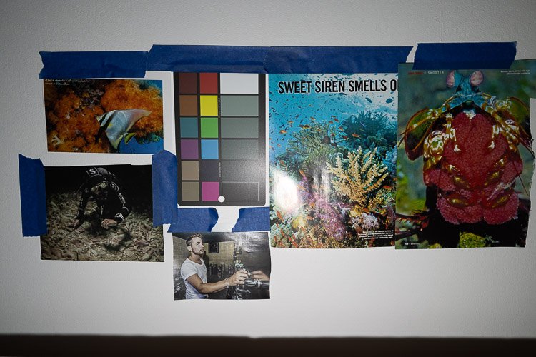

    Canon R5 C
    • 8k Canon RAW LT & ST plays back at 17-18 fps in Davinci Resolve if decoded at Full Res (Resolve) or 2-3 fps if decoded at Full Res (Canon). Decoding at Half Res is still 17-18fps but going to Quarter Res gets you ~26fps. Still not editable (unless filming at 24p I guess)
    • 8k30p h.265 in 422 10-bit plays back at 13-14fps
    • 8k30p h.265 in 420 10-bit plays back at 24fps
    • 4k60 h.265 in 422 10bit plays back at ~20fps
    • 4k60 h.265 in 420 10bit plays back at ~29fps
    • 4k60 XF-AVC in 422 10 bit plays back at 29fps.

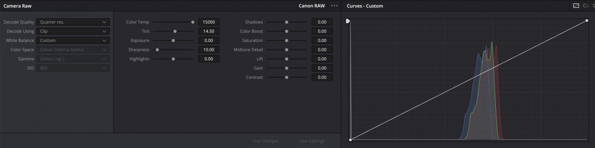

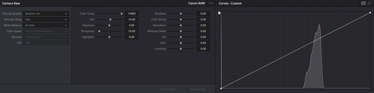

    • Raw files only allow for white balance in raw decoding to be pushed up to 15000k! and +150 tint.
    • Raw files with Custom White Balance set in camera also seem to max out at 15000k and +150 tint. However, the results are not the same! If I set the Custom White Balance in camera and shoot in raw, vs shooting in raw and putting in the same settings again in post, the CWB in camera achieves better results with more neutral white balance. This suggests that with the Canon raw files, some of the white balance setting are nonetheless baked in!

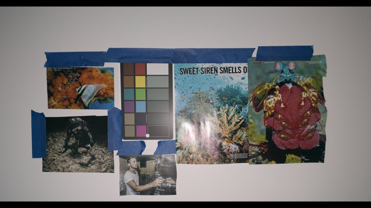

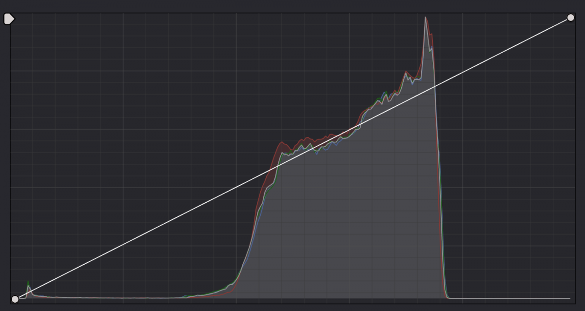

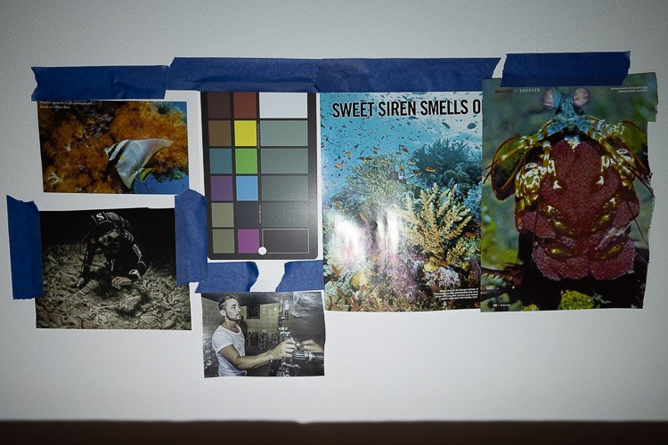

    Same white wall lit up with a 5000k video light through a Lee 353 Lighter Blue gel, First, with CWB done in camera. Then with WB deliberately set wrong at 2700k in camera and adjusted to 15000k during raw decode. Judge the histograms for yourself.. 943993689_ScreenShot2022-07-07at8_51_57PM.thumb.png.6880e8bcc695d4eccac5f233212a74a1.png
    1905024456_ScreenShot2022-07-07at8_52_09PM.thumb.png.67af8fb1f2dba7c57bace3e5cfb88898.png

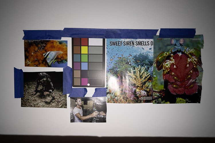

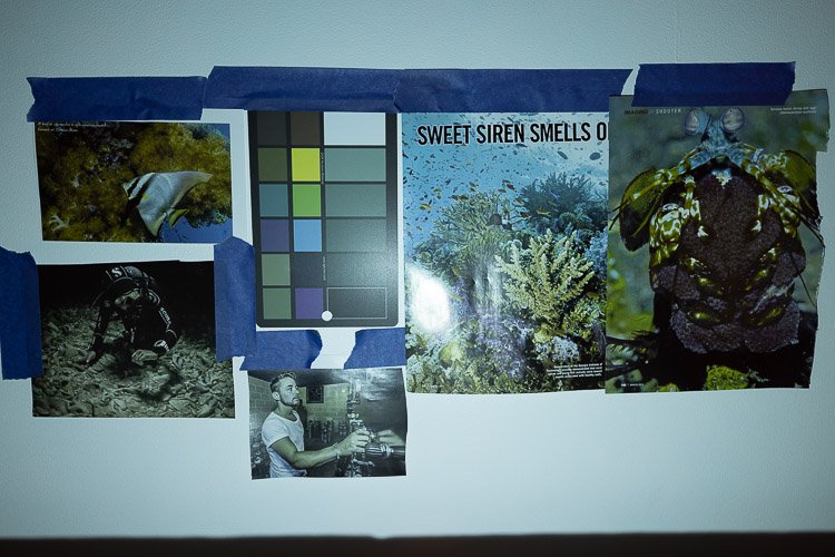

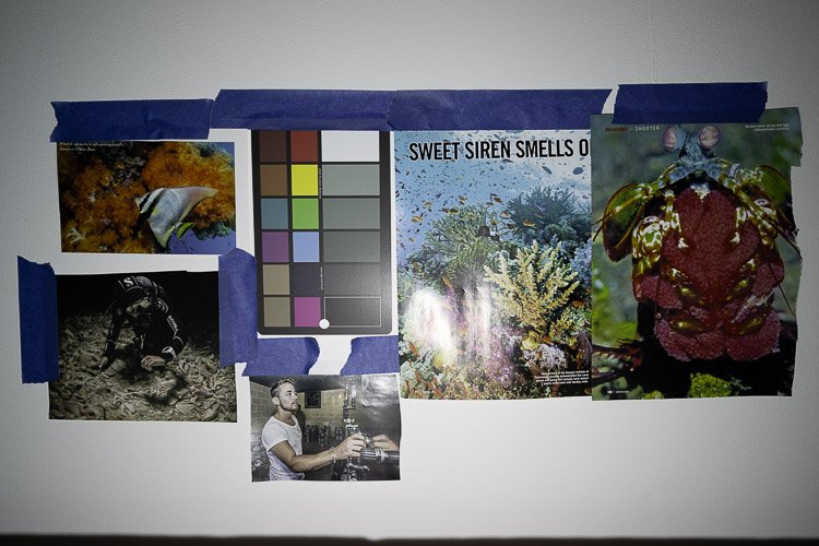

    Sony A1
    • 8k30p h.265 in 422 10-bit plays back at 22 fps
    • 8k30p h.265 in 420 10-bit plays back at 32 fps
    • 4k60 h.265 in 422 10bit plays back at ~35 fps
    • 4k60 h.265 in 420 10bit plays back at 60fps -- only editable format!
    • 4k120 h.265 in 422 10 bit plays back at 29fps.
    • 4k120 h.265 in 422 10 bit plays back at ~27fps.
    • 4k120 h.265 in 42010 bit plays back at ~52fps.

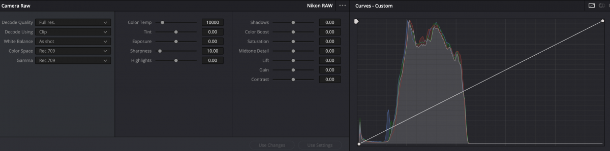

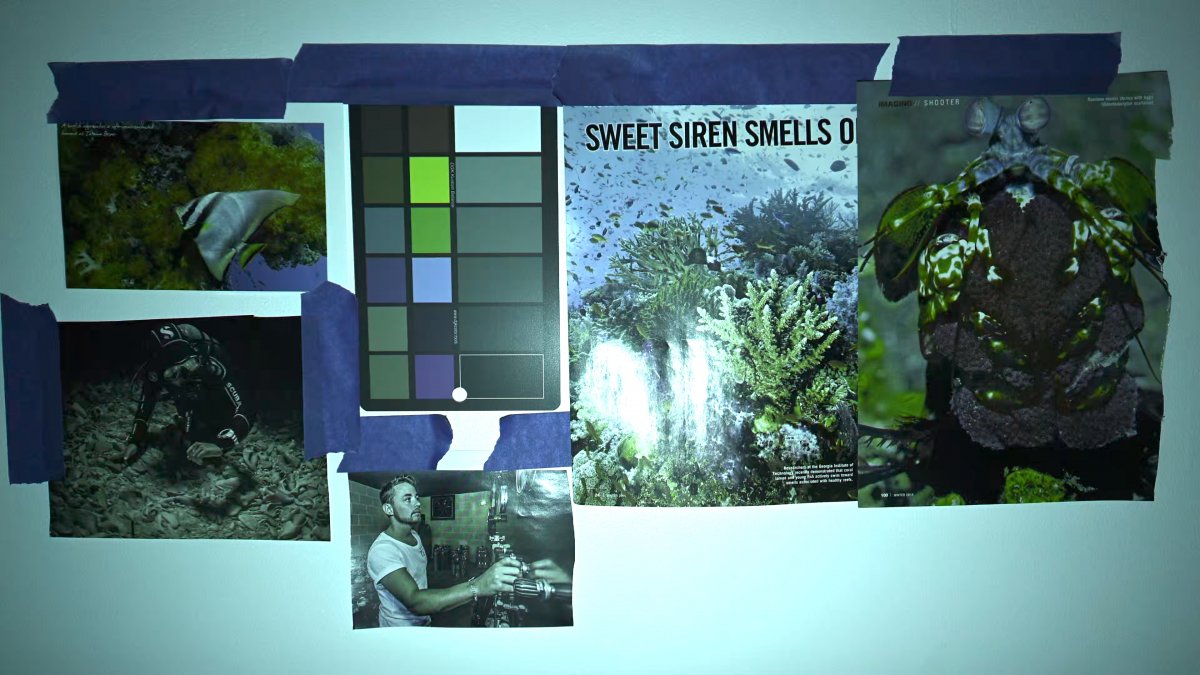

    • CWB in camera was able to neutralize the Lee 353 Lighter Blue gel just fine:
    1531851998_ScreenShot2022-07-07at9_35_18PM.thumb.png.33c16c62c3c4c3fe53825f34a42999d6.png
    Conclusion -- wow, terrible. I would say none of the Z9 or R5 C codecs is really editable without proxies on an older machine. Of the A1 codecs, only the 4k60p in 4:2:0 10-bit was editable. Guess if you're getting any of these cameras, budget for a newer computer, too!
    Next up -- a deeper exploration CWB's ability to neutralize various shades of green/blue introduced using Lee and Rosco gels to simulate underwater ambient light at depth. Will test both with CWB set in camera and set in post for the Canon R5 C and Z9 when shooting raw to see how much of the white balancing you can leave to post with these 'raw' video formats.

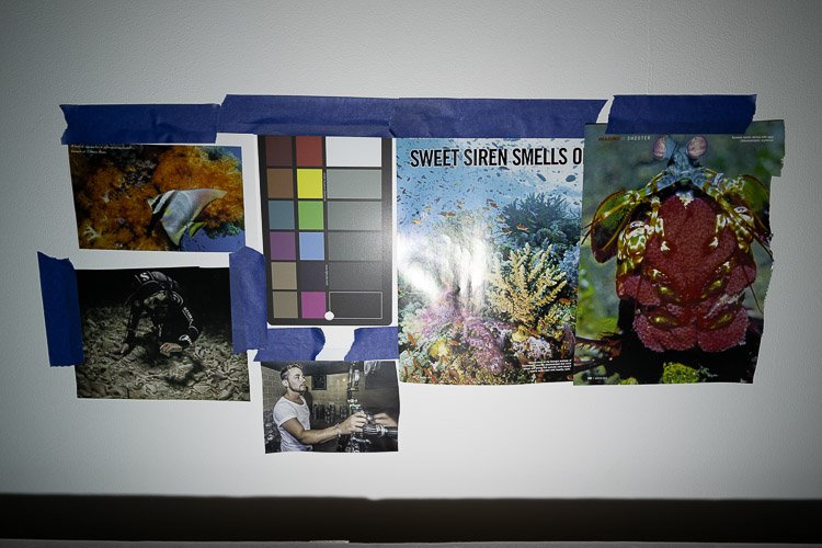

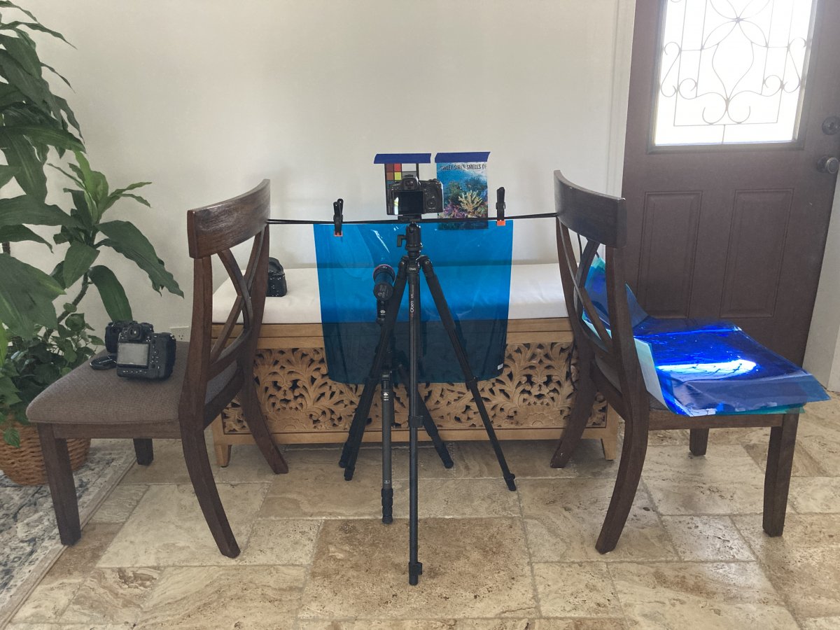

  14. White Balance Flexibility for RAW Photos
    I don't have any housings, so I tested this by illuminating some illustrative scenes with video lights shot through various filters to simulate gradually cooler ambient light at different depths. This is the setup:
    In the rows below, the order from top to bottom of the images is A1 -> R5C -> Z9. DM me if you want raw files to play around with.
    With no filter (~5000k)
    Lee 353 Filter (~20000k, +100 Magenta)
    CanonR5CLee353.jpg.68ce0f5336b5e46ac9019f491f50dea5.jpgNikonZ9Lee353.jpg.b1d167afe429a5956caa6ab3f3a1e76b.jpg
    Lee 353 Filter Stacked w/ Rosco 4330 Filter (~25000k, +120 Magenta)
    Lee 724 Filter (~30000k, +80 Magenta)
    Lee 724 Filter Stacked w/ Rosco 4330 Filter (43000k, +110 Magenta)
    Lee 724 Filter Stacked w/ Rosco 4360 Filter (50000k, +125 Magenta)
    The results are remarkably similar through the first 6 tests, though the specific kelvin temperature and tint used to achieve them did vary a fair bit in Lightroom. In general, the Nikon needed the lowest kelvin temperature, and the Sony the highest. Canon sat somewhere in the middle.  The other thing I noticed is that the Canon seems to produce slightly more saturated blues.
    The last test was with a Lee 172 Filter (~50000k, +150 magenta).
    None of the cameras did great in this very challenging light. But I'd say the Canon R5C was the best of the lot, retaining a blue water column, and the Nikon Z9 clearly the worst, turning the water column purple. (The Nikon Z9 could not set an in-camera CWB in this light, whereas both the Sony and Canon could. But more on that later when we get to WB in video).
    Edited by dreifish — Removing extra photo.
  15. Manual White Balance in Camera For Video
    All three cameras allow setting CWB off a neutral target like an 18% grey card fairly easily. The Canon has a true one-touch white balance, but the downside of this is that it uses the entire frame for the white balance. The A1 and the Z9 allow you to set the white balance off a smaller portion of the screen but take a few more button presses to get there.
    I tested the results using the same setup as for the raw stills, but doing a white balance in camera. On the Nikon Z9, I filmed in 8k N-Raw, and 4k Prores Raw and Prores 4:2:2 in the Flat picture profile. On the Sony A1, I filmed in 8k 4:2:2 10-bit in Picture Profile 11 (S-Cinetone). On the Canon R5C, XF-AVC 4k 4:2:2 in 709 Wide DR.
    Results are presented Sony A1 -> Canon R5C -> Nikon Z9
     Both the Sony and the Canon are still holding up quite well, but the Sony is more contrasty and saturated. I rather prefer the lighter blue rendition on the Sony, it seems more saturated. Thoughts? To me, the Nikon produces the worst result.
    Lee 172 Filter ( ~50000k, +150 magenta).
    SonyA1Lee172Still_1.4.1.thumb.jpg.2bbfaf03f73621aa046a6b1b456c832f.jpgCanonR5CLee172Still_1.1.1.thumb.jpg.8b1f82a521a869532d577a8c96328004.jpg
    None of these great, but the Sony A1 file clearly (and surprisingly) looks better, no? The Nikon z9 refused to set a custom white balance, it's outside its range in this challenging light..
    Surprisingly, I'd say Sony A1 wins the video manual white balance battle. Canon comes 2nd. Nikon also is fairly capable, but breaks down at the edge cases and to me at least doesn't look as good as Sony or Canon.
