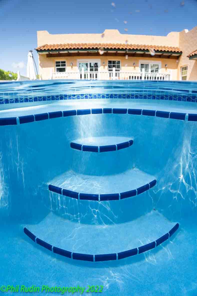

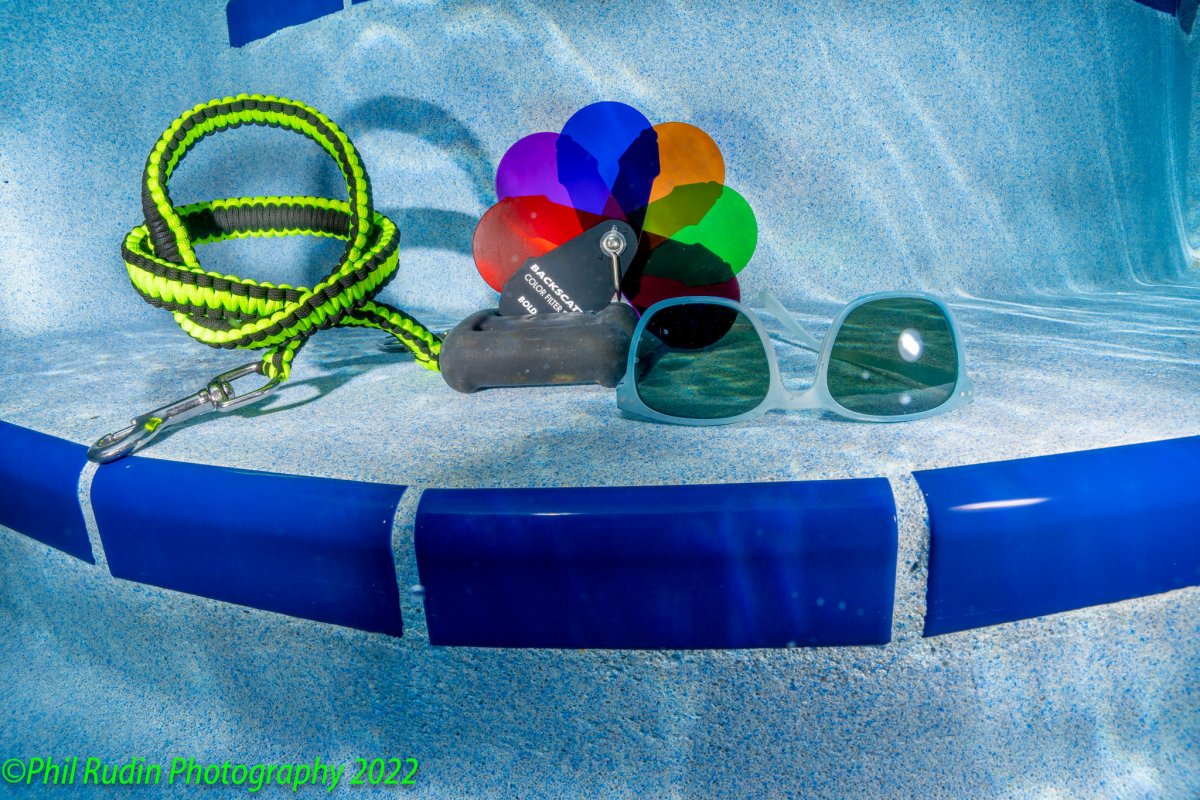

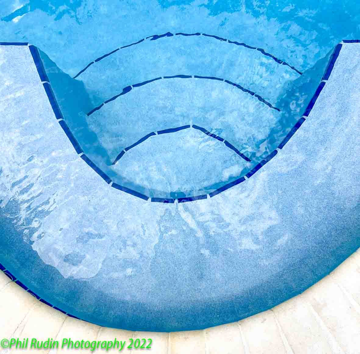

  1. The picture underwater number 1
    The edge of the step is totally distorted and this is a rectilinear lens
    When the dome center is behind the entrance pupil the image gets further distorted instead of being rectilinear
    When the dome is ahead of the entrance pupil you have pincushion distortion
    What you are showing there is almost a fisheye effect so the extension is too short at that focal length

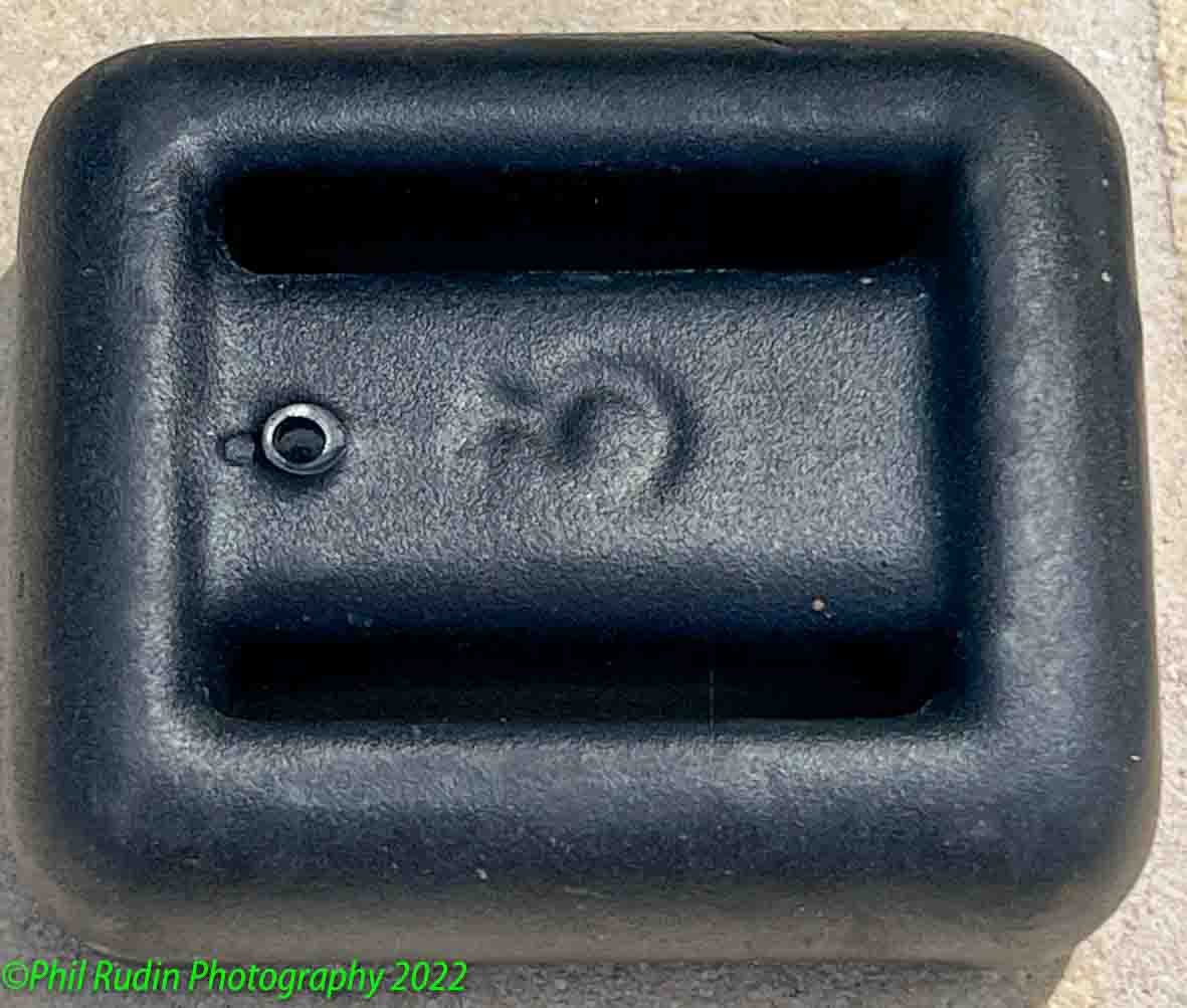

    Looking a bit closer the step itself may be bent but I doubt the tiles are
    And also the weight looks very roundy

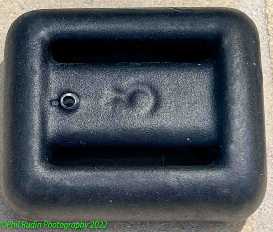

  2. I guess that I am not seeing what you are seeing. The "totally distorted " step or  the "tons of barrel distortion" you described above are a result of the design of the pool and the black weight not the lens. If the steps are distorted then why is the ruler not distorted using the same system.
    Also please forgive me for not using profiles in the cell phone images taken above water.
    Edited by Phil Rudin
  3. That is one powerful lens!  It somehow managed to bend the concrete steps into having their own barrel distortion.
     Don't let that thing near me!  I already suffer from barrel distortion in the stomach area.
    If you have the same thing in a pincushion version, I might like to borrow it.
    Lol had not worked out that the steps were that bent
    I can't comment on the rules as the image look a bit coarse and it is at an angle maybe if it was straight
    It was a funny mistake, yet I do not like those images not if this is the resolution or what but they are gritty

  7. Using images posted on here to check the quality of a Setup is dubious at best considering the low resolution wetpixel allows. Things like distortion not withstanding but we’ve already figured out those steps are always „distorted“.

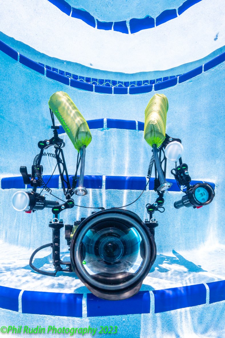

  9. See if this is sharp enough for you.

    Fear not Wolfgang I am sure you will be pleased with the results behind the 170/180mm dome. The fact is that you can easily focus down to about 2 to 3cm in the 180mmm port. This zoom lens will get you a bit closer on the 70mm end with about a 1cm difference on the wide end. While I own several lenses that will focus all the way to the glass I can't ever remember wanting to ram my expensive port glass into the subject I am photographing. If you were to choose the 230mm option then it will be focusing inside the glass. I use the light in my pool to test close focus, it is 15cm (6 inches) across so you can get an idea of how close you can get at both ends of the lens.

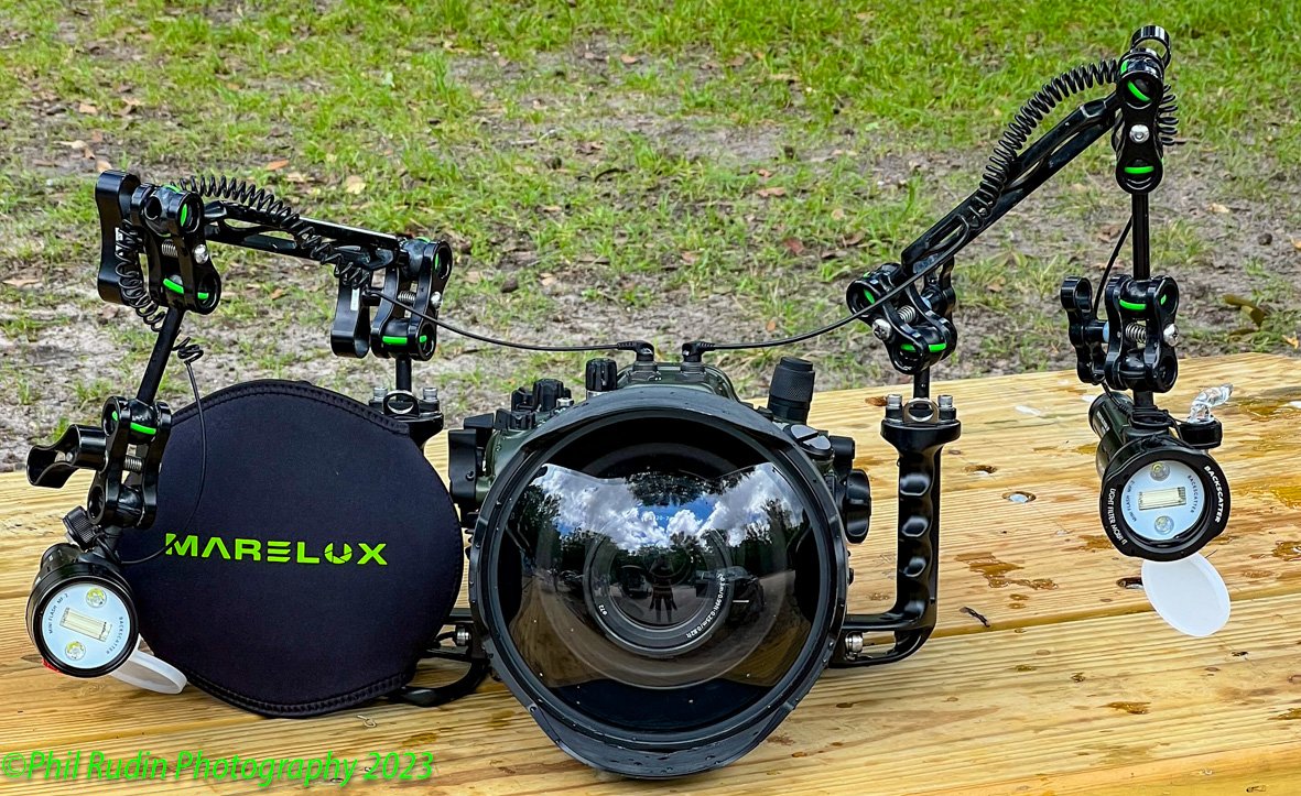

    I have used the Marelux Sony A7R V housing for these photos with the MX-180mm dome and 50mm of extension. The conversion for the Nauticam housing with the N100 to N120 35.5 port adapter would be an extension around 30mm with 180mm port.
    Since the $1100.00US Sony FE 20-70mm F/4 covers the zoom range of both the $2300.00US Sony FE 24-70mm F/2.8 II and the $700.00US Tamron 20-40mm F/2.8 I will not be investing in either of these lenses nor do I believe the F/2.8 aperture adds any value for U/W work.
    Images both at F/13 AV light, #1 at 20mm and #2 at 70mm.
