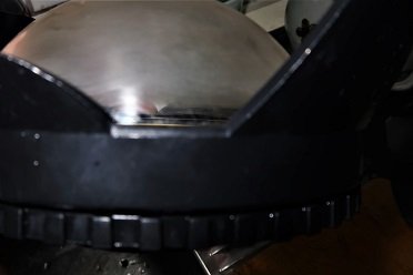

  15. So I decided to try out the technique used by the guy on youtube a couple of posts before this one.
    I have a pretty scratched Meikon dome which I was going to discard to purchase a new one. Since all the items used are readily available in our hardware store (I live on an island in the Caribbean) I decided to give it a go.
    In short: DO NOT ATEMPT TO DO THIS! IT DOES NOT WORK!
    Sure maybe I did something wrong but I can assure you I did exactly what he did and the end result is horrendous.
    Here my scratched dome before doing anything:
    Here is what I used: 3M wetordry 400, 600 and 1500 sandpaper and Brasso....
    IMG_8412.JPG.dea3545141f1669dc52a5d14ebb750c0.JPGIMG_8413.JPG.c8b00c88dffcee8cd1e20bf46a0233e5.JPG
    Here is the dome after the 400 sandpaper:
    Here after the final 1500 sand paper:
    And here after applying Brasso multiple times (not pretty at all):
    I even tried the 1500 again for a couple of minutes and the Brasso again, no use. You can even see the difference on the lower edge where I could not really get to. There it is still OK:
    So there you have it. Do it the proper way. This was just an inexpensive scratched dome so all is good, but you do not want to ruin an expensive dome with this technique!

  16. Yours looks like my first attempt with micromesh. It turned out, that it really takes a long long time to sand the scratches out. Second attempt worked for me. Of course I cannot vouch for this particular product or method, but it’s important to do it correctly too.
    Thanks for your input. The initial scratches are gone. The surface looks very smooth and scratch free. Yet after the 1500 and the brasso the surface looks pale and mirky. I seriously doubt that it will improve with longer sanding and more brasso. Any suggestions or additional comments are welcome. Since the dome is at this stage I am willing to test further.
  18. Get some actual micro mesh.  It's nine grades from 1500 - 12,000.  And why in the world are you using brasso?  Also take off the Hood so you can access the whole dome.
    Sit down with a bowl of water, a few towels, and watch a movie for TWO hours while you go through the nine grades.  It seems like you took a short cut with just three.  And get rid of the brasso, you don't need that.
