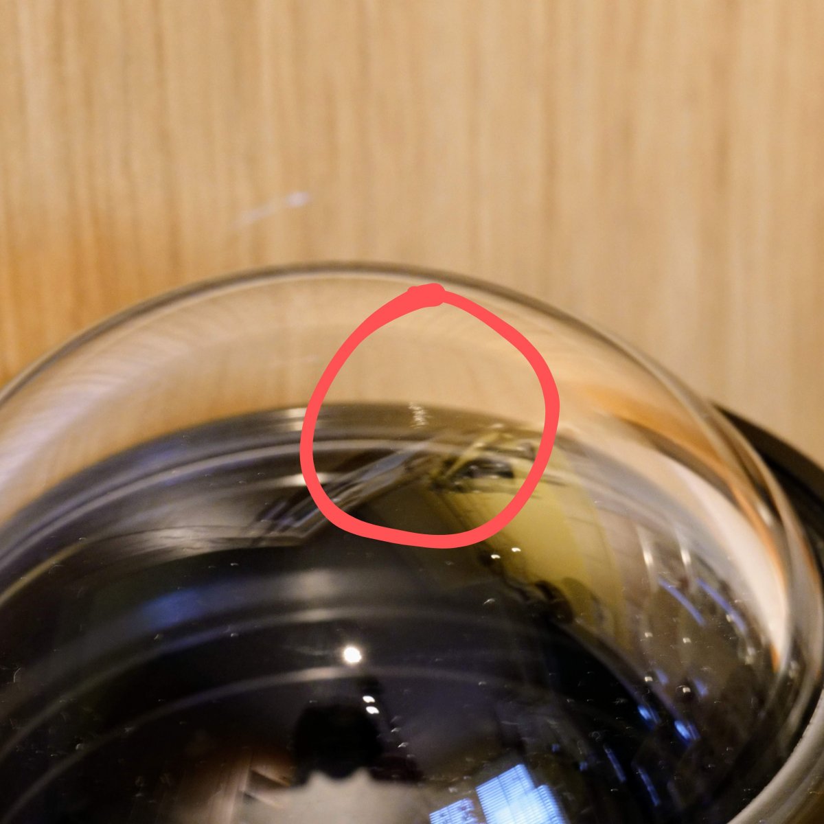

  1. 1 hour ago, davehicks said:
    Get some actual micro mesh.  It's nine grades from 1500 - 12,000.  And why in the world are you using brasso?  Also take off the Hood so you can access the whole dome.
    Sit down with a bowl of water, a few towels, and watch a movie for TWO hours while you go through the nine grades.  It seems like you took a short cut with just three.  And get rid of the brasso, you don't need that.
    https://www.amazon.com/SANDING-SHEETS-INTRODUCTORY-Peachtree-Woodworking/dp/B000H6HIK2/ref=asc_df_B000H6HIK2/?tag=bingshoppinga-20&linkCode=df0&hvadid=&hvpos=&hvnetw=o&hvrand=&hvpone=&hvptwo=&hvqmt=e&hvdev=m&hvdvcmdl=&hvlocint=&hvlocphy=&hvtargid=pla-4584345024990910&psc=1
    Read my post. I wanted to see if the technique (used by the guy in the youtube video) worked.
  2. 1 hour ago, Isaac Szabo said:
    Though I certainly had better results than yours, I was never fully satisfied with my results using things like micromesh, brasso, etc. My domes were usable afterwards but not perfect (still a tad hazy). More recently I purchased an inexpensive ($70) benchtop buffer and got near-perfect results (and with so much less effort). Just be sure to use a soft buffing wheel and a compound made for plastics if you go this route, and obviously keep the dome moving (buffing the same spot too long could lead to problems).
    Worth a try. Thanks for your input!
    But why? There are 7 pages here over several years with people explaining how to do it properly.  Why follow some youtube bozo?

  5. With acrylic, i have found the 3 steps chemical, a great solution, glass is another whole thing though

  9. I've tried to rub toothpaste in circular moves. Never worked, I'm doing any good?
  10. Acrylic?
    I use Novus and it works.
    Deep scratches will be visible to your eyes but will be invisible to your lens underwater.
  11. DP-100 glass minidome. Scratch removed with toothpaste and a microfiber cloth.
    Any special toothpaste?
    Nope, Sensodyne if memory serves. Just put on a movie, apply a pea of toothpaste and get scrubbing with your microfibre.
