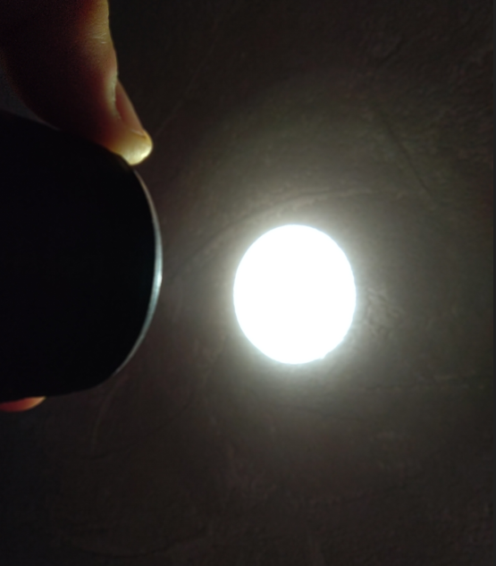

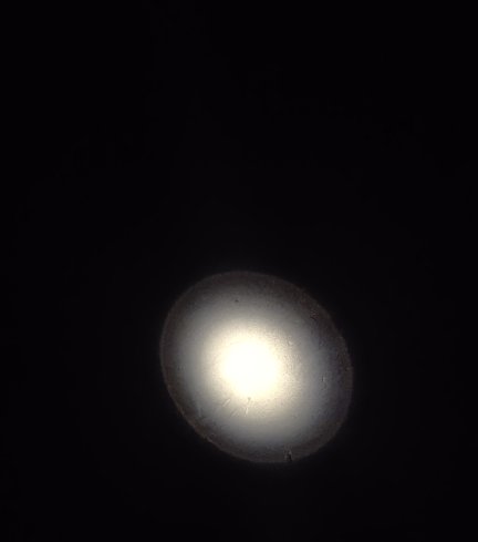

This in a photo with the retra snoot on one of my retra,
My question is if this will be seen or not on the "real" underwater photo
This is with focus point on the light
you can see that the light is not uniform

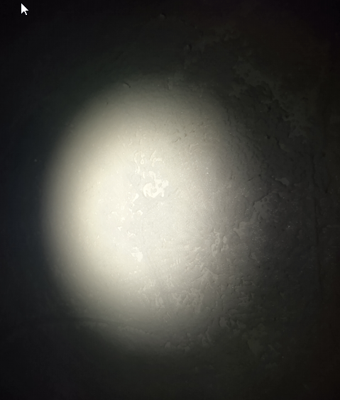

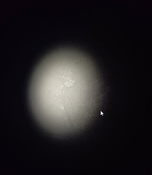

With my poc snoot
The light is much more uniform
The edge are smooth

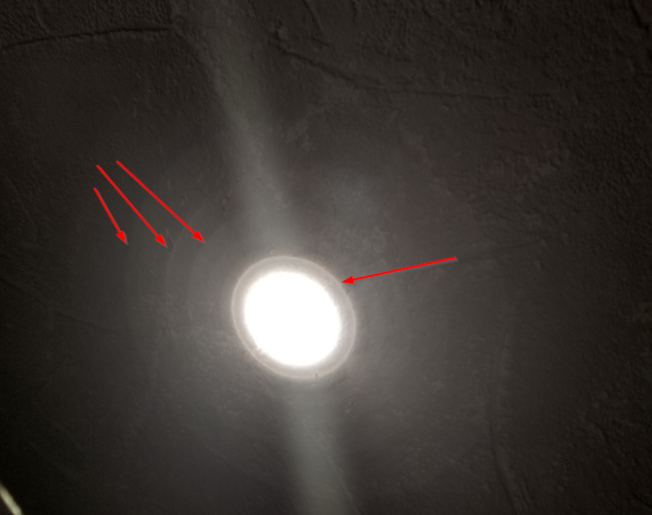

for this picture I putted a small extension
The main light point have a really sharp egde
There is a big zone arround with some lite light
But you can see that I have no reflexion, rings of light

Interesting images in your tests, Hugues.
I can only say I’ve never noticed any reflections or anomalies underwater that have had a noticeable impact on images. Some images of course are rubbish but that’s more likely my fault rather than the gear. I’d suggest that the underwater environment is much more almost forgiving in the way potential anomalies appear. There are so many other issues which impact that they rarely (never?) show up in the final image.
I wouldn’t worry too much over what your tests are showing. (But maybe that’s just my suck it and see approach!) Get the snoot in the water, shoot some images and see what you’ve got.
The only “technical” issue I’ve experienced is that of aligning the focus light with snoot output. That was very difficult with the Inons but not an issue with the Retras. After that I’ve always felt anything else was down to the guy pressing the shutter. 😉
