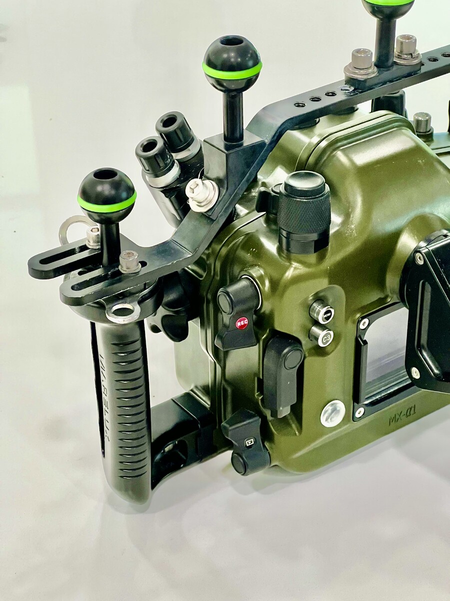

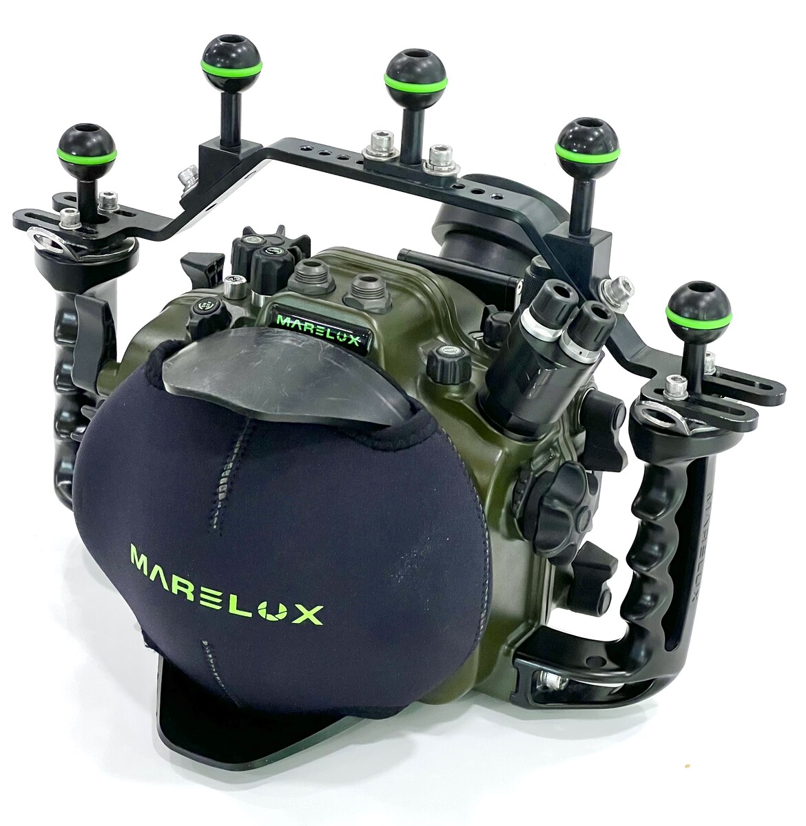

I have attached photos of the M24 UWT trigger mounted on the Marelux Sony A1 housing. I had to reverse the direction of the current crossover bar because it hits the trigger and can't be secured the grips. Reversed it slightly blocks the vacuum valve and as a result I could use a manual vacuum pump but not the power vacuum pump. After adding a grip extension and moving the bar to the left I am now able to use the power vacuum pump.
The A1 housing is advertised to be 126mm deep while the Canon R5 housing is advertised to be 149mm deep so each housing is going to be different regarding the crossover bar installation.
Also the new housings like the Sony A1 II have an M24 that is tilted outward about 15/20 degrees and this may help.
