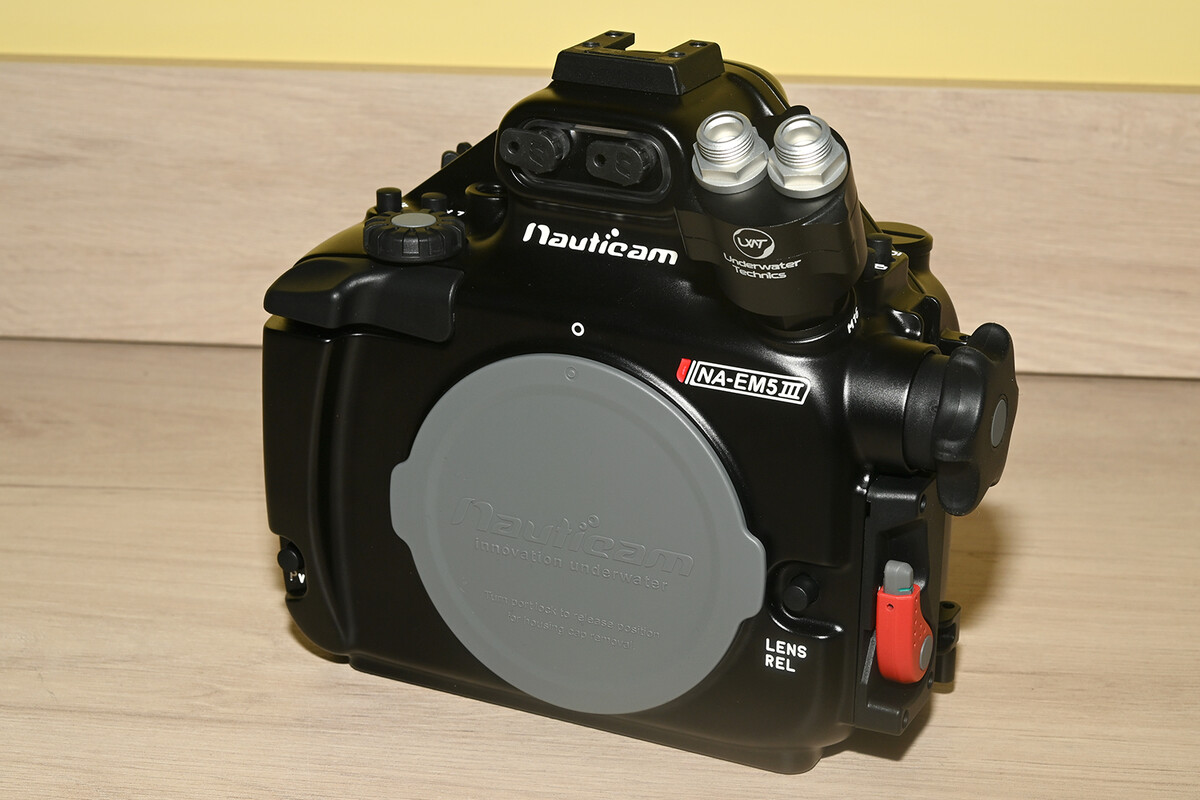

Factory produces the following versions of the External TTL Converter for OM System / Olympus:
  • M16 for Nauticam, Marelux and Seafrogs housings,
  • M24 for Marelux, Seafrogs aluminum housings,
  • M16 for Ikelite housings,
  • 1/2"UNF for Ikelite housings,
  • M16 for Isotta housings,
  • M12 for Seafrogs polycarbonate housings.

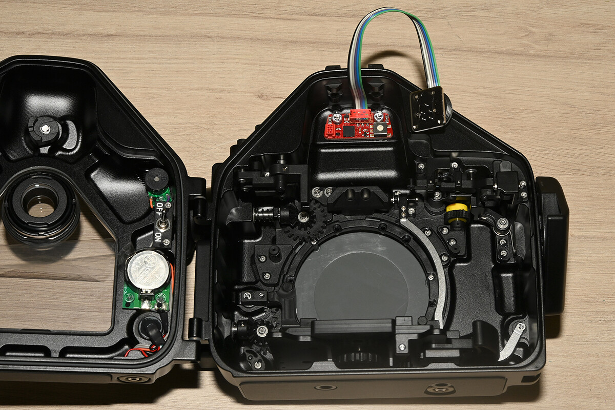

The following versions of the Internal TTL Converter for OM System/ Olympus are in production now:
  • for Nauticam housings,
  • for Isotta housings,
  • for Marelux housings (will be announced soon).
