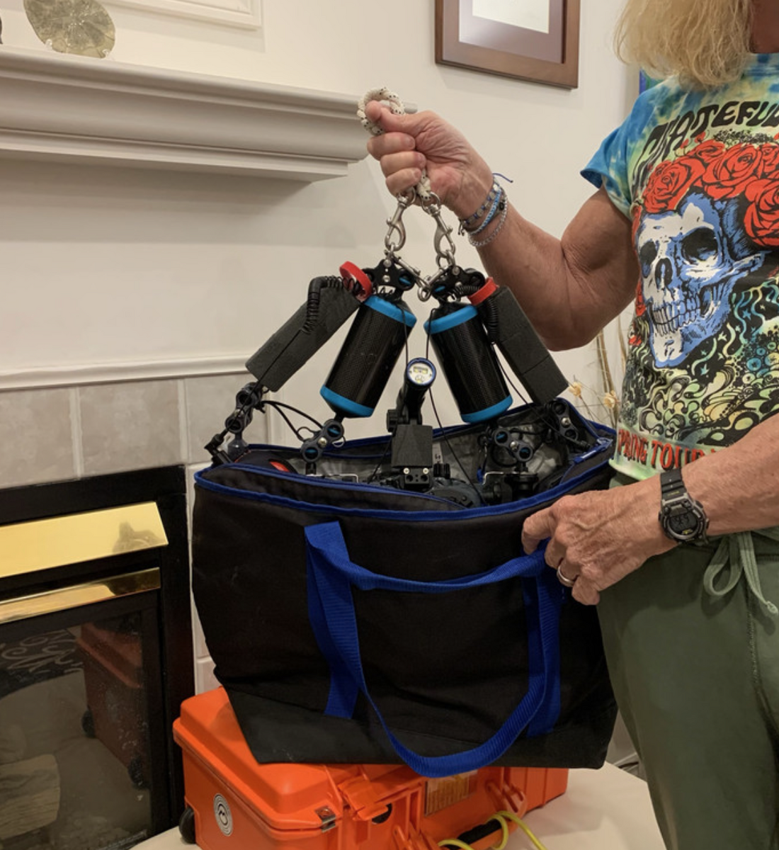

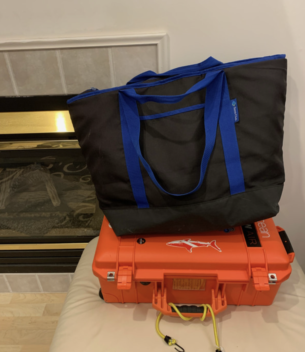

I have been using the Sam's Club bags, often well under $10. One of them lasted three years including a Red Sea Trip. I left it last trip in Roatan with left over new in package food items, soaps, shampoos my wife had bought and did not use that the room service lady wanted. Got another plus a spare. They will take my Sony NA6400 or my Canon NA-R50 and Inon S220 strobes rigged and zipped and will hold water for a rinse if needed. They are light, fold flat and are inexpensive enough, that they can be just left if need be.
