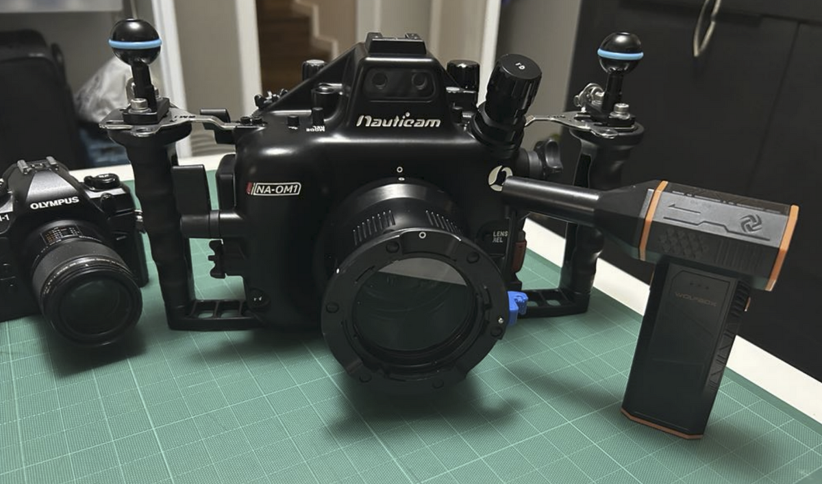

  2. Almost any flat port will have 67mm threads, the issue with mounting Nauticam wet optics which mount using bayonet is the Nauticam bayonet adapter needs to fit. It has 67mm threads but has an inverted u-shaped channel with the M67 thread on the inside of the inner side of the U-shape. They have a bar which fits into cutouts of the front section which prevent the bayonet mount rotating. This u-shape need to straddle the front of the port so if the port front section is too wide it won't fit. The pic below shows the front end of a Nauticam flat port, the red arrows show the width of the front end that the U-shape channel needs to fit over.
