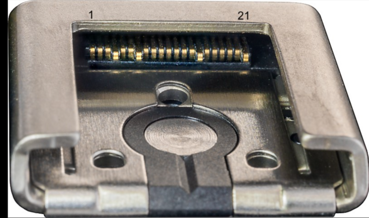

  8. These fine wires will be quite fragile. It looks like a bare copper wire - no insulation so I'm guessing it attaches to the ground of the hotshoe - the metal around the outside - the silver piece attached with 3 screws. You could take off the screws for the hotshoe and have a look - as Dave says you might be able to re-solder it - or if it was attached to the and you aren't skilled in soldering it might be possible to clamp it under the metal part of the hotshoe assuming this is where it came from. I very much doubt Nauticam would repair, they would want to sell you a new one. Looks like yours in a manual trigger board where the connection is soldered. An alternative would be to but a new bulkhead cable and solder it on as there's only two cables needed - see this pic of the other side of the board. If you could source a 2 cable manual hotshoe cable you could remove this one and solder it on. If you don't have the gear or soldering skills any competent electronics repair store could solder it on. Bu probably simpler to solder the cable up at the top end.

  20. Have you tried shooting in manual? In most cameras this only requires a connection between the centre contact and the hotshoe frame and only needs to close the circuit- it doesn't need to transmit data like the TTL connections, so should have a greater chance of working.
