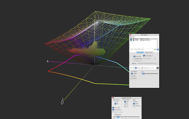

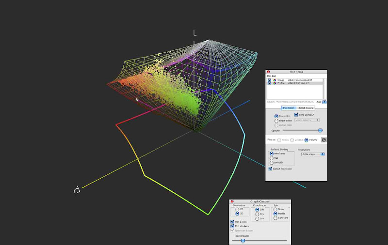

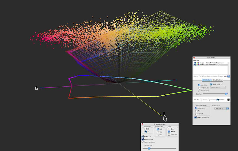

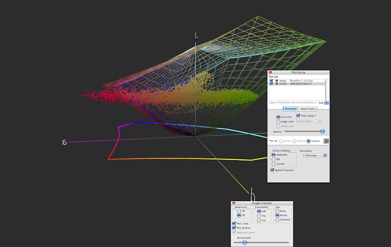

  2. These are Jeremy's pictures loaded consecutively into ColorThink for gamut analysis and plotted with an sRGB frame overlay. First the sRGB original TIFF, then the sRGB HDR, then the ProPhoto original TIFF followed by the ProPhoto HDR.
    Clearly taking an out of gamut image to start and then doing HDR results in even more out of gamut information when you try to view it again on an sRGB monitor. Just another pitfall with HDR and I thank Jeremy for pointing it out.
    Two things I take from this; do an out of gamut check before doing HDR if using Prophoto or AdobeRGB and convert to sRGB first if there are significant areas outside of the sRGB gamut - at least for web use
    For printing HDR it may be important to look carefully at your printer / paper profile and checking gamut issues when choosing and then using AdobeRGB or sRGB most of the time.
    With present output devices, it may be more trouble than it's worth to use Prophoto at all.

    The Gamut warning will show out of gamut only if your Proof Setup is for a more restrictive gamut than your ProphotoTIFF. Most likely the original TIFF even though in Prophoto is still within your Proof Setup choice, but then when you do the HDR there is just too much information outside of your Proof Setup Gamut.
