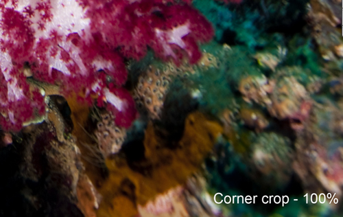

    With both lenses my standard ISO is 200 in order to get enough light to allow me to work at F-8 and smaller in most scenarios.
    This shot was pretty low light though ... F-6.3 at 1/25th second.
    Here's the full shot:
    Here's the corner detail:
    If everything had been along a single plane, the corner performance would have looked better, but this is pretty typical of the kinds of set-ups we find on the reef.

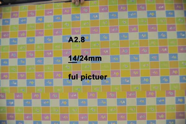

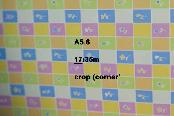

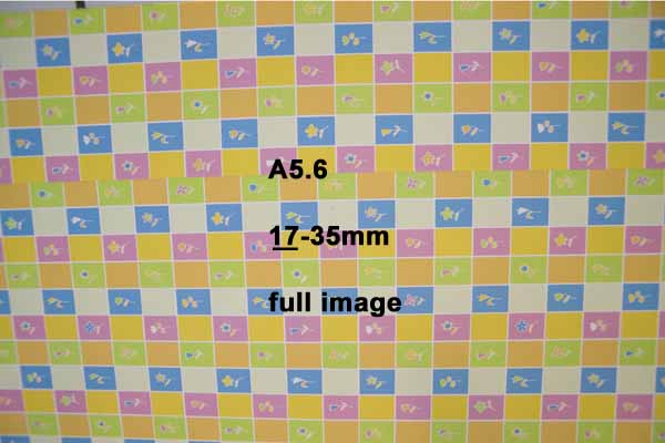

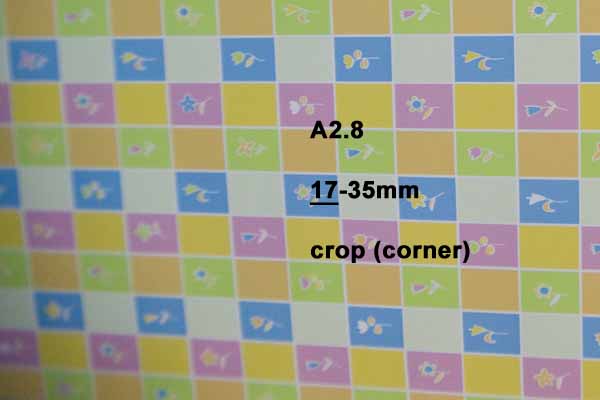

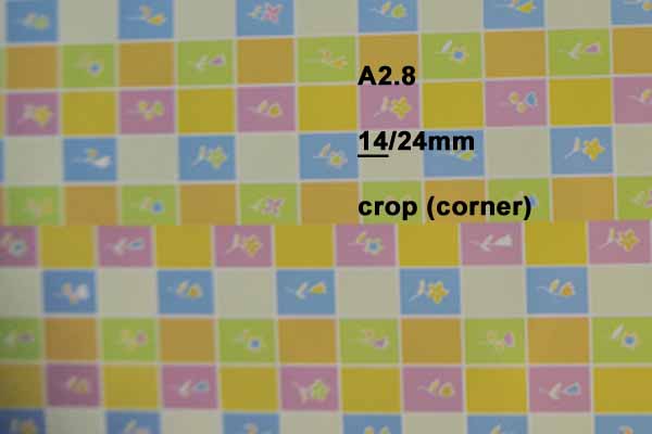

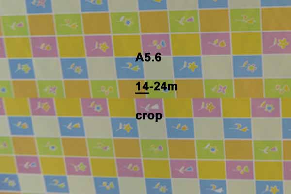

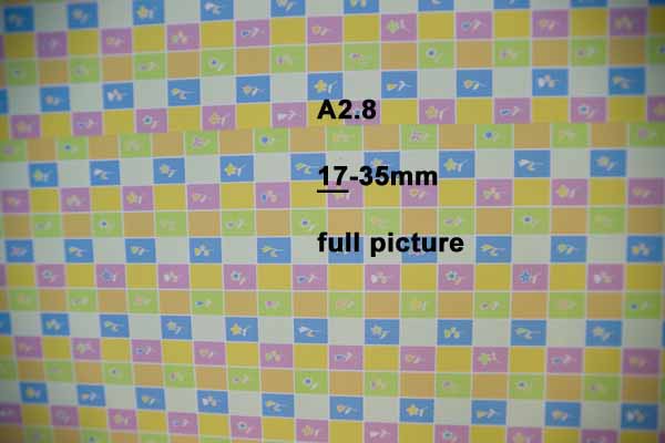

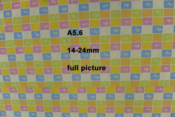

  18. Yesterday I have been comparing the 14-24 mm lens with the 17-35 mm (both without diopters). I was surprised by the difference. I think the 14-24 has less unsharpness in the corners than the 17-35mm. I know that a 17-35mm performs better with a +4 diopter, but than I loose sharpness in the middle. And I will use this lens with people in swimmingpools and I think for me (read: for ME) that is more important than unsharpness in the corners. All pictures were made very close to the board (1 foot), so I think (don't know for sure) that the prestations would be better from a little bit more distance (I forgot to try that, can anyone agree this? or is this a misunderstanding?).
    here are my results and decide yourself what you think about it!
    (sorry, instead of F (of aperture) I used the A (of aperture....)
    Edited by kaarlin
  19. I disagree that there is significant loss of center sharpness with a dioptre (+2 or +4), at least on the 17-35. When I started using the 17-35 a dioptre was needed for consitent focusing behind the dome, corner sharpness was a welcome but secondary benefit. If the center is not sharp, it probably will not focus, at least if you are using the center as your focal point. The 17-35 may work without a diopter behind a dome, but I'm pretty convinced it works better with one.
    Karin, I find your patterns difficult to read, something with more contrast would be better. Also the target does not appear to be held parallel to the sensor plane.

  20. Hi loftus
    I agree that this aren't the best pictures but I wanted the subject to be flat so the whole subject is the same distance away from the camera. For me it is visible that I can work with this lens for my poolshots. I doubt if this lens is usable on a reef. Alex told me that another option is to use the sigma fisheye with 1.5 teleconverter. Unfortunatly I don't have these lenses so I couldn't compare this one
