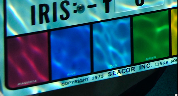

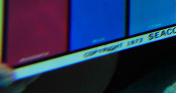

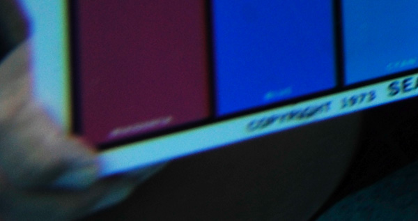

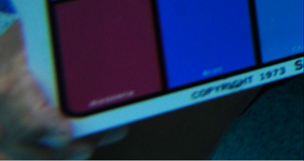

    I have to say I am shocked by how badly the 17-35mm performs behind the Seacam super dome, even with a dioptre. Especially as the 12-24mm performs so well behind the same dome/dioptre combo.

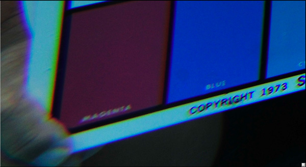

    Just as a comparison here are 100% crops of edge sharpness from my tests of the 17-35mm at 17mm with a tiny 4" Subal dome. Note this is a different dome to the tests I posted above
    And there is no doubt that the corner sharpness is much better with the 4" than you are getting with the super dome. Now I know that the Seacam Superdome is good and much better than a Subal 4" dome - so something is going wrong here. Maybe your 17-35mm is mis-aligned lens or there is a slip in focus in the testing (I know how much work doing these tests is - it is easy for the focus to lock on the background just as you press the shutter). I can't believe it is the Seacam dome.
    Anyway here are my tests. Both way open at F5.6 and both at 17mm behind the tiny Subal 4" dome (no CA correction or sharpening applied). They are 100% crops from top right.
    This one +4 dioptre:
    This one no dioptre:
    Alex

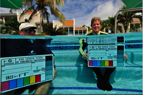

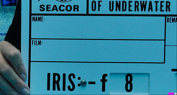

  8. 17-35 More:
    Here's the best I could do with Seacam Superdome, PVL45, full shot, 100% center, and 100% lower left corner. Almost ALL of these tests I've been doing are sharp in the center, btw. I've only been testing for ultimate corner resolution.
    No diopter, this is the best of PVL 25, 30, 35, 40, 45, 50, and 55:
    Edited by StephenFrink

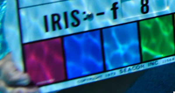

  9. Here are the diopter tests, showing full view (which I had to back up for, because diopters reduce wide angle coverage, the greater the diopter the greater the angle of view reduction), the shot taken from same distance as no diopter picture (note how many bars of color on color chart are lost as a result of adding diopter), and the 100% corner crop.
    Here is B+W +1 diopter:
  10. +2 diopter:
  11. +4
    Again, all are sharp in center, whatever port extension, whatever diopter.
    I've avoided any editorial comment, preferring only to show the results, obtained as empirically as possible, and invite one to make own conclusions. All I'll add here is that if I was shooting full frame Nikon and looking for a wide angle zoom, I would consider the 14-24 very favorably, at least based on results with Seacam superdome and PVL 50.

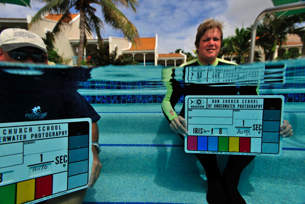

  16. Clearly Stephen Frink is NOT maintaining a constant distance from and a constant angle with respect to his subjects in his 17-35mm lens tests. This can be clearly seen because the target slate for even the "center" lens area varies in size from frame to frame between the "no diopter" view and the views with the various diopter strengths. The position of the woman holding the "center sharpness" slate is inconsistent to the building structure behind her. And how close the slate is to the edge of the frame varies.
    All these factors, I believe are contributing significantly his conclusions, which I believe may not be correct. Particularly the conclusion that the various diopters are resulting in significant variations in the angle of view of the lens at 17mm.
    To get a really valid comparison of the lens with the different diopters, EVERYTHING else needs to be consistent. It would be better to simply hang the slates along the edge of the pool, not have them held by people who are clearly changing position from picture to picture. And when taking the pictures, make sure that you keep the center of the image really centered on the "center sharpness" slate and the far edge of the "corner sharpness" slate at the very same position in the corner of the frame.

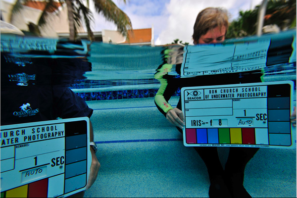

    PLV 55
    PLV 50

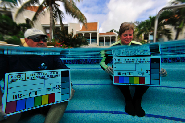

    The other factor I had not realised was so significant was the loss of coverage, both in air and underwater, caused by using dioptres (as a percentage it is a very significant difference). It was a good idea to shoot splits so both can be seen simultaneously.
    No dioptre:
    Same place with +4:
    I think that this was a failing in my tests. I did not use a tripod to fix the camera position, using just a weight on the floor of the pool to line myself up. I didn't notice any change in coverage - but I could have easily "corrected" for this just by rocking backwards and forwards on the spot to keep the same corner points in the frame.
    As your tests show - when the frame size is normalised - the dioptres improve corner sharpness with both lenses that can taken them: 12-24 and 17-35mm, but that normalising is hiding a considerable cost loss of frame coverage caused by the dioptres (seen on the 17-35mm examples above).
    If dioptres cause such a reduction (as your examples above clearly show) I can certainly see much motivation for not using them. Their positive effect on corner sharpness seems irrelevant in comparison. It is embarrassing that I missed this factor in my own tests. Since the effect can be seen on land I am tempted to unpack my cameras (off to Indonesia for 4 weeks) to see it for myself.
    Thanks for the educational postings - maybe I need to come on one of your workshops!
    Alex

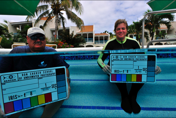

  18. Just to show how significant the reduced coverage caused by the dioptre was I have overlaid (inverted) the non dioptre shot. I think this shows Stephen's point "the greater the diopter the greater the angle of view reduction - note how many bars of color on color chart are lost as a result of adding diopter" very graphically.
    Now I think that there was a little camera movement between these shots - as I had to skew the image slightly, but there is no denying that the dioptre cuts coverage by a large amount.
    Alex
