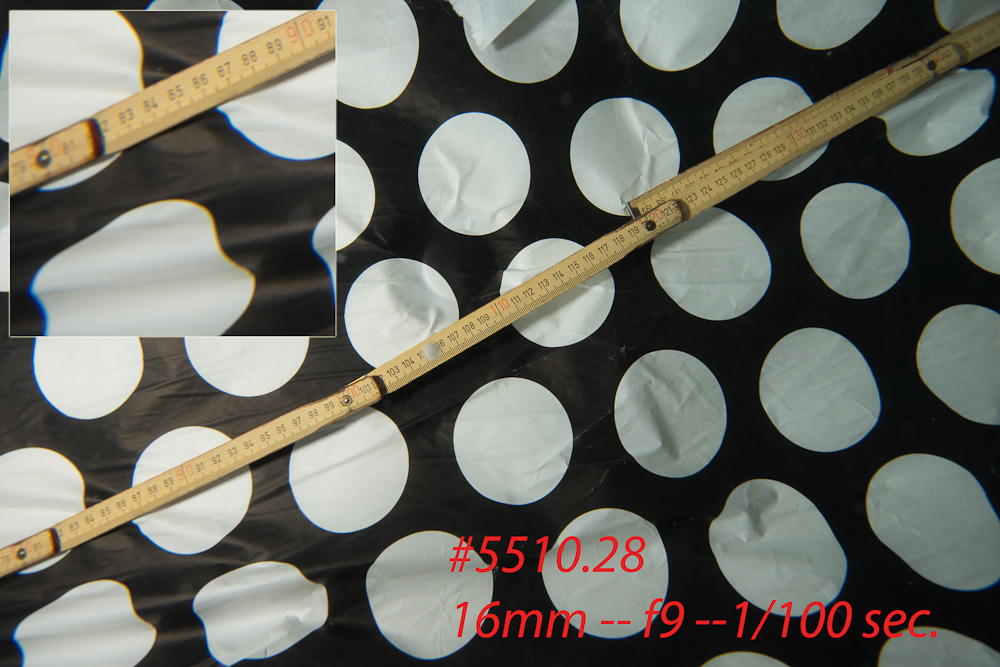

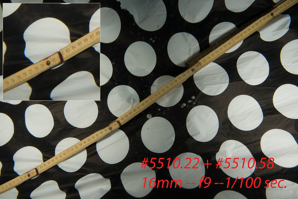

  9. By the way for Ikelite users. I think the port recommendation for the 16-35mm is completely wrong.
    I calculated by myself based on the nodal point and port radius and found out the port should be arround 2,5 cm further away from the camera. I will try to go to a pool on sunday and proof that.
    As I said, I think one inch less cannot make it so bad.
    /René
  10. Hi,
    I made my tests with the dome positioning and found out it works much better with my calculated Dome positioning.
    Every Ikelite user with the Nikon 16-35mm and the 8" Dome should not use the #5510.28, but the #5510.22 + #5510.58. With that combination the port is further away from the camera. The angle of view is wider, the corners are much sharper and there is no vignetting anymore. Especially at f4 you can clearly see the difference.
    It´s still not perfect, but much better and at least usable. On the last pic I made an exmaple with f14 and there it looks pretty good.
    Here you can find all the pics at f4 and f9 and judge by yourself:
    http://uw-digi.de/dometest/
    Regards René

  13. Every Ikelite user with the Nikon 16-35mm and the 8" Dome should not use the #5510.28, but the #5510.22 + #5510.58. With that combination the port is further away from the camera. The angle of view is wider, the corners are much sharper and there is no vignetting anymore. Especially at f4 you can clearly see the difference.
    Very interesting, Rene. What are the the approximate total lengths of the port extensions in the two examples?
    Alex
  14. Thanks for that Rene. Where does the front lens element sit in relation to the dome port?
  15. Very interesting, Rene. What are the the approximate total lengths of the port extensions in the two examples?
    Alex
    With the #5510.28 (recommended by Ikelite) it´s 70mm (2,75") and with the #5510.22 + #5510.58 it´s 90mm(3,54").

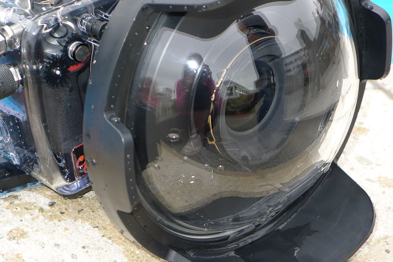

    I´m not sure if I understand your question correctly. I based my calculations on the entrance pupil (nodal point). The distance between that nodal point and the dome is equal to the radius of the dome (in my case 4").
    You can look also at the attached pictures:
    Before:
    After:
    René
  16. as you can read in that post I realized that DOF is much smaller with the D800 compared to my former Canon 7D Crop camera and I had some problems doing Macro (Supermacro). I guess that´s not changing when I switch to DX mode? As holidays are gone for this year I won´t be able to try.
    No difference to DOF if you shoot the D800 in DX mode. But you end up with a v. small viewfinder image if you do.
    Alex
  17. OK; that's what I thought. I think another way to get in the ballpark, rather than calculating nodal point etc is to place the front element more or less flush with the entrance to the dome. At least with Nikon most 8"domes are designed for the 16mm with the front element flush. In the before pic your lens sits quite far into the dome. Probably not as accurate as calculating nodal point, but probably a good starting point when choosing lens extension.
