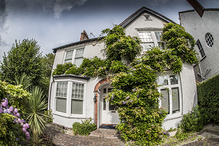

  3. Alex, I took a picture of the front of my house to compare D700 and D800. Alas, the weather changed the moment I took the first shot (D800). However, tell me if this amount of noise at ISO400 is what you would expect from the crop. I know it's difficult to make these judgements from compressed jpegs over the Internet. If the clouds clear, I'll do it on the D700. (15mm Sigma - my house has straight walls!)
    Edit: I rushed out later and took another with the D700 while the lighting was similar although the sun had moved round. EBC files are on the D700.
    Well, I think that proves it!

    Hi John,
    Yep, that is about what I'd expect. Visible noise, but unintrusive. Both the new Nikon's I have tried D4 and D800 give noticeably more noise in underwater shots.
    I'd expect your D700 to have much less detail but to be clean from speckles at ISO 400 and ISO 800 at a 100% crop.
    But, of course, on the final printed page the D800 will throw away some of its detail and most of this noise and actually end up looking marginally better than the D700.
    Alex

    I wasn't attempting to take an award-winning picture. (Do I ever?) I just cropped a bit of sky to reduce lens flare!
