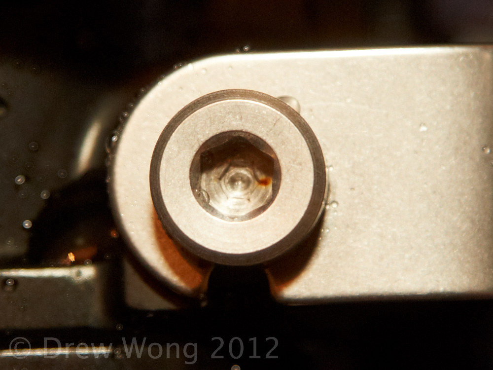

  12. Unfortunately, my Nauticam NAD800 is already showing signs of rusting. 3 NAD800 housings here and one rusting, being the one most used in water... daily for 9 days!
    Another 2 NA7D (about 7 months old) housings here also have rusting view finders. More evaluation is coming.

  14. Unfortunately, my Nauticam NAD800 is already showing signs of rusting.
    What state are the two sacrificial anodes in?

  20. What state are the two sacrificial anodes in?Tim
    Those were fine. The problem areas are isolated from the main body's zinc nodes. The viewfinder is surrounded by acrylic and thus the different metals start corroding very slowly. The other area from my experience with Nauticam is the handle plate area attaching to the main housing, notably the bolt and the plates. This is an ongoing issue with the brand. Nauticam's Edward Lai replied that the issue stems from the supplier's bad qc on quality of metal. Thus not every housing has this issue and it's obvious from the popularity of the housing, most don't see it as a major issue and a bit of molylube or some sort of contact resistance seems to alleviate the problem. That and vigilance makes it less of an issue.
    For me, it's more an annoyance more than a major issue. Other brands also have corrosion issues at some point but it'd be nice if Nauticsm made this less of an issue.. It certainly doesn't deter buyers. In fact I'm selling the housing and camera already to a very happy buddy of mine after I finish up my stint in Africa.
