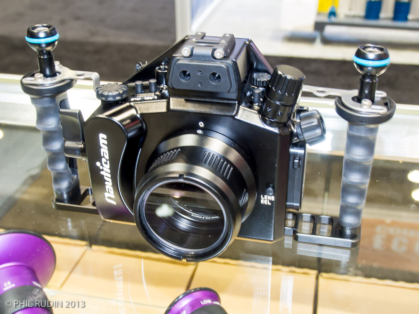

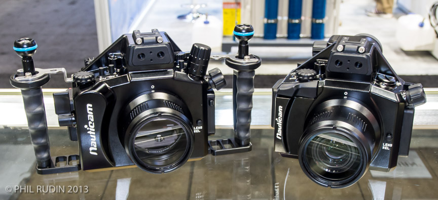

  9. The housing should be in retail stores before the end of the year.
    The size difference between the E-M5 and E-M1 is a non issue to me. Since the grips are integrated into the housing the width is about the same as an NA-EM5 with tray and grips. This also allows for a vertical rather than horizontal shutter release which works extremely (big plus to me) well while using the right hand grip. The pictured housing has the vacuum system installed. This housing will ship with the vacuum system electronics already installed. The valve is additional cost and allows for several choices. The photo has the base valve, a valve that allows you to install a sync port for wired strobes, HDMI out, can also be added. A new read rear window for 45 & 180 degree accessory viewfinders is also coming. Price point should be between the NA-EM5 and Nauticam DSLR housings for APS-C cameras.

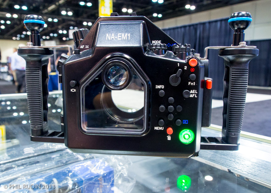

    The rear view of the housing shows the vacuum system at the ready, green light. If vacuum begins to be lost the light will flash amber and then go to red when the vacuum is lost. The red light and audible alarm will not go off until water is actually detected in the housing. This system is NOT a replacement for the routine maintenance for your housing. It does however give another layer of security and I believe will be quite common in all housings in the next few years.
    First image Nauticam NA-EM1 housing left and Nauticam NA-EM5 housing right. This is the a prototype housing at DEMA and some small Tweaks my be made before shipping.
    Phil Rudin
    Edited by Phil Rudin
  10. Thanks for the info and pics. I think I am going to have to wait and look at them but there is hardly a difference in the size by the looks of it, cost could be the factor.

  12. The grips are designed to sit flush with the bottom of the housing and they can be removed, this allows the housing to sit very stable on its bottom. The housing also has three tripod mounting points on the bottom so a tray could be attached. You also have the extra plates at the top of the new grips for added support. You can see in the photos how stable the system sits on the counter top. The handles can be moved in and out for bare hands or heavy drysuit gloves. Also note how nicely spread out the controls are on the right rear of the housing even though additional functions have been added to this housing v. the E-M5 housing.
    The only buttons which can not be accessed are the two on the front of the camera near the lens which control depth of field preview and custom white balance. These can be reassigned to other function buttons if needed.
