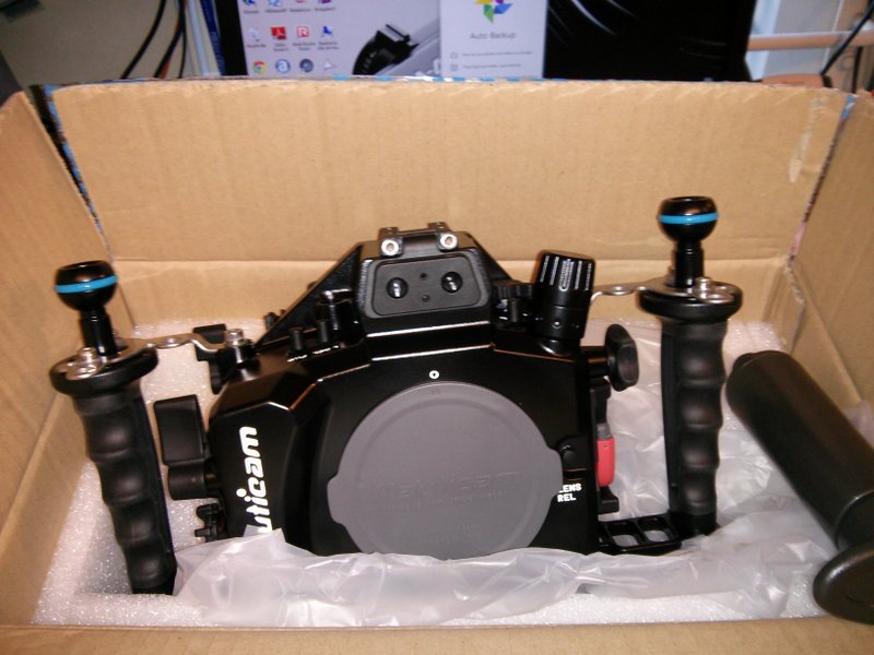

    I ordered the camera and 12-50mm. Next the housing and geared port.
    BarbaraJ will continue to use her INON 240s.
    Oh yes, its a birthday present for her.

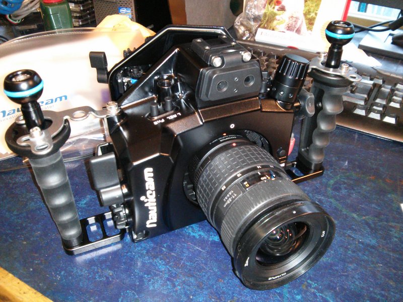

  4. Look what's arrived (thanks Alex)
    Of course I still need a crucial part!
    The 43 adapter is on the way...
    Trying to work out a good button mapping or two. Luckily the EM-1 supports 4 "My Sets" (preset configs) so should be able to get the camera quickly into the correct setup for different styles of shooting. Any more tips on good workable button mappings much appreciated - I like Phil's tip to put focus on the AEL lever.
