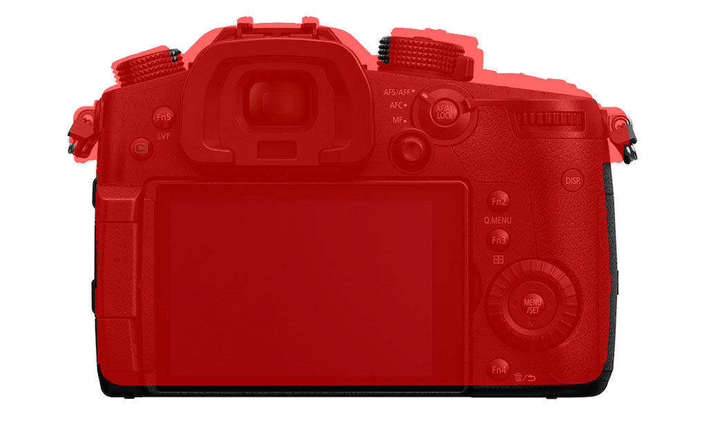

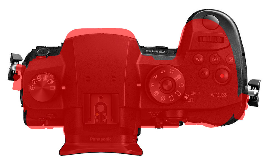

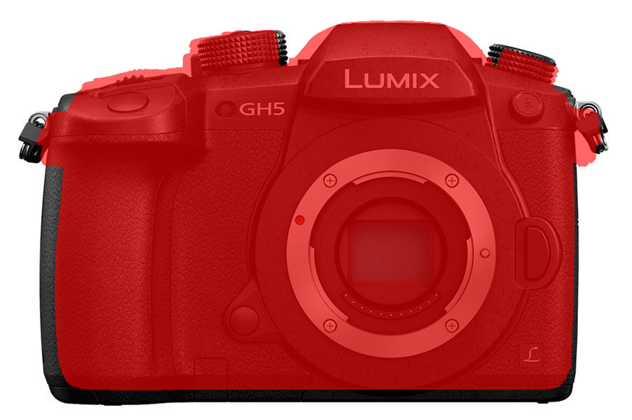

  4. Oh and btw, would all/most of the buttons work on the gh5 in a gh4 nauticam housing?
    The housing door won't even close if you tried the GH5 in the GH4 housing (if we are talking Nauticam) as the GH5 is thicker (and about 10% more in volume)
    Regards - Richard
  5. The housing door won't even close if you tried the GH5 in the GH4 housing (if we are talking Nauticam) as the GH5 is thicker (and about 10% more in volume)
    Regards - Richard
    Damn, that's a bummer (just looking at pics I thought they looked decently equal)
    Sent from my E5603 using Tapatalk
  6. Here are the GH5 overlaid (in Red) the GH4 - as you can see the GH5 is quite a bit different in all aspects
    (Aligning to Mount)
    (Aligning to EVF)
    Aligned to Hotshoe
    Edited by thetrickster
