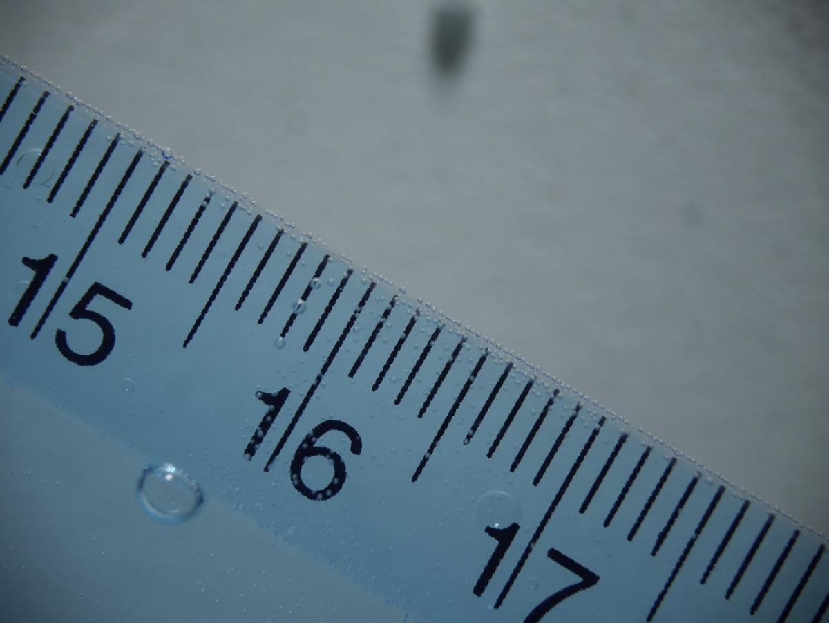

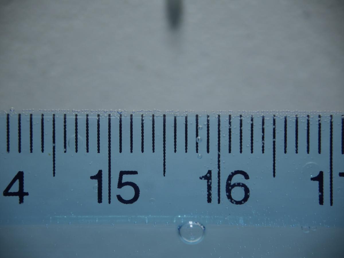

  14. Those are two shots with PZ-14-42mm at 42mm end and Inon UCL-100 on the GX7 for the GH4 you are looking at 26mm horizontal after 4K crop and 1.5cm height
    For me this is already very small
  15. Do you remember what distance you were at?
    Interesting to compare that 26mm horizontal with my Olympus 12-50mm. My minimum subject to fill the frame (in air, in 43mm macro mode) was about 25mm at about 4cm distance without any diopters.
    Looks like, in general, Panasonic PZ-14-42mm/+10 diopter is in the same ballpark as the Olympus 12-50mm as a combination that gives you reasonable macro and a bit of wideish angle too. Oly may give a little bit more magnification but doesn't have any stabilization on a GH4 body.
    With any combo of +5 and +10 diopters on the Oly 12-50mm I could fill the frame with about 20mm at 1cm distance. Hence I decided not to bother taking them as the extra magnification is not really worth it on that lens.
    Edited by Nick Hope
  16. I didn't take detail measurements but it was quite close around 4cm from the front of the diopter. I use the 14-42mm with wet wide angle lenses and with the gx7 ex tele mode I can get around 18mm width. This is a much better working option as with the UCL100 or any +10 diopter you are limited between 7.5 and 4 cm outside this range (at least at full zoom) you have no focus at all. So am thinking about this lens only for stills. For video I am planning to use the weaker UCL-165 as it works from 14 to 7 cm which makes the lens worthwhile using and with ex tele I can zoom 2.4x more. If I had the GH4 I would be looking at two 6 stacked with this lens. Obvious with another lens like the 12-50 is completely different and a single plus 10 looks more interesting. I think the 14-42 is the most versatile lens of all for video due to the power zoom and the fact that is stabilised but more important for me it takes wet lenses so I can almost use it as a camcorder as I can zoom through from 100 degrees to 85mm with flat port for portraits and then with a diopter can get into macro
