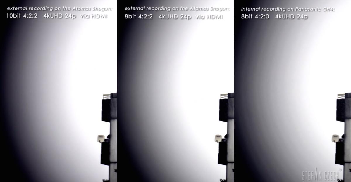

  10. There is a great review of the Shogun from a 'Stefan Czech' -
    http://vimeo.com/stefanfilm/atomos-shogun#t=1423s (GH4 part starts at 23:43mins)
    And a good example of the benefits of 4:2:2.
    Edited by thetrickster
  11. I really don't see the GH4 getting internal RAW video (I mean I would love it thou!) when its bigger brother the X1000E doesn't do it either, and that has twice the processing power.
