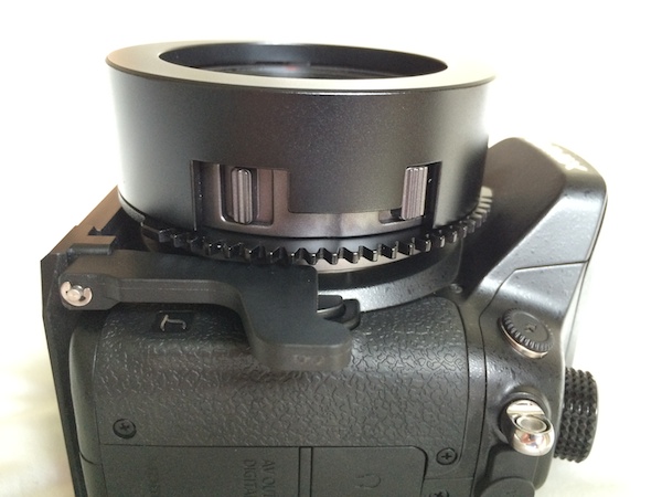

  1. Peter - or anyone that has the zoom gear for the 14-42PZ - can the zoom gear be adjusted to operate the focus switch instead of the zoom switch? If that is the case then the zoom can be accomplished via the menu dial (after assigning the zoom control to a function button).
    Out-of-the-box, you could not do it with the Nauticam gear as-is because everything is precisely aligned to move the zoom control without moving the focus control. But you could modify it. But the gear is metal (aluminium?) so it'd require some careful cutting. You would have to cut the zoom slot wider and glue some something on to slim down the slot around the focus control. You can see what I mean from the photo. The focus switch is on the left and the zoom switch is on the right.
    But, even after you had that done, I'm not sure that the focus control wheel on the housing, coupled by internal gears to the lens gear, would be precise enough to make the fine focus changes required for macro.
    And, IMHO, I'm not sure what problem it would solve. I had no problem doing auto-focus-lock on any tiny part of the subject then moving the camera as required. The Pinpoint AF is very precise and easy to see what is in focus. With a larger monitor, like the Shogun, it'll be even easier.

  5.
    I've only had a brief look, but it appears the 12-35mm fits in the flat port for the Oly 60mm.
    Close but no cigar...
    It fits without the zoom gear. With the zoom gear, the lens is a bit too fat to get into the port tube. Almost fits. If I hit the camera with a hammer, it might just squeeze in. :)
    So, yes, you could use the 12-35mm in the Oly 60 port but only set to one focal length for the whole dive.
    Regards
    Peter

  18.
    Regards
    Peter
    What about fitting the 12-35 in the special Nauticam 12-50 port? It's got a 77mm thread, so I'm assuming it's wider than the 65mm macro.
    Without the special 12-50mm gear, it's $450--only $150 more than the 65mm macro port. http://www.backscatter.com/sku/na-36161.lasso
    Of course, it would mean getting the 77mm flip diopeter instead of the 65mm, but if it works with the quality of the 12-35, it might be a good trade-off.
  19. What about fitting the 12-35 in the special Nauticam 12-50 port? It's got a 77mm thread, so I'm assuming it's wider than the 65mm macro.
    Unfortunately I don't have that port to test the combination.
