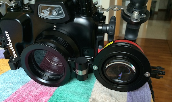

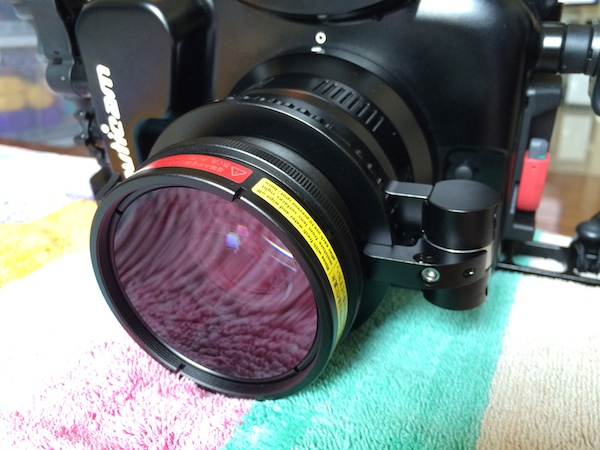

  10. So here we go: Just spent 45 minutes blowing bubbles at the bottom of the pool.
    In summary: I am happy! :) I can do macro. Lembeh, here I come...
    Lens: Panasonic 14-42mm PZ
    Port: Nauticam Macro Port 35
    Nauticam Flip Diopter Holder
    Inon UCL-100 Diopter (+10)
    Here is an iPhone snap of the setup:

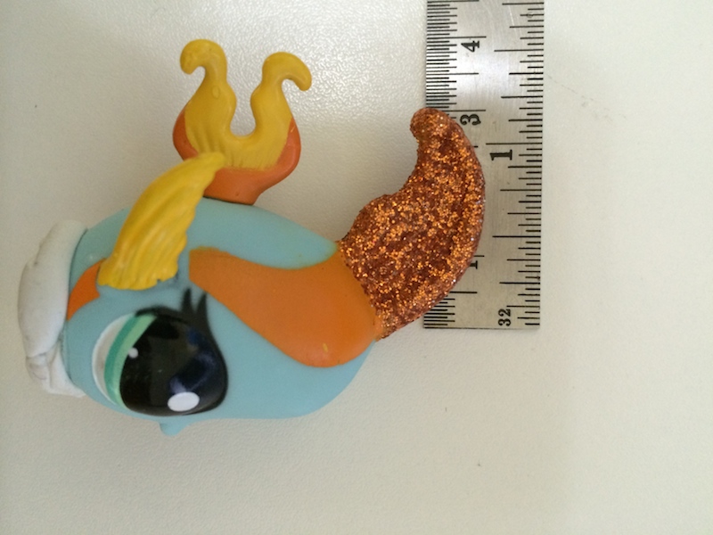

    To test the setup, I borrowed a couple of "littlest pet shop" toys from my daughter. I weighted the toys with a fishing weight and stuck them down with blue tack. Here is the "model" with a ruler to give you an idea of size:
    The camera performed very well while taking the shots. I mainly used the "pinpoint AF" method, but I tried others and they all seemed to work. Pinpoint enabled more aiming precision as it magnifies the area around the pinpoint. I used AFL if I wanted to move the camera to change the focal point away from the centre. The GH4 found focus every time, as long as I was within the right distance - not too far when using the diopter (approximately <0.15 meters) and not too close when just using the lens without the diopter (approximately >0.3 meters).
    I imported the footage into FCPX. I made no edits or adjustments.
    I have looked at the footage every which way and can not see any issues. I have displayed it in full screen mode. Looked at the corners. No problems that I can see.

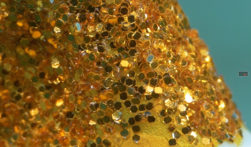

    To show you, I have taken 4 screen-shots of the FCPX viewer screen.

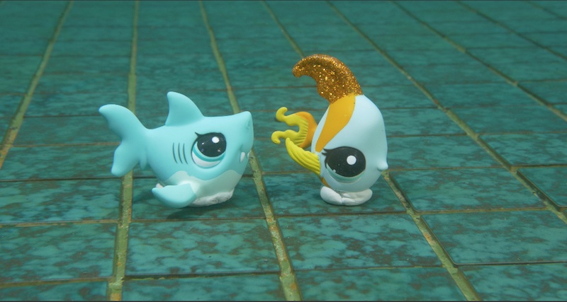

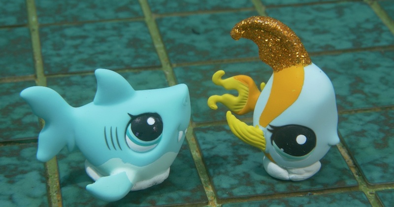

    1. The two subjects taken without the diopter with the 14-45 set about 30mm - the subject is about 1 meter from the camera. The image is a bit soft as it was raining and the pool water was quite murky (about 5 to 8 meter viz).
    2. The two subjects taken without the diopter with the 14-45 set quite wide - the subject is about 0.4 meters from the camera.

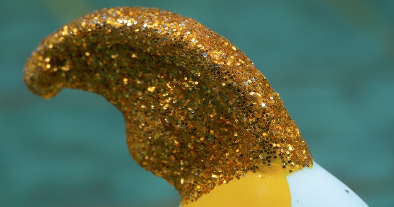

    3. The upper fin of the gold fish showing the whole frame when using the Macro diopter and the 14-45mm set about mid-point.
    4. The upper fin of the gold fish showing a 100% crop of the 4K frame when using the Macro diopter and the 14-45mm set about mid-point.
    It seems to have handled every test that I tried.
    I reckon that I am good to go.

  11. So here we go: Just spent 45 minutes blowing bubbles at the bottom of the pool.
