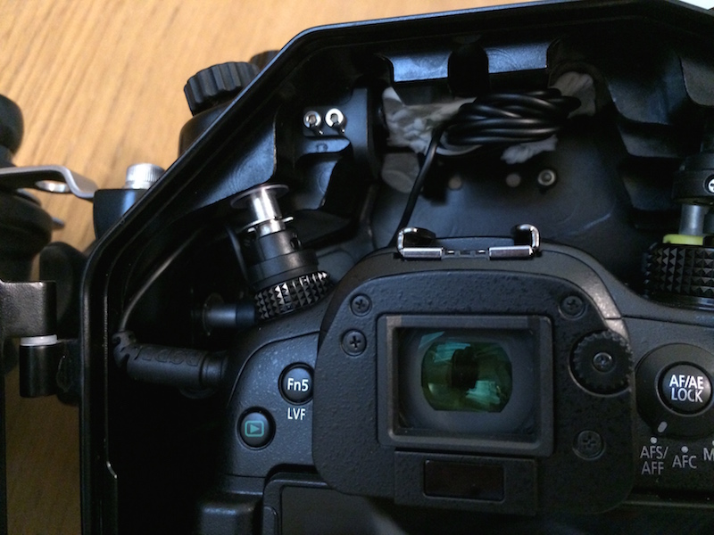

    So, I have setup my experimental, internal-to-housing hydrophone.
    After looking at a few, I bought this microphone:
    Cost about $50 USD here in Singapore. It is marketed as a Lavalier mic for use with iPhones (there's an app for that). Rode has a good reputation (made in Australia) - I figured that they wouldn't damage their reputation by selling junk.
    It works OK with the GH4. I did some quick comparisons and the sound quality is better than the inbuilt GH4 mic but not as good as my $500 shotgun mic. Of course, for $50, you can not expect high-fidelity --- but recording underwater sounds is not about fidelity.
    The mic does fit into the housing. The jack just squeezes into the gap between the housing and the camera. Tight fit but the cable protector bends a bit. It doesn't affect the alignment of the camera or the o-ring housing seal - passed a 30 minute vacuum test.
    The microphone head, without its clip and wind sponge fits nicely up in the top corner of the housing up above the internal arm of flash pop-up lever. That lever is helping hold the microphone in place (I never use flash). The mic head is surrounded by lots of blu-tac, holding the face of the mic firmly up against inside wall of the housing. It's not going to move. The blu-tac also stops most airborne sound from inside the housing reaching the mic. The only sound reaching the mic comes through the housing wall. The cable, looped tight with a couple of cable-ties, is held out of the way in the empty space above the camera's flash.
    It works - in that it is picking up sound through the housing. The camera's display is showing that audio is being received from an external mic. I've set the camera to manual volume control (which switches on the meter display), so I might need to tweak the input volume then lock it into my underwater custom settings.
    Will it record decent sound underwater? I will let you know when I'm back from Lembeh next week.

  8. The "housing hydrophone" that I described above worked well in Lembeh. It's picked up all the usual underwater sounds (breathing, bubbles, shrimps and crabs, boat engines) and recorded a clear, bright stereo audio track in my GH4. Not bad at all for the price.
    Sent from my iPad using Tapatalk
