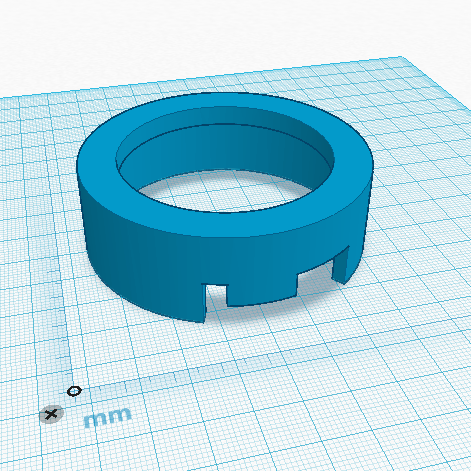

  13. After having a look at the current zoom gearing, it looks like it will be super easy to make it work with the focus switch.
    The issue with this gearing is the springs - its quite a clever solution from Nauticam, if you're happy using the zoom gearing as a basis for the focus gearing, all that needs to be replaced is the top part (see photo) which I've redone for the smaller focus switch.
    Will get the printer warmed up this weekend and get one printed and see how it works.
    Ultimately a complete solution not using the zoom gearing would be good - but for now, this will do!

  19. Progress on the modified zoom gear. Once I had taken it apart. I realised the amount of effort Nauticam put in to it!! It's taken 3 trial prints to get this fair. Only thing concerning me is the wall thickness (in plastic) and the 3 small screws that will hold it together.
  20. 99% there with the focus gearing. Just ran out of time today, positioning screw holes. Thinking Monday its a done deal. [emoji106]
