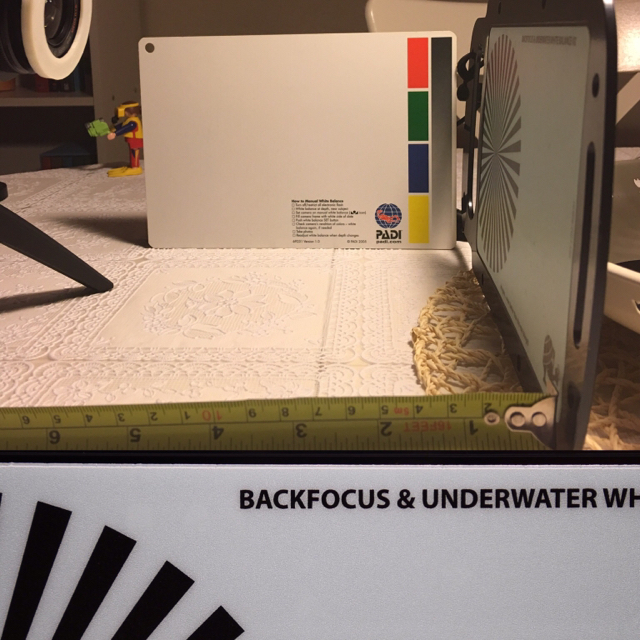

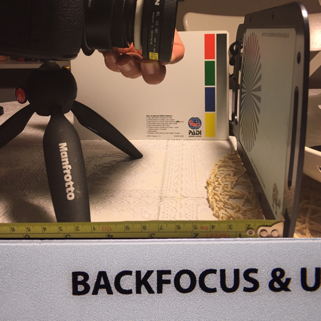

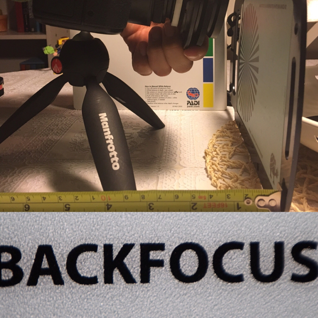

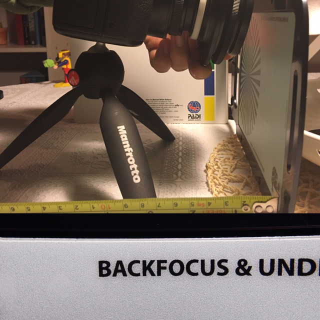

  12. Not very scientific. But here goes:
    At 14mm. No wet lens
    At 14mm with INON 165
    At 14mm with CMC

  13. The Inon lens is +7 on land but reverts to 6 in water. My tests were in water. The CMC doesn't loose power in water
  14. Nice tests Richard. I love my CMC. My Subsees get left at home since I got mine.
  15. I worked out the difference. Working distance on land 22cm in water becomes 29cm equivalent diopter power 3.45 plus Inon lens 6.06 total 9.51 working distance from the back 10.5 cm. I think having an Inon 165 is almost necessary otherwise you have nothing to cover working distance between 7.5 and 16.5 cm. Not all fish can be approached as close as the CMC requires to focus. With the 14-42mm lens other than a small chromatic aberration in corners that gets cropped in 4K the CMC additional power compared to two stacked Inon lenses is only 9%
