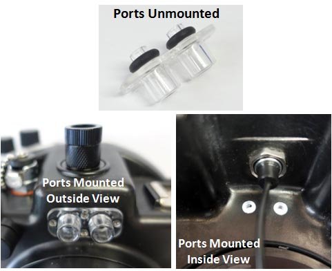

  12. I modified my a7Rii Meikon case for the dual fiberoptic bulkhead connector that comes with the Seafrogs a6xxx Salted Line case.  I'm hoping to interface the UW-Technics converter with it so I can keep the standard synch cable connector as well.
    Edited by davec13o2
    Good job!  And good idea!
    Please advice, where did you buy that transparent spare part? I also need it.
    By the way, UW Technics is developing now TTL converter for Seafrog A6xxx housings. It's LED board is purposed for installation on this transparent part (inside the housing).  TTL converter has LED and Electric outputs, as usual. So, you could more easy use both type connectors (Optical/Electric) on your A7RIII housing, using that transparent part you has installed and Nikonos bulkhead simultaneously.
    Edited by Pavel Kolpakov

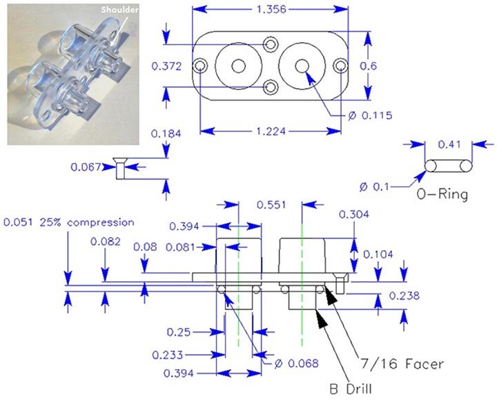

  19. Here are the dimensions I used for milling my case.  Note the shoulder that makes it a bit more complicated.
