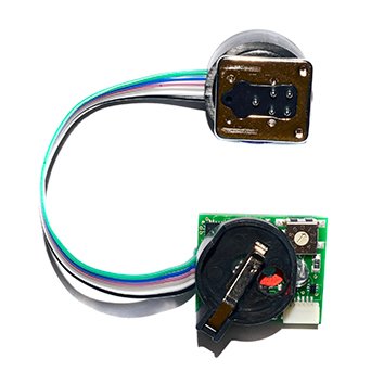

  2. Hello Pavel
    I'm about to get a NIMAR housing for the Canon RP. I saw part number 16024 from UWTechnics, does that work with the RP or just the R?
    The housing seems different, the R has dual fiber optical plugs while the RP housing only has one.
    Regards
    Patric
  3. 4 hours ago, Patric_Ocean said:
    Hello Pavel
    Regards
    Patric
    Hi Patric,
    Yes, Nimar new housing (for Canon EOS RP) has only 1 optical bulkhead, moved to side.
    TTL Converter for it is product #16029 UWTechnics. The circuit board has the same shape as previous #16024, but includes 1 external LED moved to side. The correct picture will be available soon.

    I finally got a Nauticam housing for my a7rIV last week and had the Reef Photo guys install the UW Technics TTL trigger in the housing before they shipped it.
    Test firing it at the house seems to work just fine (for example, using TTL in Shutter priority mode). I'm heading down to Utila tomorrow and will get to really work it out. I have always shot underwater in full Manual mode. But, I'm going to have a go at shooting with TTL and see how that works out for me. For some situations, I could see it being very handy.
  14. @Pavel Kolpakov I'm now in Utila and just had my first dives with this trigger. I am having serious problems. I'm posting here hoping you will see this and tell me what stupid thing I'm doing.
    I'm shooting a Sony a7rIV. My camera does have the latest firmware installed. V1.1, I think?
    I have Inon Z240 Type 3 strobes with optical sync cables. I have been using these strobes for about 3 years and never had any problem with them (as long as I had my settings right). I have 2 cables, each connecting to a separate connector on the housing.
    Today, they strobes were working seemingly randomly. Meaning, sometimes they would fire and sometimes they just wouldn’t.
    I was shooting in Manual, with an explicit ISO and shutter speed always at either 1/125 or 1/100. The camera Flash setting was set to Fill. So, the strobes should have fired every time I released the shutter.
    What I noticed:
    • Sometimes I could clearly see that they did a pre-flash. I don't think they should pre-flash in Manual mode?
    • Sometimes I would release the shutter and they would flash correctly.
    • I had it where I pulled the trigger and it did not fire. I turned the camera itself off and back on and pulled the trigger again, with no other changes, and the strobes fired.
    • At one point, I disconnected one of the optical cables from the camera housing and released the shutter. I could not see any flash from the trigger’s LED. Ambient light was not very bright, so I think I should have been able to see it flash.
    • Whenever they fired or didn’t fire, it was always both strobes working the same - either they both fired or neither one fired, so I’m pretty sure that it’s not a bad sync cable (otherwise, I would have had 1 fire but not the other).
    • I started my first dive with the buttons on the strobes for the “pre-flash” setting locked in the Pressed position, as I thought from memory that that was correct. It took me 10 minutes in the water with no strobes firing before I tried twisting those buttons and letting them pop out – whereupon the strobes started firing immediately. After that was when they were intermittent (i.e. as described above).
    • I switched the camera to Shutter priority and the strobes to TTL mode (and pushed the pre-flash buttons in) and when the strobes fired, I got well-exposed images. But, I *think* (I could be misremembering on this part) that even that way they failed to fire a few times before I finally switched everything back to Manual.
    Thus, I *think* the problem has something to do with the flash trigger itself.
    Got any ideas what is wrong?
    Thanks for any help!
    - Stuart

  18. After several days of emailing back and forth with my dealer (Reef Photo), and trying changing the trigger setting to 0, putting in new batteries, changing it back to 1 (for Inon Z240), as far as I can tell, this trigger does not work right. In full Manual mode (camera and strobes), I finally got it to stop doing the pre-flash, by setting the camera setting for Wireless Flash to WLon. But, it still only fired the strobes some of the time. I verified the problem was the trigger by pulling the optic sync cable out of the housing socket and snapping some pictures - seeing that the optical trigger did not fire. When I tried this and the times that the trigger DID fire, I could clearly and easily see a red flash from the trigger LED. So, when I was snapping a photo and that trigger LED did not flash, it was quite obvious.
    I'm sending the housing back to Reef and will probably have them just go ahead and replace the trigger with the ($200 cheaper) Nauticam optical trigger. I have always only shot in full manual anyway. I thought TTL might be nice on occasion for some specific scenarios. But, 100% reliability is far more important to me than very occasional TTL support. I just dived 6 straight days in Utila and had quite a few good photo opportunities. Virtually every one of them was ruined by not having strobes that worked. It was SO frustrating! I wanted to throw my whole camera rig on the bottom and leave it! A week's photo vacation wasted.
  19. On 2/22/2020 at 4:03 AM, Pavel Kolpakov said:
    Hi Stuart,
    First of all, I advice to change the batteries CR2032 in TTL-Converter to new, to avoid potential problems from this side. After it, check and move HotShoe cable connections.
    On land in comfortable conditions, test the TTL-Converter functionality according the User Manual, carefully step by step. Everything is described very easy there. Pay attention to camera settings and Z240 settings. If you need, here is online version User Manual for #11075 TTL-Converter: https://ru.calameo.com/read/00556083657cf35cf88c8
    If finally you recognized that concrete unit is really broken /defected, please contact manufacturer by e-mail (uwtechnics@gmail.com) or your dealer, for replacement.
    Hi Pavel,
    Thanks for the link to the manual. That did help in that the manual finally showed me where the WLon/WLoff setting is in the camera settings menu. Reef Photo support had mentioned changing that setting, but they didn't tell me the name in the menu itself is "Wireless Flash".
    What I did:
    I put in 2 new CR2032 batteries.
    I changed the trigger dial from 0 back to 1 (for Inon strobes).
    I was shooting with the camera in M mode, with an explicit ISO setting (not AutoISO), WLon, and the strobes set for M mode.
    Like that, it no longer did pre-flashes from the strobes. So, that part was good.
    But, the strobes would still only fire less than half the time. And this was with multiple seconds between shots (and Eneloop Pro batteries). To verify that the problem was with the trigger itself (or the camera, I suppose), I pulled one of the optical sync cables out of the housing port and shot a few photos. When the trigger fired, I could easily see a bright red LED flash from the port on the housing where the trigger LED was. When the one strobe that was still connected did NOT fire, I could easily see that it was because the trigger LED did not flash.
    I conclude that the problem is either the trigger itself or the camera. It's not the sync cables or strobes. And, of course, I am skeptical that it is the camera itself. During my week in Utila working on this, I did remove the trigger module from the camera's hot shoe and reinstall it several times, so I also do not believe my problems are anything to do with not having that connection made properly.
    I have already emailed Reef Photo to make arrangements to send my housing back to them to have the trigger module replaced. At the moment, I'm on the fence about having them replace it with a Nauticam trigger. I have only ever shot in M mode (i.e. no TTL) before, so I don't NEED TTL. I paid extra for the UWT trigger because I thought TTL might come in handy in the future for some very specific cases. E.g. it might be handy for shooting macro, if I ever start to do that. But, reliability is far more important to me than having TTL. So, I'm kind of leaning towards having them replace the UWT with a Nauticam trigger. However, I am open to anyone's thoughts on the subject.
