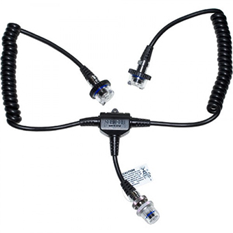

    Meikon A7 series housings have 1 bulkhead of special shape mount. For TTL system user can change it to UWTechnics Optical Bulkhead or Electric bulkhead (Nikonos / Ikelite / S-6), all will be available in Meikon mount version. If you are interested in dual cables usage, i would recommend the following:
    - HowShot Dual Fiber Optic Cable 613L
    - Sea&Sea Dual 5-pin Sync Cord
    - Ikelite Dual Sync Cord
    Inon Double Hole Rubber Bush .... i would not recommend for this aim. It will work, but rubber is not reliable holder for longtime usage.

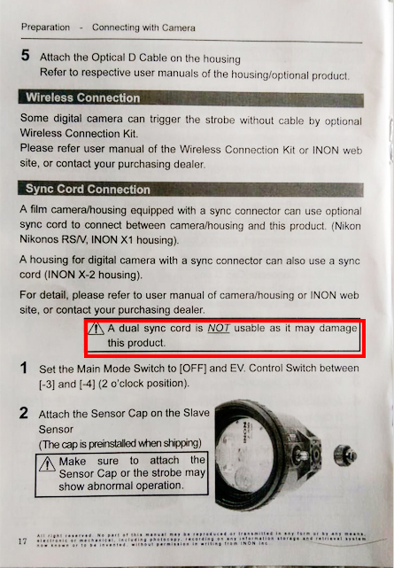

    i may switch to Inon Z330s if Retra are significantly delayed. In that case, it would have to be dual fiber connection as Inon manual states a Y sync cord connection could damage the Z330, although some report successful operation.this way. I would not want to take the chance in case I had to return the Z330 for some reason.

  7. Inon manual states a Y sync cord connection could damage the Z330
    May i ask you please show that page of Z330 User Manual ?

  8. May i ask you please show that page of Z330 User Manual ?
    I can explain what does INON mean there and other details.
    I returned the manual with the strobes to the US seller. I just sent a message to them and other sellers to see if they could copy the page for me or if I could purchase the manual. I’ll be in touch about their responses.
    Maybe someone else on this forum who has purchased Z-330s could help out with the page.
    The US supplier, who didn’t want to reverse the sale, contacted the factory in Japan and were told that they had no solution to preventing possible strobe damage if connected in parallel. The US supplier recommended returning the strobes, which is what I did.
  9. Ok, my friends help me with that page copy.
    I marked the Warning about dual sync cord by red color:
    Electric input type in Z330 and Z240 strobes is identical, pulled up by resistor to +battery voltage. Inon realizes, if one strobe with better batteries has higher voltage on input lines than other strobe in a pair, this influence is not good for electronics. That is why Inon doesn't recommend to connect 2 strobes in parallel directly (without isolation diodes). As electronics engineer, i can understand such recommendation. But in concrete case, my opinion is that Warning is just overinsurance, by the following reason:
    Modern dual sync cords don't have direct parallel connection between 2 strobes. They have isolation diodes /transistors inside, which prevent influence of one strobe to another.
    The same isolation (using transistors) have UWTechnics TTL-Converters on the board. User can connect any pairs of strobes by sync cords, even different type strobes with different supply voltages, it does not matter. This is a system of isolation and safety onboard.
    And of course, user can use Dual Fiber Optic cables.
    For TTL systems the best are 613-core cables (Japanese optical core, 613 fibers inside). It has the best transmission index at our market now.
