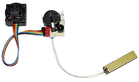

  6. UWTechnics currently produces Optical Bulkhead and Electric (Ikelite, Nikonos) bulkheadfs for Seafrogs housings. Those bulkheads have special shape mount side, the same as Seafrogs / Meikon original.DSC_8919-s.jpg
    TTL circuit for Sony A7-A9 Seafrog housings:
    Edited by Pavel Kolpakov

    This TTL-Converter is purposed for installation instead of Seafrogs leak detector in the housing. That is why, it includes also a Leak Detector onboard, in addition to TTL electronics. By the way, the Leal Detector is better than original.

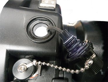

    I modified both the original Meikon case and the Seafrogs NG case (Sony a7RII) for the plastic fiber optic ports in anticipation of using the UW-Technics converter. You need a small milling machine to do the case mod - requires care and precision cuts - not recommended unless you have machine shop experience.  Strongly recommend the UW-Technics bulkhead replacement instead that can trigger 1 or 2 strobes by fiber optic depending on type of exterior rubber bushing.
    Edited by davec13o2
    I definitely don't have the experience nor confidence to embark on a project as intricate as this - kudos to you for such a marvellous job on the housings mate. I'll take your advice and get the bulkhead replacement :)
    Edited by gyrex

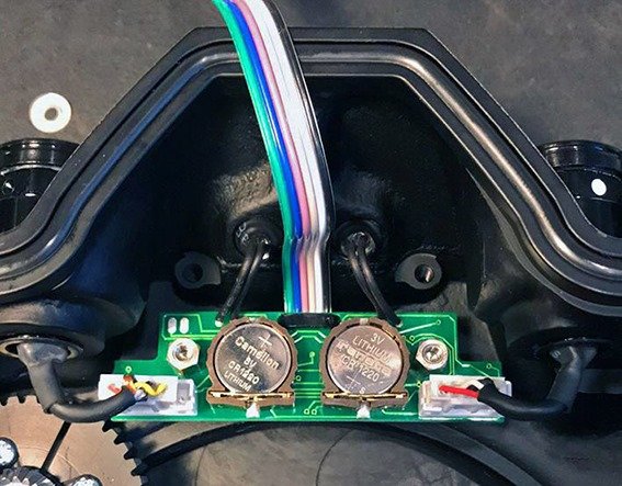

    Here is a picture of installed TTL board for Nexus Nikon (product #11063 UWTechnics):

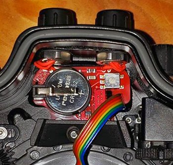

    If you purchase Nauticam for Sony A7-A9, you also can install internal TTL Converter specially developed for this line of housings. UWTechnics #11075 product:

  17. If you purchase Nauticam for Sony A7-A9, you also can install internal TTL Converter specially developed for this line of housings. UWTechnics #11075 product:
    Thanks for the reply Pavel. Excuse my ignorance but does that mean I'd need to buy the Nauticam flash trigger then add this UW Technics converter to it?

    You don't need Nauticam flash trigger this case.  Just install TTL Converter #11075 into the housing.
