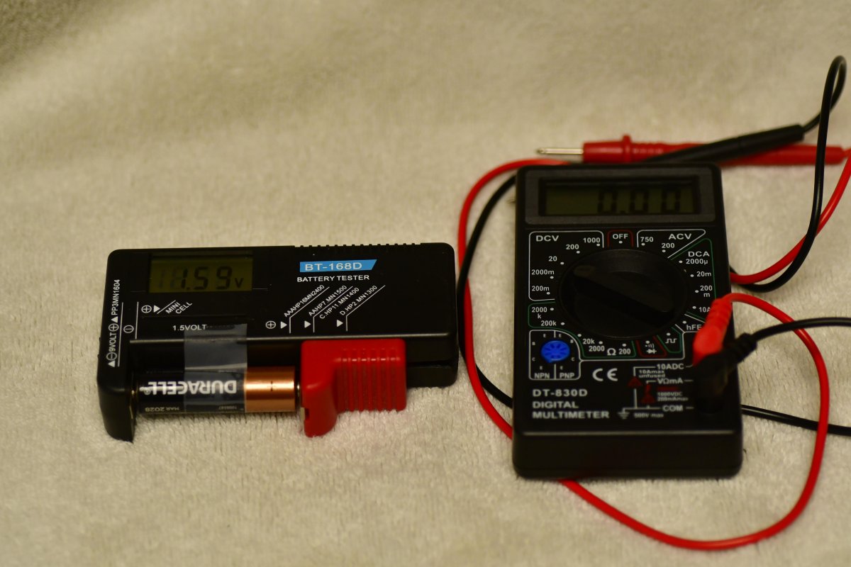

    Is there any way to tell when I need to replace the batteries, short of having them actually go dead?
    Difficult to say for sure, because batteries on the market have different quality. Some of them keep high pulse power (for LEDs) good enough till the end of battery life, some batteries are rather bad in that. In common case, better change them significantly before they are go dead.
    I have a few housings in my own usage. Mainly, i change batteries 1 time per year in them. But i shoot not very often. Anyway, if i go to an important dive trip, i change all batteries in my equipment before the trip, just for insurance.
    Edited by Pavel Kolpakov
  10. Some suggestions to "When to replace a Battery ?":
    a) Start the dive trip with new or fully charged batteries, as Pavel suggests.  Use the best batteries available, they pay for themselves.
    b) Use a digital voltmeter to measure the battery's voltage: If it is significantly below the battery's nominal voltage, replace the battery. One learns quite fast when to replace. Digital VOM's are quite small, light weight, inexpensive and readily available on eBay. Carry one on trips away from home, they can be given as a nice gift at the end of the trip.
    c) It is a good idea to carry spare batteries for the lamps, strobes, camera, vacuum leak detector... Don't forget the chargers.
    If you do not need them, a fellow diver will - great way to make new friends!
  11. Given a typical NiMH discharge curve a digital VM is really not a good way to test AA batteries. Better to use a pulse load tester like the one from ZTS. With a voltmeter you might be at only 10% capacity and not know it.
  12. My UT trigger uses CR2230 batteries, not AA/AAA. This is consistent with the moisture/vacuum alert system in the Nauticam housing. They are inexpensive enough to just replace if there is any doubt.
