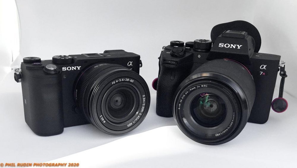

    Camera size compared to the Sony a7R IV and the aging FE 28-70mm zoom.

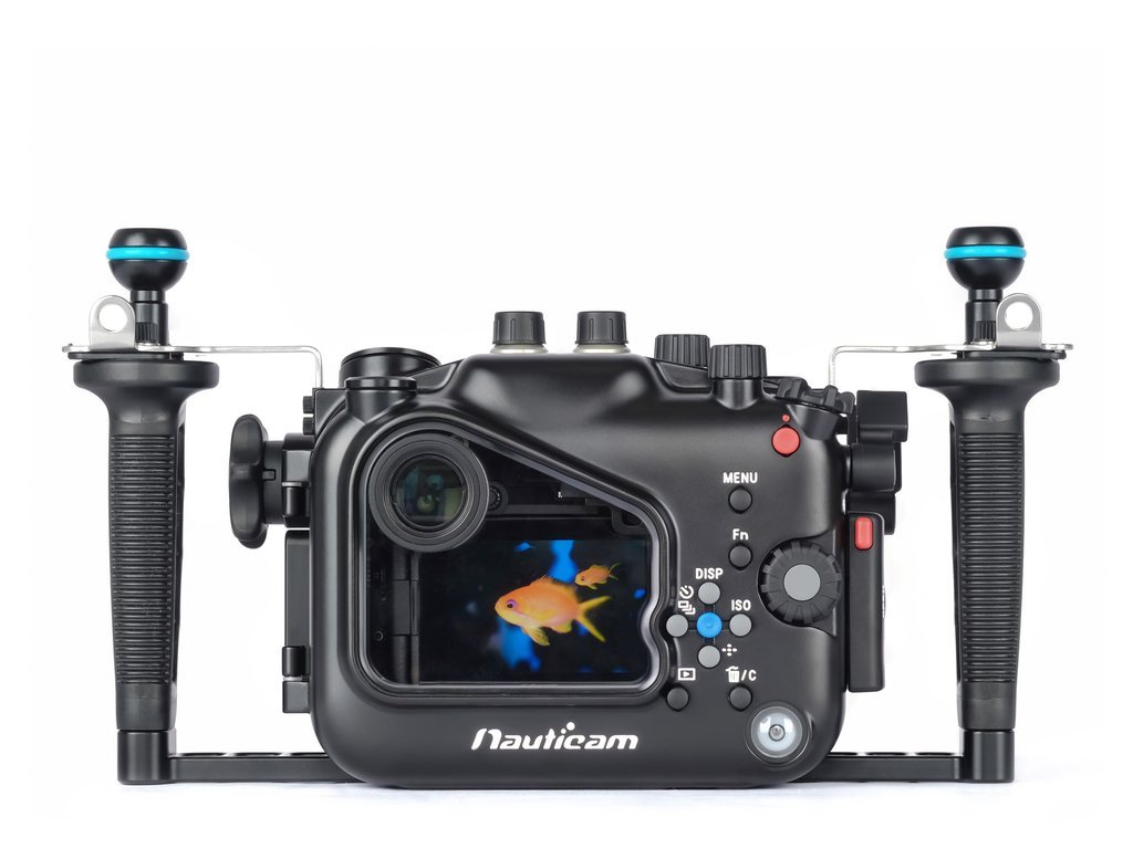

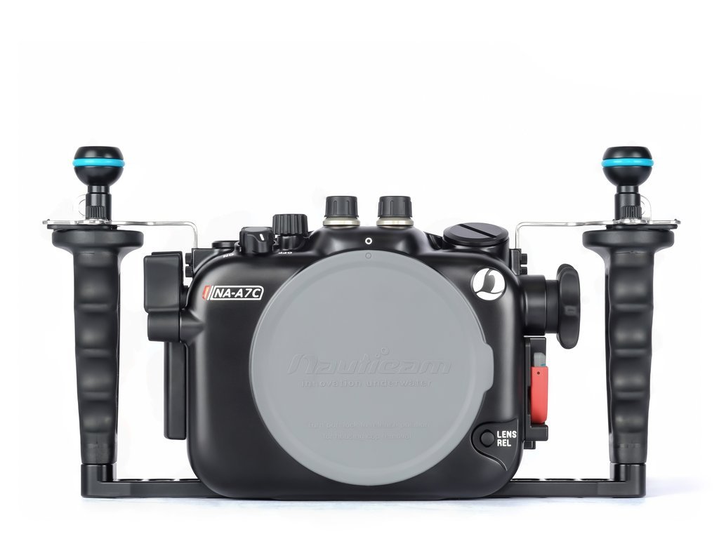

  2. Information and photos for the Nauticam NA-A7C housings have now been added to the Nauticam web page in the Sony housing section. It is about the same size and weight as the Sony A6600 APS-C camera housing.

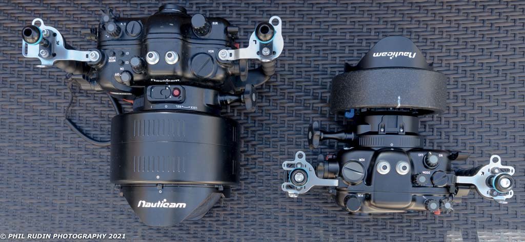

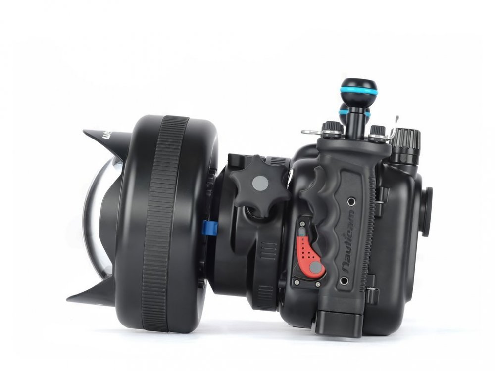

  17. Attached is a photo of the Nauticam NA-A7C housing with the original WWL-1 next to the original Nauticam NA-A7R IV housing with the WACP-1. Keep in mind that the A7R IV housing was the smallest (before A7C) full frame housing on the market and that A7R IV boosts the largest number of MP's with a 35mm sensor. Also notice the placement of the second M14 mount on the front of the housing. The M14 for the vacuum valve is on the rear door of the clam shell type housing. The clam shell styleA7C  housing with rotary cam  lock is also a first for a full frame housing.

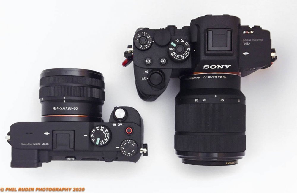

  18. Great development to see the overall size decrease. After a few strong & unexpected current during diving in Indonesia, I'm sticking with a small(er) rig. Yet coming from an aging Oly Pen, I'm unsure what would be a proper successor. And preferably for an aging land camera at the same time (Nikon D80)
    Phil, on your second photo from the top (topside view) it appear the A7C has only a very small "grip depth" when used on land. How is your experience in that regard? Can you wrap a hand around it properly?
    In addition to the cost aspect, I'm eyeballing the Nikon Z50 for that reason. (with option to add a WWL) From what I read on the Nauticam website, this Sony A7C housing is just slightly small than the the Nikon Z50, correct?
  19. The A7C has the newer Z battery so it has a grip about the same size as A7R IV, not quite as deep but I have no problem holding it and I have big hands.
    Nikon Z-50 and Sony A7C is hardly apples to apples because the Z50 is an APS-C camera and A7C is full frame. The Nauticam Z50 housing cost $2672.00 US while the A7C housing is $2586.00 US. The Z50 housing uses the same N100 ports but it is 328mm X 172mm X 120mm and weight is 2.5kg. The A7C housing has the N100 port mount and is 307 X 172mm X 103mm and weight is 1.78 kg.
