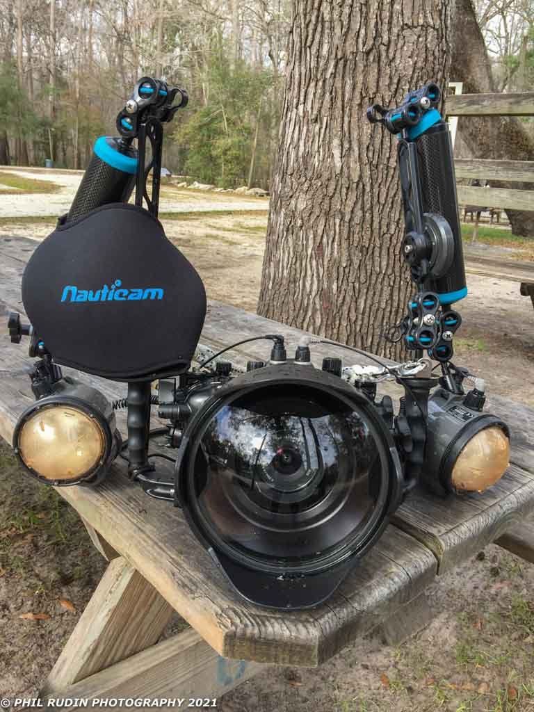

  3. I used the Nauticam 70 X 200mm float arms with the WWL-1 and CMC-1 and they seem to be the best fit buoyancy wise.
    Mermaid with WWL-1 and equipment photo is with the Nauticam 180mm dome port, Inon Z-330 flashes.

  10. To be clear the mermaid photo is with the Sony A7C with the 28-60 kit lens and the Nauticam WWL-1 at 32mm.
    The A7C with the Nauticam 180mm dome port has a 40mm extension and is being used with the Tamron 17-28mm F/2.8 zoom lens. Nauticam supports this lens with zoom and focus gears. For best results Nauticam recommends the 230mm fisheye II dome port.
    I also used the Rokinon 18mm F/2.8 & 180mm port without any port extension. List lens is not listed on the Nauticam port charts.
