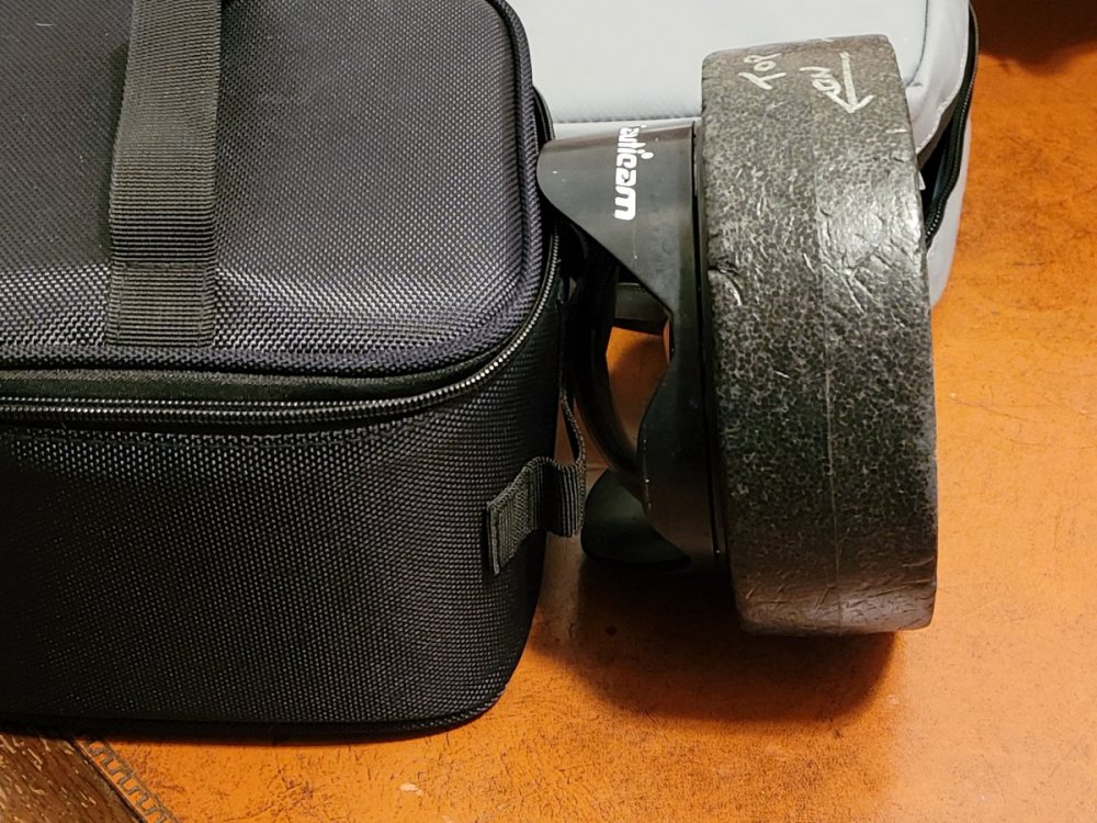

    I saw the new WW-1B with the Alu buoyancy collar. It's so huge that I think after few dives it will be completely scratched. Any feedback?
  8. For what it is worth, WWL-1 and WWL-1B are identical apart from the addition of an aluminum buoyancy collar on the B version. There is a foam buoyancy collar available for the WWL-1 which is important, although a pain with lighting!

    The aluminum collar on the WWL-1B is actually smaller than the foam one for the WWL-1. I have one of the latter and it seems to be surviving fine?
  10. Thank you @adamhanlon it's a shame that the foam collar it's rated 50m only. What do you mean "a pain with lighting"?

    Do you (or anyone?) have a photo that would show how the WWL-1 with foam buoyancy collar and WWL-1B compare size-wise? I'm curious to see how much bigger the one is than the other.
    Good question!
    When I saw it, I thought, "This will get scratched just by laying it on the boat. Especially for me who only uses inflatables boats." :crazy:
    Edited by Davide DB

  16. 14 hours ago, Davide DB said:
    Good question!
    I'm a little embarrassed to post such a poor quality photo on a photography forum, but, well, here it is. This is my WWL-1 with the foam buoyancy collar. It does look like it is bigger than the 1B collar. But, it doesn't look like the difference is all THAT much.
    Personally, being always on the hunt for bargains on used gear, were I shopping for a WWL-1, I think I would have no problem buying a used WWL-1 and using the foam buoyancy collar, if it saved me a couple of hundred bucks.
    Me too. Bargains first!!! :man_in_love:
    Looking at the scratches on your WWL-1 I'm still more convinced that after one year of use the new Alu collar would have a completely stripped surface. The only advantage (for me) of the new collar is being 1rated 50m.

    I'm glad you mentioned the depth rating. What I can see on the Nauticam website is that the WWL-1 is rated to 100m and the WWL-1B is rated to 150m.
    I can't see a depth rating on the foam buoyancy collar itself. I guess that means that the WWL-1 is rated to 100m, assuming you're using the foam buoyancy collar? And it's the foam collar that is the limiting factor?
    Are you aware of some lesser depth rating of the foam buoyancy collar itself?
    If the WWL-1 is identical to the WWL-1B, except for the aluminum collar, then I can't see how the WWL-1 itself (no collar) would not be capable of the same depth as the WWL-1B.
    I'm scheduled to dive the U-869 this summer and will probably take my WWL-1 on that. I would not have thought about making sure of a depth limit on my WWL-1 for that dive. It's only about 70m. I guess the WWL-1 with the foam buoyancy collar is okay for that...?
