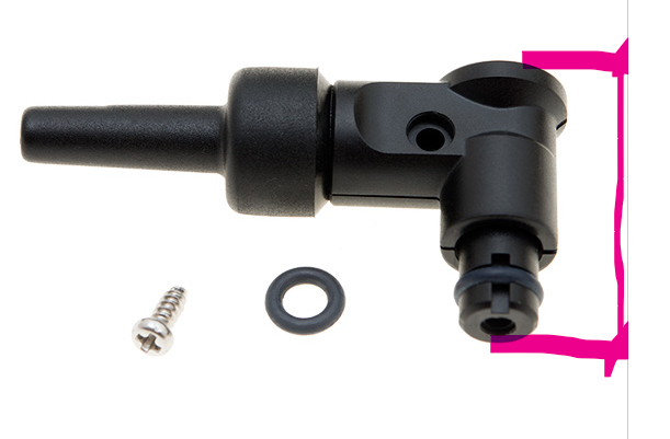

    Do you by chance know what the length of the plug is (see photo below)?  I have the AOI Tentacle housing (for the Oly EPL10) and when using the dome port for the Pana 8mm fisheye I have a hard time connecting the fiber cables.  Most times I have to remove the Vacuum and port to install the fiber plug when I forget to install the plug before pulling vacuum.
  3. Just measured it Dann-Oh:  23.5mm

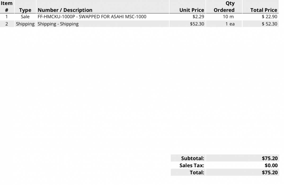

  16. I could get the 217 core 10 meters with shipping to India for $75
    Which I think is a still a good buy
