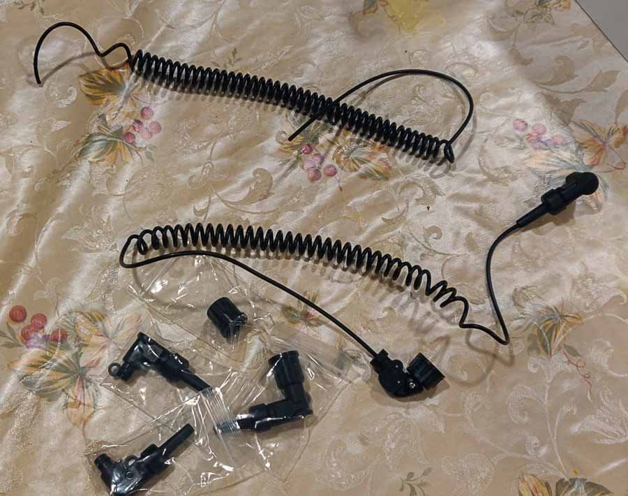

  8. Hi guys would love to join this, but shipping/customs in India is one big major headache, therefore can't.
    Did manage to get 20 meters of cable 10 meters 213 core and 10 meters 19 core. They still charged me duty even on this ! With duty cost of cable and shipping, it cost me about USD 90 in total. of which the cable cost was just USD 21
    Have just made two cables of the 213 core (coiled though) and they work perfectly.
    Rolled the cables on a wooden pencil and kept a rubber band on each side to secure the coils so they don't unravel. Then dipped the pencil in warm water, just getting to boiling point in about two minutes holding the two loose ends of the cable. Kept it in there for about 45 seconds. After that with the cable still in the water, put the entire vessel with the pencil still dipped in, under a cold water tap. Let the water pour till it became the same temperature as the tap water. Be careful that the dry part of the cables don't touch the vessel, cause they will start to melt.
    It worked really well, thanks to all you guys at WP.
    Here is an image of the cables. One with the ends without any connectors and one completed.
    Thanks to Tim, got the connectors from the place suggested by you on this thread,
    Edited by diggy
  9. Nice work, Diggy. They look great!
    Danke Tim...:-)
