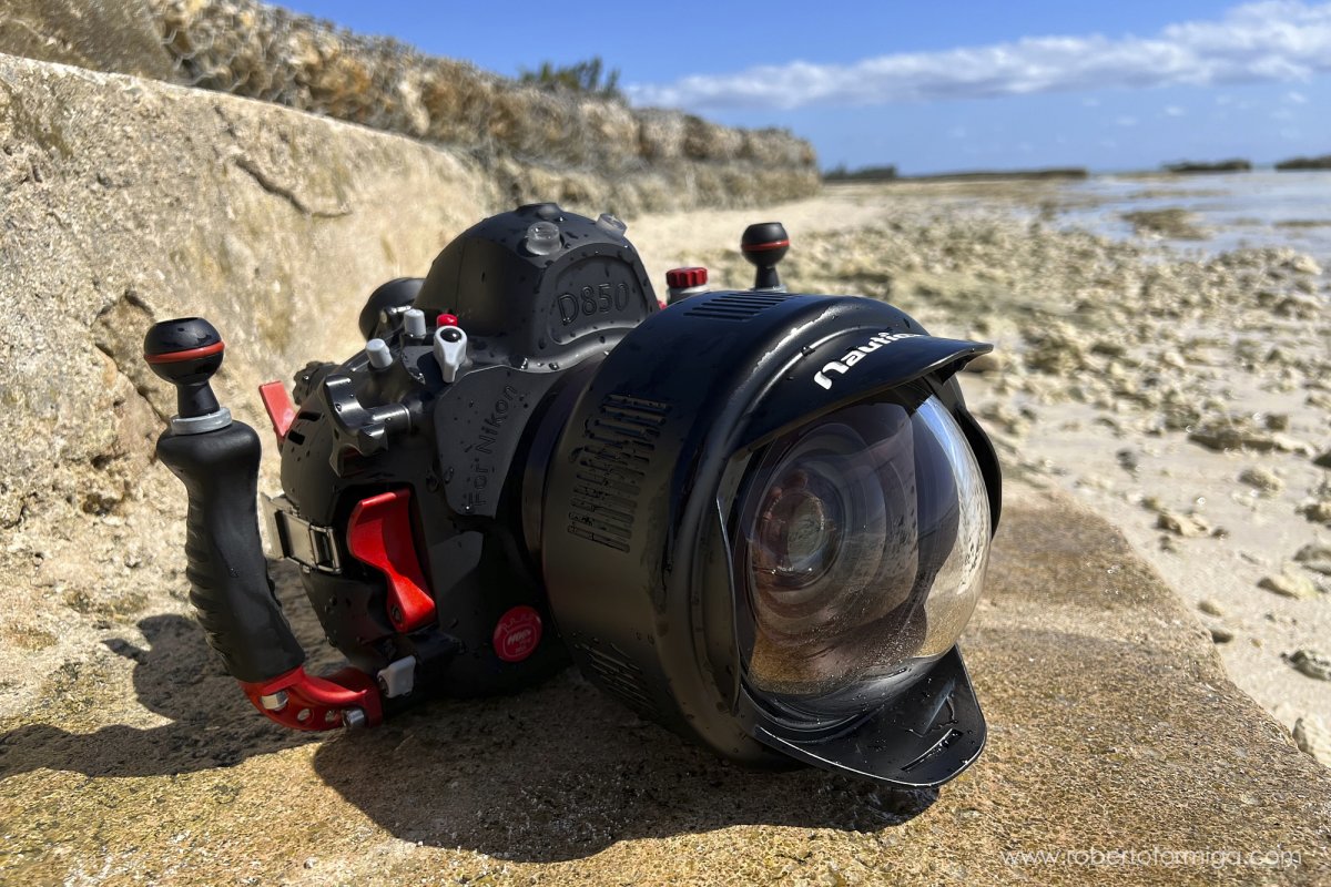

  6. Hi guys! I've just came back from Tiger Beach and had an amazing time photographing exclusively with the WACP-C. I'm using it in a Hugyfot housing with the Saga port adapter, tailored to perfectly match the Nikon 28-70mm F/3.5-4.5.
    I've been able to use the full zoom range. As Edward Lai mentioned on his previous post though (regarding the new port adapter Nauticam is designing), an issue is that zoomed down to 28mm and focused at a subject touching the front element of the WACP, a very slight vignette shows up in the corners. During this trip I've never shot under this circumstances (shooting @28mm I'm photographing as wide as possibile with subjects within a certain distance, not touching the dome) and this issue was never a problem.
    The overall image quality is very good, I'm happy with the sharpness and contrast. To me, the main benefits of this combo in comparison to a dome port solution are:
    1) Flexibility: paired with the 28-70mm the WACP-C gives an enormous zoom range. While that doesn't compensate for an incorrect tecniche (as we all know it "get close to your subject" is paramount in underwater photography) the zoom capabilities allowed me to compose much better zooming in and out as if I was on land. It allowed me to fill the frame with the subject and to keep undesired divers, bubbles or fins out of the corners of the frame.
    2) Transportability: I've packed everything, housing, camera, WACP-C, 180mm dome port, 2 Nikon lenses, 2 Retra strobes and all accessories (batteries, charges, fibers, etc) in a Thinktank backpack. With the 230mm dome that would be impossible.
    3) Less drag: my rig is much more compact now and have less drag underwater hence I'm able to respond and compose faster while shooting, which translates in less lost opportunities specially for fast moving subjects.
    I won't enter the corner sharpness discussion. To my observation on the field (not on a controlled test environment) the results are pretty good. One characteristic of the WACP-C that may be an issue depending on the shot is that it flares while shooting straight at the sun. The flares are not ugly and may also be used creatively.
