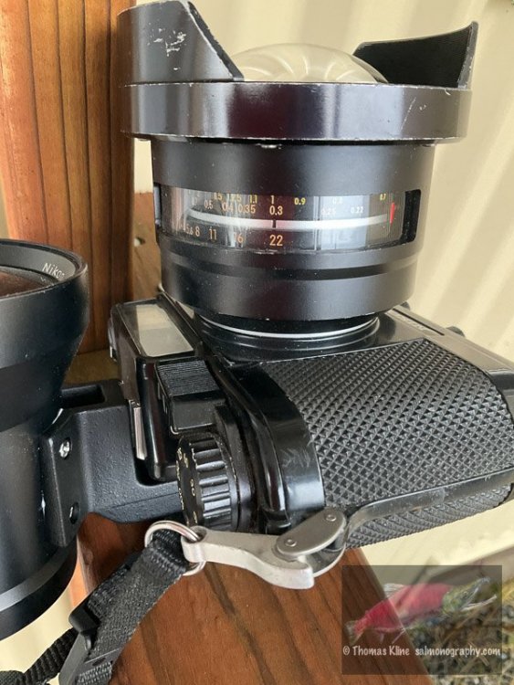

    Are you referring to the Nikonos closeup kit where you had to persuade fishes to swim into the metal frame?
    Yes, indeed, But with some experience and after some practice, you would not need the frame anymore. Just the lens
  2. On 1/24/2023 at 9:57 AM, lambee01 said:
    In addition to the above, i am amazed to see how we could become obsessed at corner sharpness, or Mega pixel resolution, when we still DO NOT have decent options for CFWA as was the CFWA Nikonos kit.... Combining Macro AND Wide angle and not Macro OR Wide Angle.
    Sorry if I'm misunderstanding you, but I don't follow. The Nikonos 15mm has a close focus of around 8" from the front element, which I'm not sure even qualifies as CFWA these days (it's also not as wide as most people want). If you also consider the RS system then the 13mm can focus to around 2" from the front element, which is actually pretty good. However, nowadays we have the Nauticam EMWL (perhaps the best ever CFWA tool), the Nauticam WWL-1 and WACP-C that can focus up to the front element, fisheyes in minidomes that can focus up to the dome, the Laowa 24mm probe, and many others. Plus the Nikonos lenses can still be used on modern digital cameras if you want. So in my view we have much better CFWA options now than back in the Nikonos days.
    Edited by Isaac Szabo
  3. I second what Isaac wrote. Using the N15 for CFWA is leagues behind new tools such as the EMWL. With the N15 lens one had to use as small an aperture as possible such as f/22 and use the depth of field scale to fit the subjects and then "guess aim" the rig at the subject(s). There were  a lot of failures plus the DOF scale assumes only a modest final image size such as the size of a page in a book. Many N15 images would not make the grade with today's pixel peeing. I have a couple of shots attached that show the DOF on the side of the N15 lens (the second or N version that is needed for TTL bodies as well as digital sensors).
    Edited by Tom_Kline

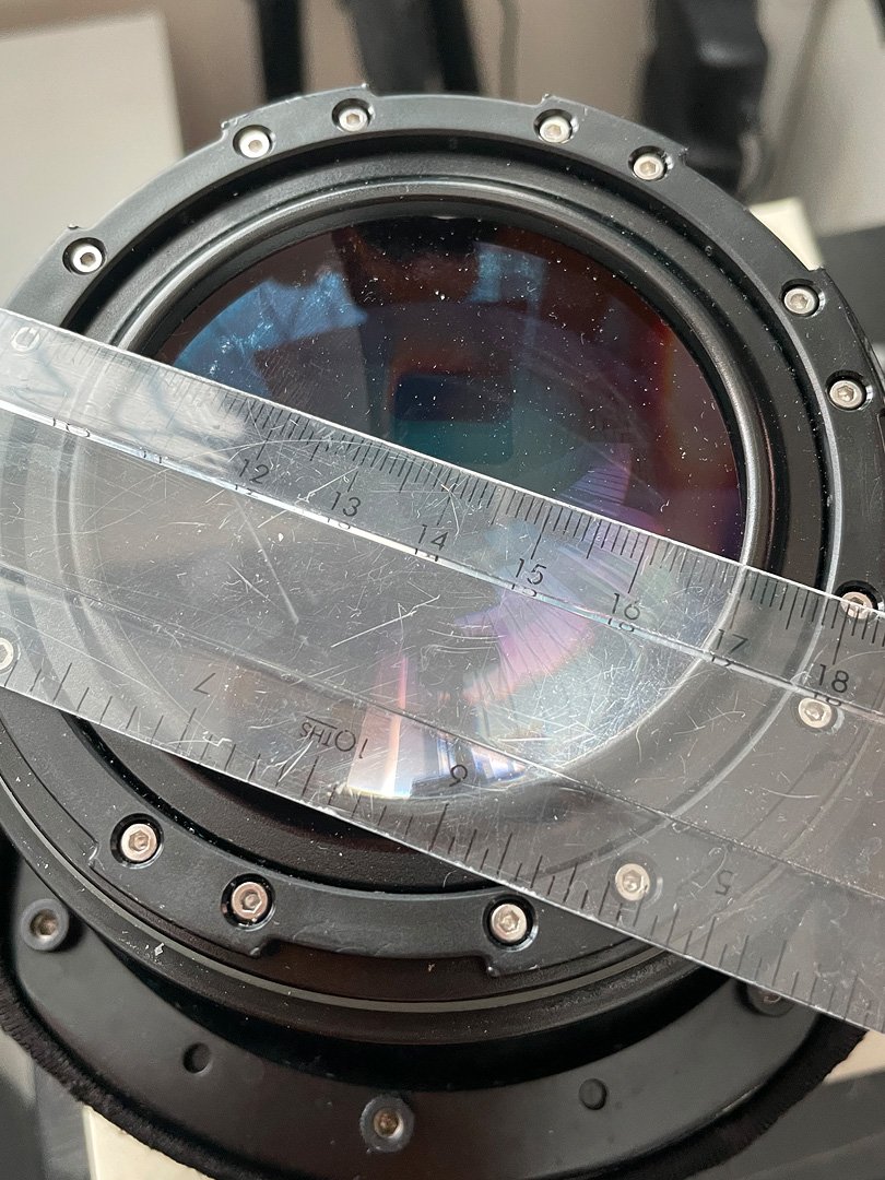

  7. 4 hours ago, Interceptor121 said:
    Thanks for the comparisons. I see that when you weighted the WACP_C you did not include the extension ring while with the WWL-1 you included the port?
    Both the WAPC-C and the WWL-1 are on the pics with the attached port. If you look close at the WAPC-C you can see the extension.
  8. Both the WAPC-C and the WWL-1 are on the pics with the attached port. If you look close at the WAPC-C you can see the extension.
    On the scale there is no extension or it doesn’t show clearly
    And the images are from top so there is a perspective issue to see the size of the glass
    I just took my own WAPC-C an put it on my scale: Without extension and without caps it is 2.265g, with extension it is 2.394g
  11. I just took my own WAPC-C an put it on my scale: Without extension and without caps it is 2.265g, with extension it is 2.394g
    Great!
    As you have one can you tell me the diameter of the glass dome please?
    About 125mm or 5"
